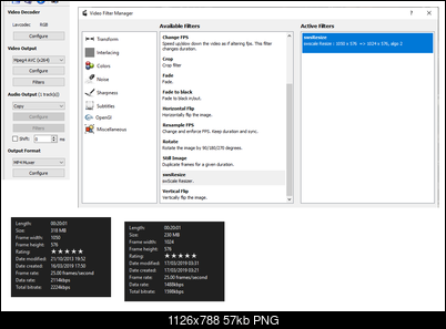

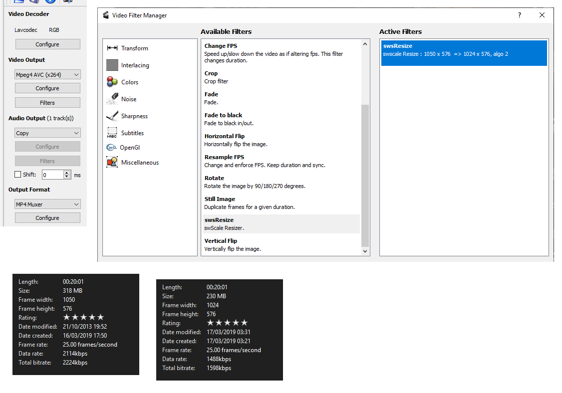

    This worked for playback in VLC, but it hasn't actually changed the resolution.
    I tried using the resize filter and it worked I think.
    The bitrate is lower than the original file. Is there a way to make it lossless? The videos were rendered from Premiere using H.264.

    The reason why only flagging the file was inferred was because you mentioned mp4box, that's what that does..
    To encode the file with better quality and still to have it play back on all devices, set the video output to AVC (x264)
    Hit configure. On the General tab deselect "use advanced config" set preset to medium and profle to main or high
    Set quality to 18 and do a test encode. Adjust as necessary - as the quality number is lowered, the bitrate
    becomes higher

    Thanks, that's worked perfectly.
