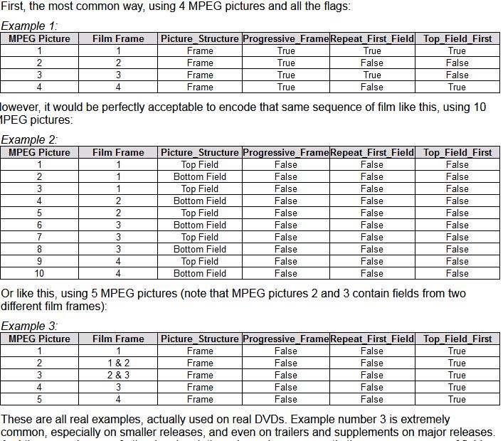

  1. You could always do a comparison yourself. I believe an interlaced stream will require roughly a 50% greater bitrate as compared to a progressive version of the same stream for the same quality.
    For DVD, anyway, I don't believe the fields are encoded separately and then woven back together. It's possible, of course, but rarely used. The Pic_Structure flag defines whether fields or frames are being encoded. The picture below shows the several ways to encode for NTSC DVD. The rarely used 2nd example shows what (I think) you're referring to. It's from here:
    https://hometheaterhifi.com/volume_7_4/dvd-benchmark-part-5-progressive-10-2000.html
  2. Originally Posted by johnmeyer View Post
    Maybe what you are saying is that a diagonal line will have a lot more staircasing for the half-height field, and the encoder must work harder to encode that cleanly. If that is the point, I can see how that might be so.
    Yes.
  3. Originally Posted by jagabo View Post
    Yes, that is correct. Progressive encoding is more efficient than interlaced encoding. So if you can encode part of the frame progressive you get more compression and/or lose less quality loss.
    Thanks jagabo.
