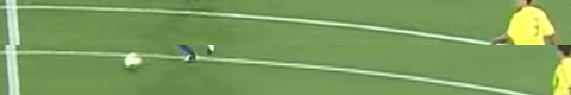

	Here are 4x point enlargements from two frames:
 [Attachment 48475 - Click to enlarge]
 Be sure to view the image full size. At the top, taken from frame 1935, the camera is not moving. Notice how the horizontal line is pretty smooth. Below that is the same section of the field from frame 1977 where the camera is moving. You can see obvious jaggy deinterlacing artifacts. You can see similar artifacts whenever the camera is panning.
	Thanks jagabo. I understand that such artifacts are visible when camera is moving pretty fast because in such cases two fields from the same frame have bigger differences. BTW, what is the most obvious deinterlacing artifact that can be spotted during playback if the video has been deinterlaced in a quality way using QTGMC for example? Are these jaggy artifacts actually the worst ones?

	QTGMC occasionally will leave jaggy artifacts like that, but not often. The most obvious artifacts with QTGMC are with closely spaced, thin, near horizontal lines. Like you might see with horizontal window blinds in the background of an image, or on the walls of a skyscraper in the distance. You will sometimes get moire artifacts. With animated content you sometimes get a little ghosting as an edge or line in a previous or next frame appears in the current frame. This type of artifact is barely visible in real time playback.
