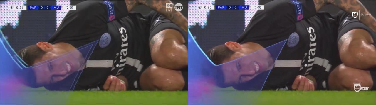

  1. I have a dilemma about a video quality for soccer matches I recently downloaded. I prefer to download videos with constant 60fps, but bitrate is problematic because I'm not sure which mode brings a better quality. Here is the screenshot of the bitrate viewer output for two videos of the first half of the same soccer match.
    On the left side is a CBR video and VBR is on the right side. Which one do you think is of a better quality? I would also like to read a more detailed analysis to be able to make decisions for other videos.

  5. you try to compare two different TV footages basically
    it is presented with offset, CBR is 69.5 frames behind , and it is not accurate because of deinterlacing or diffeent broadcast, there is 2pixel offset vertically
    anyway both have pretty much enough bitrate for what you do,
    do whatever works for you, CBR either wastes or has not enough bitrate, image could have variable quality, VBR tries to be balanced with whatever it has

  6. The differences aren't because one is CBR and the other is VBR. VBR has less small low contrast detail (in the grass for example) probably from a noise reducer or multiple re-encodings. It also has poorer deinterlacing (the original sources was 25i, 50 fields per second, and both were converted to 60p with field blending and deinterlacing). Overall CBR is probably better but I would guess that the VBR video looks better at those big bitrate peaks.

  8. CBR (TNT) easily looks better on this sample, VBR has more blocking, smearing and is less stable.

    By examining the samples and based on experience. You can see deinterlacing artifacts on horizontal edges/lines. And you can see field blending artifacts from a frame rate conversion. Watch the star graphic swipe across the screen about 26 seconds into the video. You can see it in other fast moving areas too.
  15. images CBR vs. VBR, names for these two are swapped! CBR is VBR and VBR is CBR

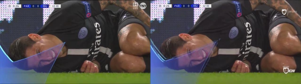

  16. some images

  26. Originally Posted by badyu17 View Post
    Honestly I don't think these videos were converted with simple blending because TV stations today use much better converters with motion interpolation. The motion in these videos is good, not many artifacts from conversion.
    You are right they are using motion interpolation. Motion interpolation works very well with panning shots and simple motions. It doesn't work well with complex or very large motions. So the algorithm they are using resorts to blending when motions aren't simple. So in wide panning shots the panning is smooth but motions within those shots, and in many close up shots, you can see blending artifacts.
    Watch the ball and the feet of the player on the left:
    [Attachment 48426 - Click to enlarge]
    You can also see that the two videos blend at different frames (because they started at different points in the cycle). So the blending wasn't part of the original 25i video.
    CBR on the left, VBR on the right:
    [Attachment 48427 - Click to enlarge]
    And a few frames later:
    [Attachment 48428 - Click to enlarge]
