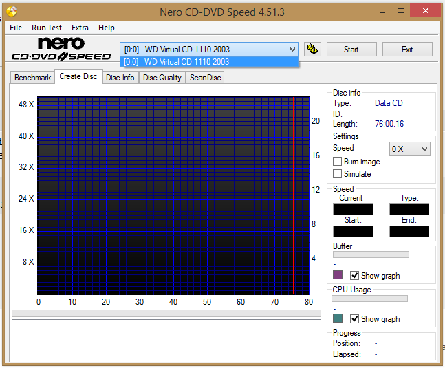

  18. <=SicRIC=>
    Apr 2008
    I downloaded the [ Nero11_DiscSpeed702100.exe ] but it didn't "see" my LG burner (as previously stated) needing a "Lite-On" burner which is not an option for me.
    My computer platform is a Windows 64 8.1 machine.
    catricric
    Mar 2008
    Try this version, remember to put it in XP compatibilty mode
    Is your LG burner USB external, or regular internal sata attatched ?
  20. <=SicRIC=>
    Apr 2008
    Thanks for the file..., I was able to install the file in XP compatibility, but as you can see from my attachment that my 'external' DVD drive was 'not available' from inside of the program. https://forum.videohelp.com/attachment.php?attachmentid=48386&stc=1&d=1552594913

    catricric
    Mar 2008
    Try it on another PC with a regular internal drive
