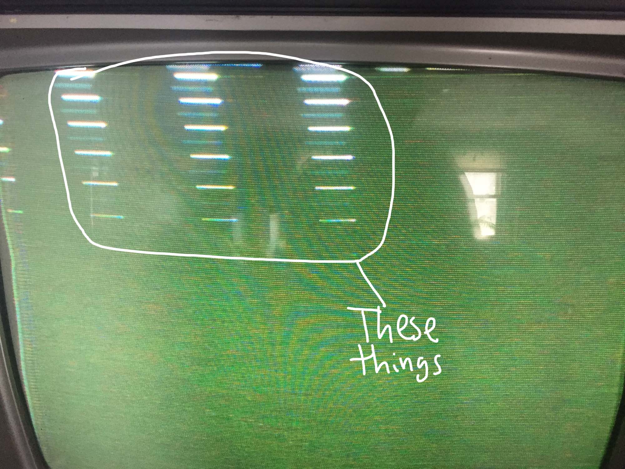

  4. looks like my image link didn' work. trying again
  5. weird. trying another way. maybe you can click on this link? http://angryjim.com/storage/IMG_5953.JPG
    here's another: http://angryjim.com/storage/IMG_5952.JPG
    those lines slowly fade in and out throughout the video.

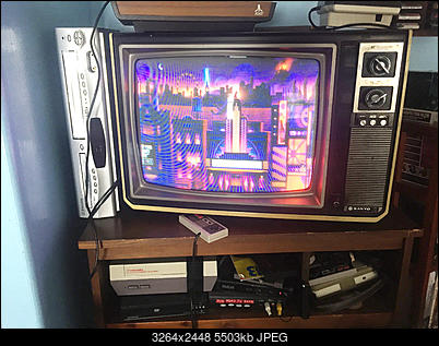

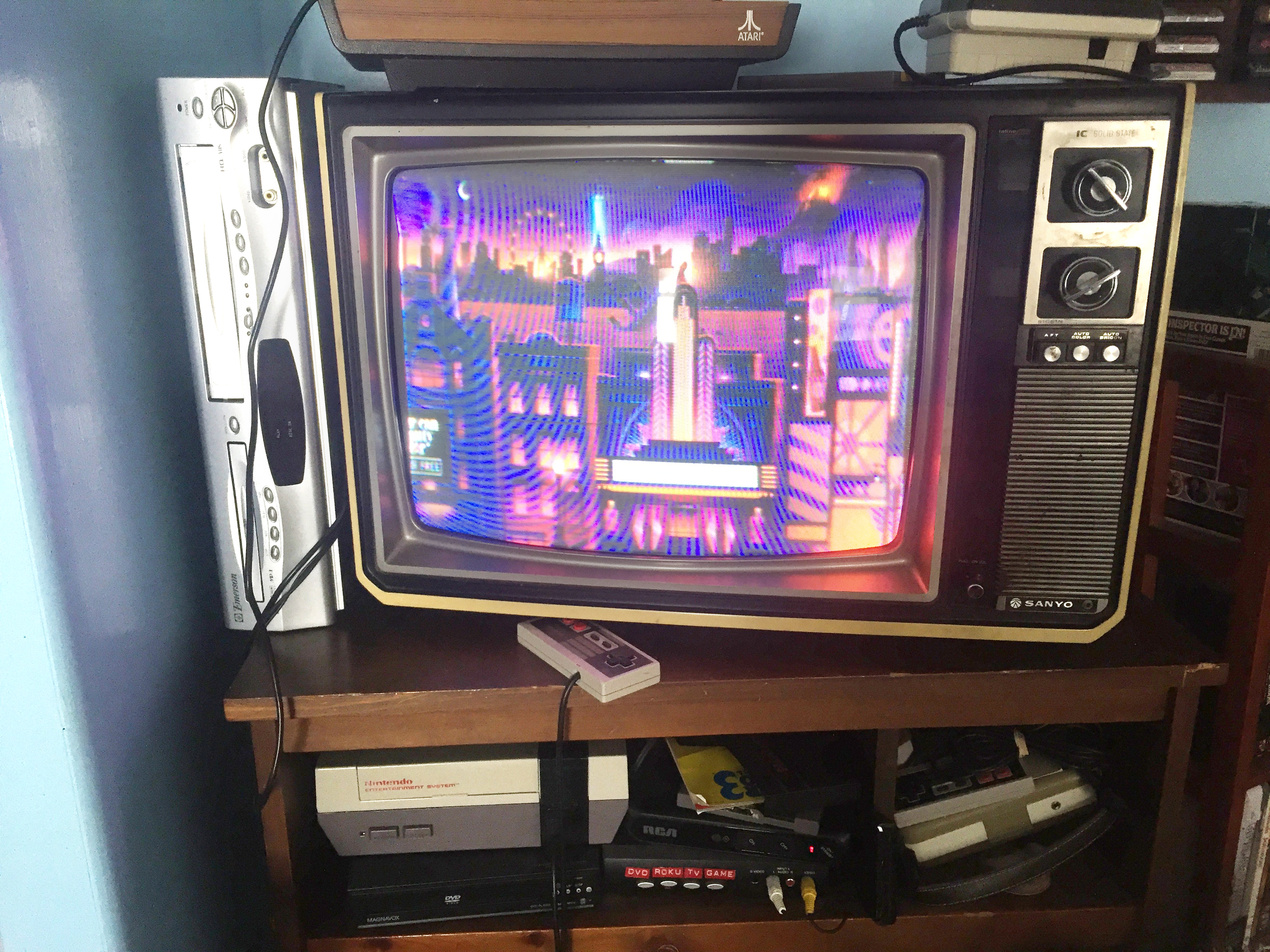

    you can see here what I'm trying to do.. http://angryjim.com/storage/IMG_5955.JPG
    watch a bunch of different media on an old late 70s television. The TV works great. (the photo looks worse than it does in real life) the lines don't show up with the nintendo or even the ROKU i have hooked up to it. only the VHS and DVD... and i think only certain videos.. which makes me think it's a copy protection thing? Because the TV is so old it only has the two screws in the back for an antenna.. Maybe something about the RCA composite to coaxial(vhf antenna really) converter I'm using.. but again, it only happens with the VHS and DVD.

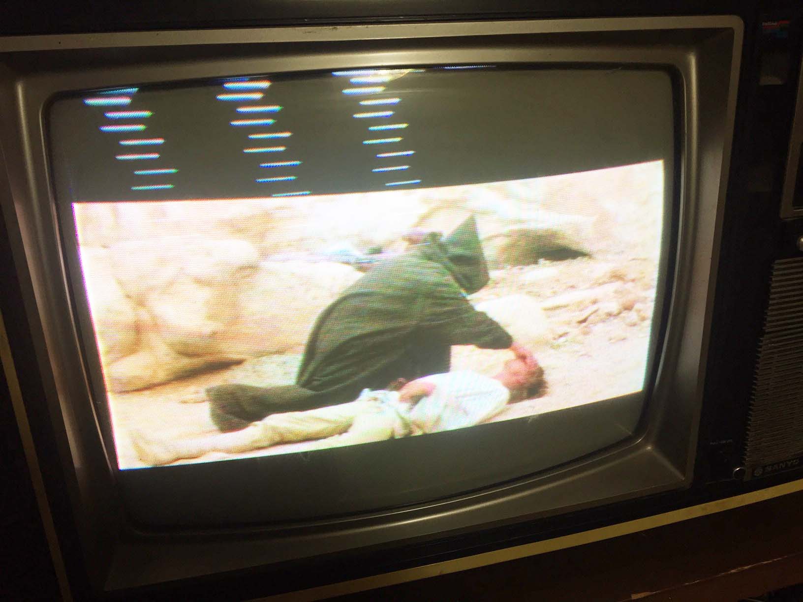

  6. Click image for larger version
    The white bar at the top of the screen is closed captions (and other digital data transmitted with some sources). Your TV needs adjustment to move the picture up a little bit -- so you can't see it. That control isn't usually available to the user. You'll have to remove the cover and find the internal controls (up/down, left/right, width, height). Or throw the TV away and get another.

    looks like more than one problem. the black bar at the top and the weird shrinkage at the sides of the picture are probably the magnet in the crt getting weak. the white lines that go 1/4 down the picture are something else.
  9. yeah the white lines are all I care about. that's what I'm asking about. I get that the TV is aging. it's over 40 years old. But I dont get those white lines from the NES or the ROKU. It must not be from the TV itself. I've seen those white lines on other televisions in the past. that's what I'm trying to get to the bottom of. I feel like it's a really common thing and was surprised I couldn't find info online about it..
  10. These are the lines I'm talking about. They only happen with DVD or VHS playback. And not all videos. that's why my guess is copy protection.. and my question is if there is a way to eliminate them.

  11. Originally Posted by jimmydonc View Post
    [Attachment 48364 - Click to enlarge]
    They should appear only one time at the very top of the screen. I'm not sure why they are repeating on your TV. I suspect the vertical position of the picture is too high and you are getting reflections off the top of the tube. Your TV needs adjustments as noted earlier. Not all videos display the problem because not all videos (and not all sources) include closed captions.

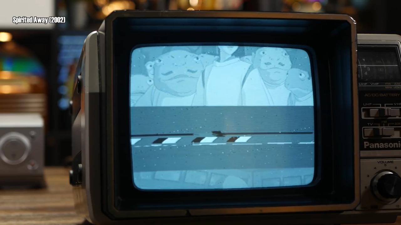

    Thinking about it more, those might be Macrovision. Here's a frame from a youtube video (10:29) that shows Macrovision and CC with a TV that's not properly sync'd (twiddle with the vertical hold knob) so you can see the vertical blanking period between fields:
    https://www.youtube.com/watch?v=-VqsU1VK3mU
    [Attachment 48366 - Click to enlarge]
    The thicker black/white lines are Macrovision, the thin white lines just below them is the digital CC signal. A stabilizer may remove both.
    What you're seeing may be the macrovision signal reflecting off the top edge of the tube. If they slowly brighten and darken (maybe that is why you described them as "fading", see the video) rather than flicker quicky they're macrovison.

  19. well, I opened up the TV and found a peg that turned to control the vertical scale. so that's fixed. No such luck for horizontal but that doesn't bug me. In any case those lines appear even when the data bar at the top is completely cropped out.
    As I said before I'm getting a stabilizer and when that comes, we'll see if that gets rid of the lines... Image
    [Attachment 48371 - Click to enlarge]
