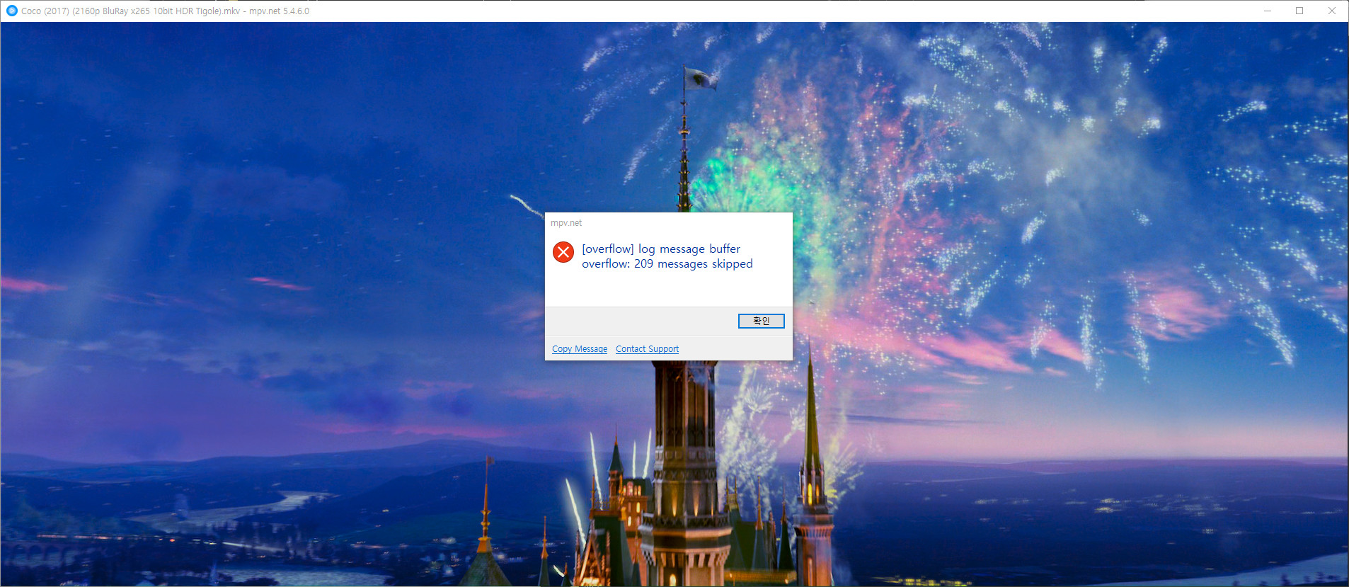

  3. Hello~
    Thank you for good program!
    I upgrade to 5.4.6.0 from 5.4.4.0 today.
    I got an error message from 5.4.6.0.
    The error message is "[overflow] log message buffer overflow: 209 messages skipped"
    [Attachment 53094 - Click to enlarge]
    The error message appears only 5.4.6.0.
    Thank you.

    Does it only sometimes happen or only with certain files? If it's cleanly reproducible then please start mpv.net in a terminal (command prompt) and copy the log messages, in the command prompt you can select all text with ctrl+a, after that right click the text, the right click does copy it to the clipboard. Please post it here.
  5. Hello~
    The error message appears only some files. I have only 2 files.
    I just tried mpv.net in the command line(cmd.exe) but I can not get the log when I run the mpvnet.exe in the cmd.exe.
    So I tried again with mpvnet.com. And I get the log!!!
    But the error message does not reproduce with mpvnet.com. The error message only reproduce with mpvnet.exe.
    Anyway I will attach the log from 2 diffrent version.
    Thank you.

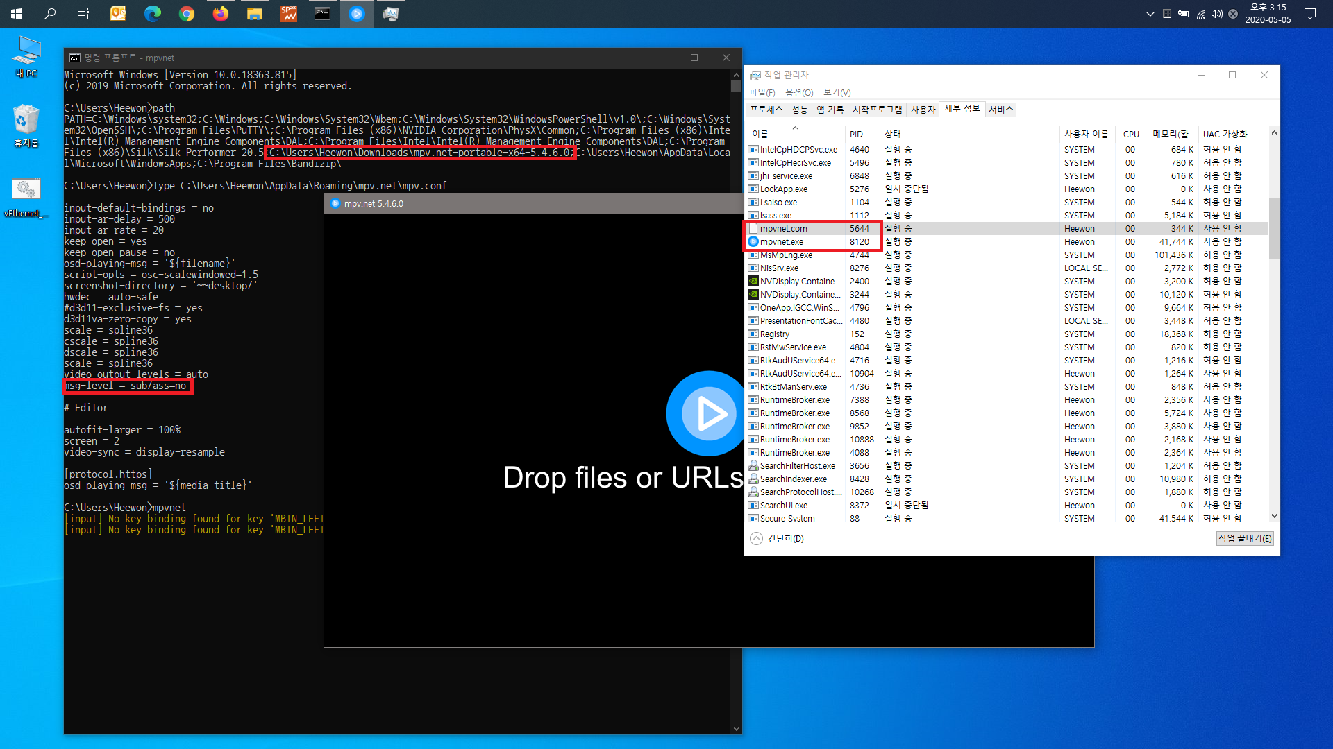

    Thanks for the log, the com extension has a higher priority than the exe extension, if you put the mpv.net folder into the path environment variable and start mpvnet without exe extension in the terminal then the command shell will invoke com instead of exe.
    Such media files are hopefully very rare, it should be fixed in the next build, meanwhile you can try to put following into mpv.conf:
    msg-level = sub/ass=no
  7. Thank you for the guide.
    I test again as your guide but mpvnet.com is invoked. I check with the task manager.
    The error message appears again with mpvnet.exe.
    I attached the screen shot.
    [Attachment 53120 - Click to enlarge]
    And I attached full log again.

    Thanks for the report, should now be fixed:

    With GitHub portable version 58.0.0 things work. However any higher (GitHub portable) version refuses to startup/playback after that video config has been set.
    Any idea?
    cheers
