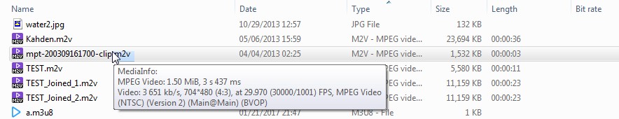

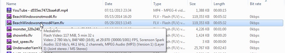

    If you are talking about the folder details listings, Windows uses its own decoding 'codec' to determine file properties. These are often missing or not accurate. Several examples are shown below. Even the same extension file type gives different reading, or lack of readings, when Windows parses this information. Variable bit rate seems to give Windows (at least my Windows 7) a hard time obtaining.
    A better way to get this information, although not in a long list, is MediaInfo which has a mouseover function that can be activated in its options. If this fails to perform, as in an update, just uncheck this function then check again.
