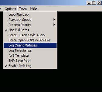

  12. Originally Posted by WWK764 View Post
    Since I have a file with the customer matrix, is there any way to rip it?
    It's a simple matter to get the matrices used. Open a video file in DGIndex. Go Options->Log Quant Matrices. Then File-Save Project. You'll get a D2V project file you can toss unless you want to use AviSynth as your frameserver, and the text file with the matrices inside.
    Of the encoders with which I'm familiar, both CCE and HC Enc allow you to set up custom matrices. I think you can in ffmpeg as well, but I've never used it.
    Both CCE and HC Enc also allow for setting Open or Closed GOP.
