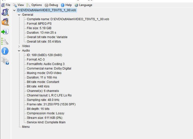

    I've uploaded the MediaInfo details.
