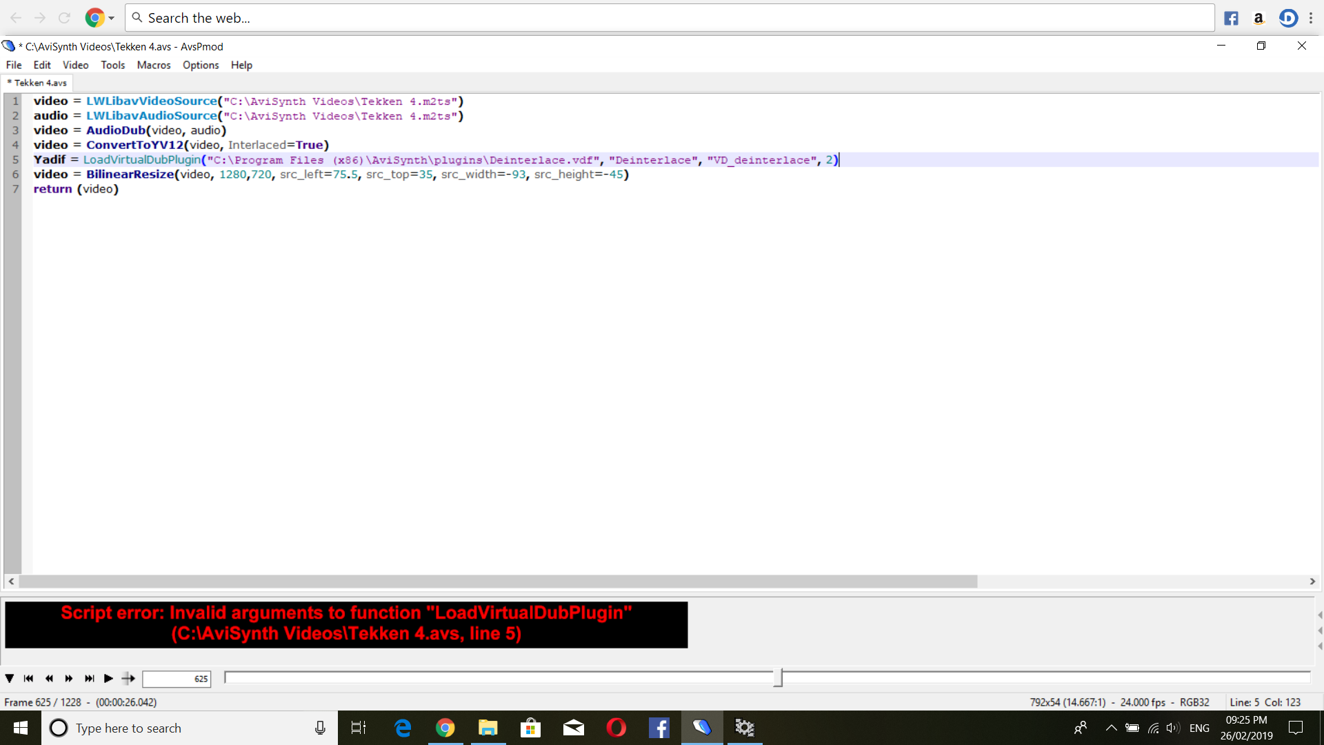

I'm trying to use VirtualDub Deinterlacing filter on AviSynth, but LoadVirtualDubPlugin is really confusing. Can somebody look at my script and tell me what I did wrong? Thanks.
[Attachment 48219 - Click to enlarge]. This is the VD filter I want to apply.
[Attachment 48220 - Click to enlarge]

VirtualDub's intrinsic filters cannot be used in AviSynth, only the external dll filters.
LoadVirtualDubPlugin() does not apply the filter it simply makes it available by the name specified. You have to call the filter by that name somewhere in your script. So your would do something like:
Code:LoadVirtualDubPlugin("x:\path\to\plugin.vdf", "deinterlace_this") # make plugin.vdf available as deinterlace_this() WhateverSource("filename.ext") ConvertToRGB32(interlaced=true) # VirtualDub plugins require RGB32 deinterlace_this() # include any necessary arguments for the filter ConvertToYV12() # or whatever you need for later processing SomeOtherFilters() # -

If I understand correctly, you can use the filter without the colorspace conversions in your script by using VDub2:
http://avisynth.nl/index.php/LoadVirtualDubPlugin#LoadVirtualDubPlugin
But colorspace conversions are to be avoided whenever possible, another reason to use the AviSynth Yadif, if you have to use Yadif. -
