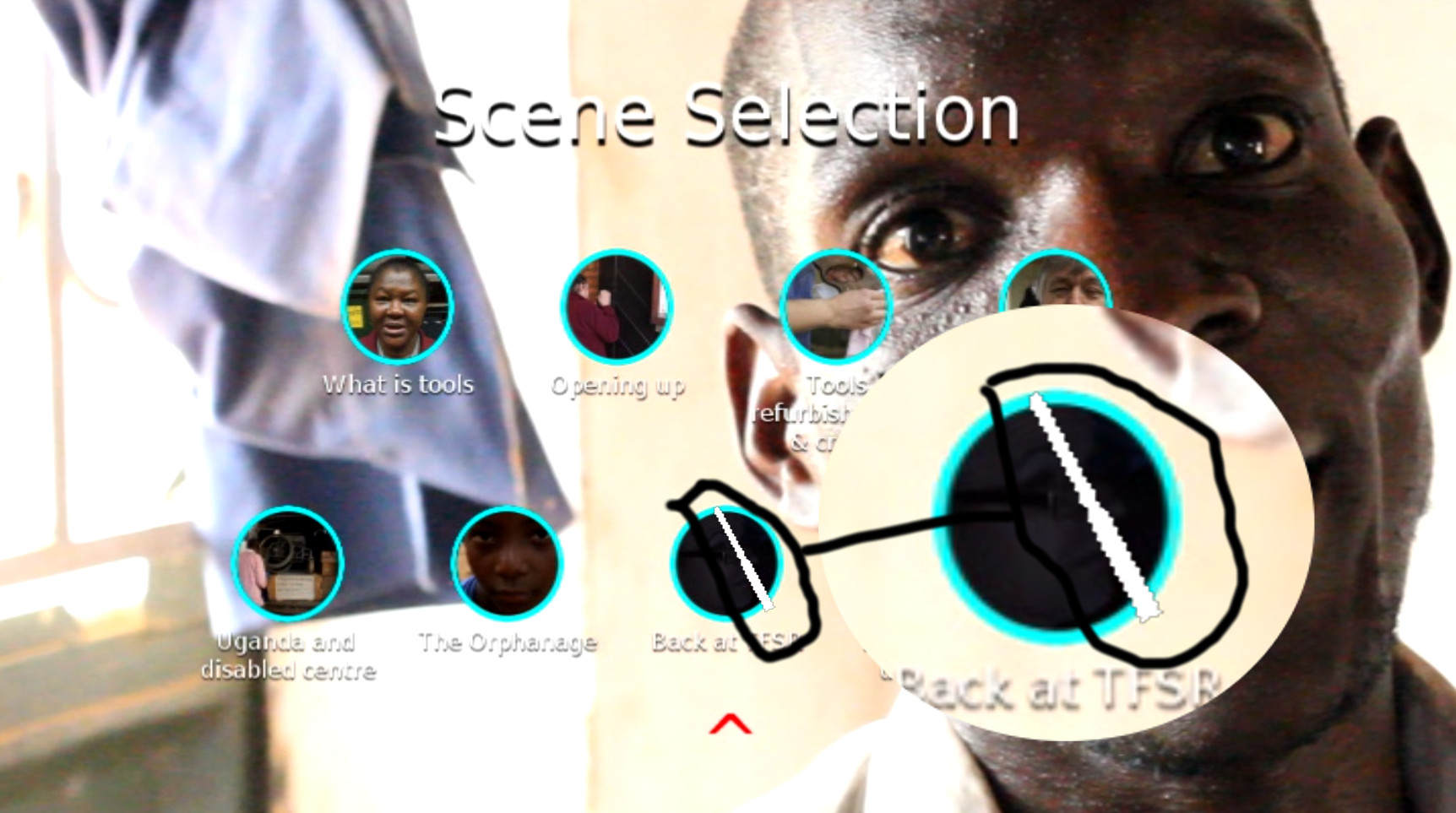

    HI guys, thanks for reading my post. I have a problem.
    I have finished my movie about a charity that works in supplying tools to Africa. and am happy with the menu system. however, my custom highlight over the buttons has extremely jagged edges. Here is an example:
    [Attachment 48215 - Click to enlarge]
    Does anyone know what causes this and how to get the edges smoother? I would love some help!
    Dan.
  2. Member Cornucopia's Avatar
    Looks like you are using a NON-SQUARE highlight.
    DVD subs & menu highlights use 4bit color, so unless you devote a couple of the bits to anti-aliasing, you will of course have aliasing/jaggies with non-rectangular areas.

    Maybe you should clarify.
    Is that enlargement part of the custom menu and how did you create that ?

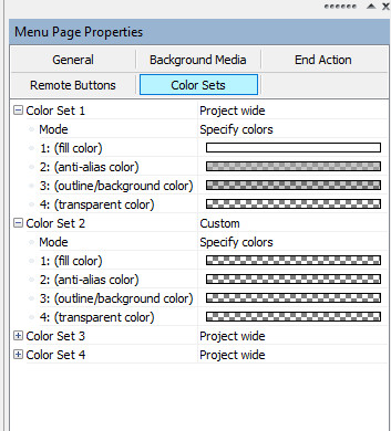

    Choose an antialias color in your highlight color set that is halfway between the fill color and the background.

    DB83 - Indeed, it is part of the custom menu that I have created. You can have custom highlights by making them as a png with a transparent background and then adding them as a mask to the highlight of the button. Be sure choose 'Custom' in the syle selection.
    JVRaines - Here is the color set used for the page:
    [Attachment 48217 - Click to enlarge]
    What should I change to get better results?

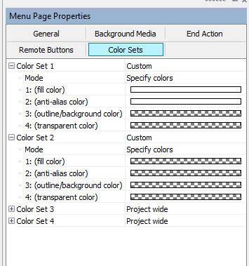

    I have had limited success with this color set, but the problem is still there:
    [Attachment 48218 - Click to enlarge]
    Thanks again, all of you guys!
    Dan.
  6. The best thing you can do is avoid using diagonals. Use only vertical and horizontal lines.
