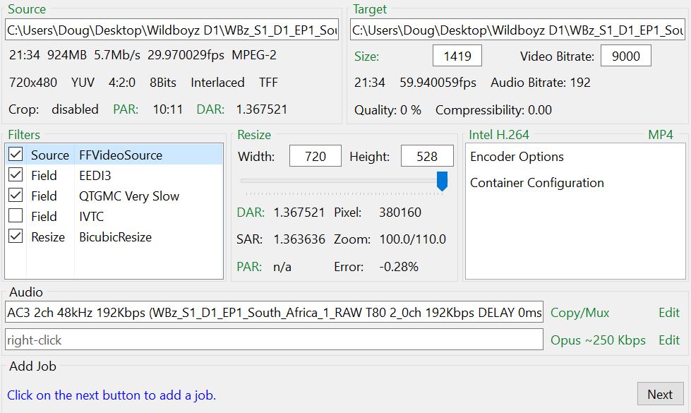

    I've been doing some more reading tonight (so interesting how these edge-based deinterlacers work. The science and maths is mind blowing!) and might give EEDI2 a go tomorrow.
    The source filter given by default for my VOB source (in StaxRip) is FFVideoSource, but there is a range in there I could change to (LSMASHVideoSource, etc). Do you think the Filter>Source>FFVideoSource might be causing this problem in conjunction with EEDI3? (meaning maybe EEDI3 isn't the problem that needs fixing, but with EEDI3 being used the source filter needs to be set to something else?).
    Here is a quick preview of the script i'd love to be able to use =
    FFVideoSource("C:\Users\Doug\Desktop\Wildboyz D1\WBz_S1_D1_EP1_South_Africa_1_RAW.VOB", colorspace = "YV12", \
                  cachefile = "C:\Users\Doug\Desktop\Wildboyz D1\WBz_S1_D1_EP1_S..._temp\WBz_S1_D1_EP1_South_Africa_1_RAW.ffindex")
    EEDI3(field=1)
    QTGMC(inputtype=1, sharpness=0.2, preset="very slow", NoiseProcess=2, NoiseRestore=1.0)
    BicubicResize(720, 528, 0, 0.5)
    [Attachment 48289 - Click to enlarge]
    Hope to gain some more knowledge tomorrow, but gee i'm getting tired. I might need to pace myself a bit better after these past 2 weeks. Thank you, jagabo. Fingers crossed!
    Edit = don't mind the fps in that screenshot - I just made it a moment ago using a project I had prepared for tomorrow morning where I was going to try EEDI3(field=3) which would double the fps x2 (59.94fps) using TFF.... probably won't do that, but might give EEDI2 a go, just to see what happens.

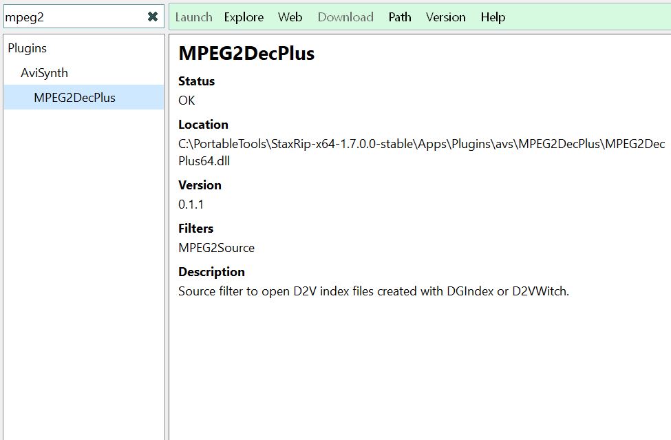

    For VOB and MPG sources always use DgIndex to build an index file and Mpeg2Source("filename.d2v") to read the video via that index. This is almost certainly the source of your A/V sync problem.
    http://rationalqm.us/dgmpgdec/dgmpgdec.html

    do you recommend that I replace FFVideoSource with Mpeg2Source?
    Of course. A sample source line might go:
    MPEG2Source("Movie.d2v")
    You will have already made the D2V file and you also need the DGDecode.dll. If StaxRip doesn't allow for that, then edit the script it makes. Be sure to read the information included in the DGMPGDec package as it's the best source for teaching you how to work with DVDs.

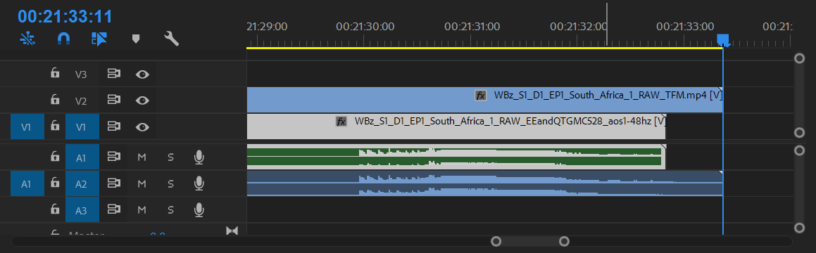

    When I imported these two tracks into Premiere Pro, there was a clear visual difference (as seen in the screenshot from post #33) between the video tracks. The audio waveformation also aligned between the two tracks (the shorter track was just CUT to fit the video track ending where it ends, it seems). But the video track according to the Premiere timeline, was 15or16 frames short compared to the normal in-sync track, which I guess explains why the audio became out-of-sync as the video went along (as the video track must be squished, or played faster than the audio track).
    But you're right, and I love where you are going in your post. I will read further and dig much deeper into the things you write about in your response, a little later this evening. For now, I had a read through one of the log files (in the temp folder) for one of these out-of-sync encodes (EEDI3 & QTGMC), and here are the frame counts =

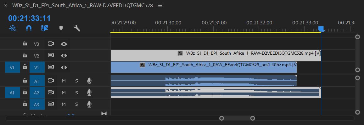

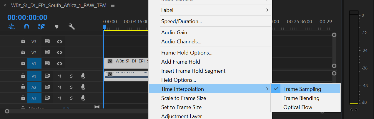

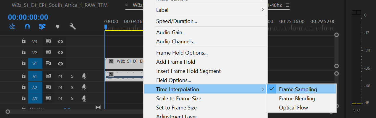

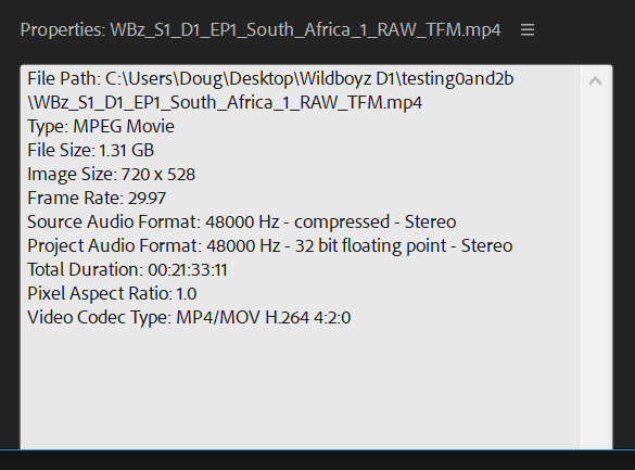

    To answer your first question - VLC media player is the only player I really use. I don't use WindowsMediaPlayer (it won't handle these MP4's), and very rarely open QuickTime player (only for MOV's on occasion - but also won't handle these MP4's either). The TFM (and other encodes with QTGMC, IVTC with decimate, and QTGMC inputtype1) all play in-sync with VLC. So does the source VOB. But ANY encode that involves EEDI3 produces a file that won't play in-sync (the video track being the problem, not the audio track). I could try MPCHC, but I think it's 100% the file, not the player in this case.

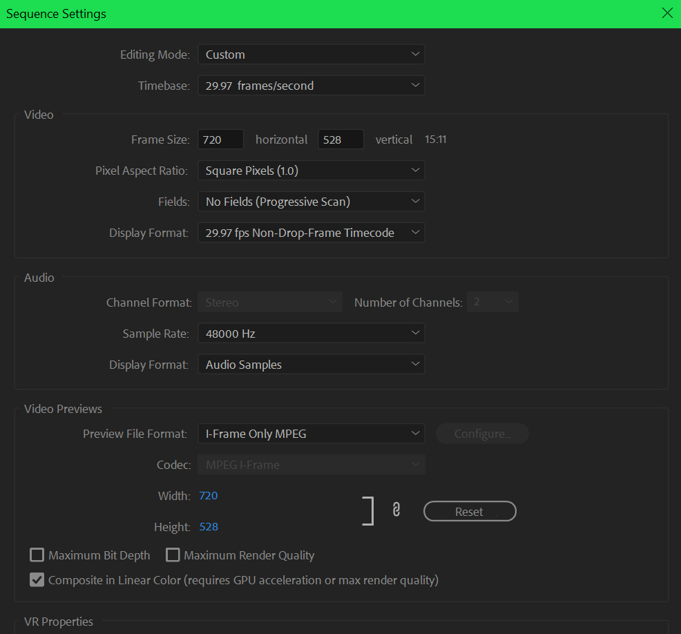

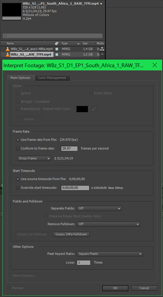

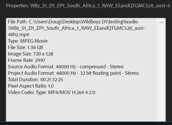

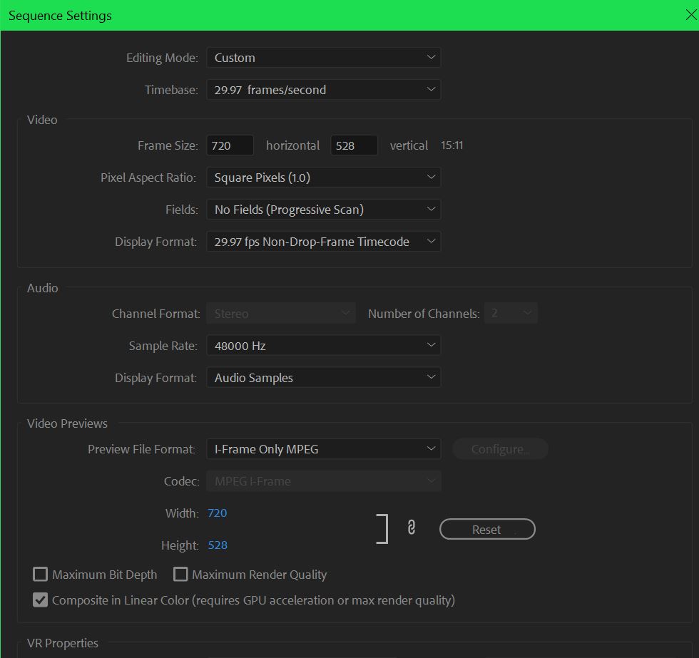

    Here are some screenshots of the information, for how Premiere Pro interprets the two files... starting with the TFM MP4 =
    [Attachment 48300 - Click to enlarge]
    [Attachment 48301 - Click to enlarge]
    [Attachment 48302 - Click to enlarge]

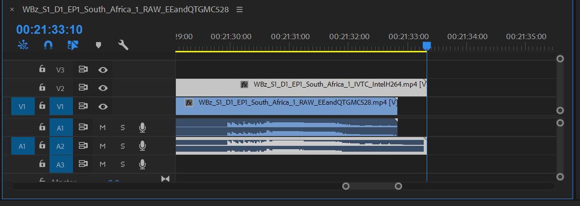

    Then the EEDI3withQTGMC MP4 =
    [Attachment 48303 - Click to enlarge]
    [Attachment 48304 - Click to enlarge]
    [Attachment 48305 - Click to enlarge]
    And then both files in a sequence together - the problem file being in the middle (middle 2 bars - outer 2 bars being the TFM tracks - note the waveform is in-line for both files, but the shorter video causes the end of the audio track to be cut) =
    [Attachment 48306 - Click to enlarge]

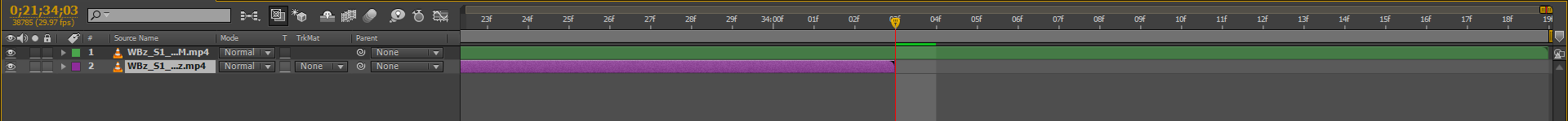

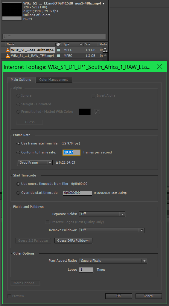

    And then in After Effects - starting with the TFM =
    [Attachment 48307 - Click to enlarge]
    Then the EEDI3withQTGMC =
    [Attachment 48308 - Click to enlarge]
    And then both together in a comp - you can see that it is 15 or 16 frames short (green on top is TFM - purple on bottom is EEDI3withQTGMC) =
    [Attachment 48309 - Click to enlarge]
    For that version of the encode input matches output framecount - but does that 38785 match the other 29.97 TFM version which is in sync? Do all versions in sync at 29.97 have 38785 frames ?
    My first encode simply with QTGMC (no progressive codes aka inputtype=1, in that one...) which X2'd the FPS to 59.94fps had a total frame count of 77602 and was IN SYNC - duration of 00:21:34.660 (00:21:34;38... notice that last semicolon... almost thought that was a normal colon).
    One of my other encodes with the above QTGMC plus IVTC after (TFMwithDecimate - I know, silly to do after QTGMC, but was an experiment) had a framerate of 47.952 (48000/1001) and a total frame count of 62081 and was IN SYNC - duration of 00:21:34.655 (00:21:34;45).
    Another encode with the above IVTC (TFMwithDecimate) but no QTGMC, had a framerate of 23.976fps and a total frame count of 31040, and was IN SYNC - duration of 00:21:34.655 (00:21:34;22).
    The EEDI3 file has a duration of 00:21:34.125 (00:21:34;03) - and all the other one's have something almost exactly 00:21:34.660 (00:21:34;19) like the source.
    Tonight or tomorrow when I have time, I will play with the Source Filter, to see if that will affect the amount of total frames in the end file.... My brain is all over the place right now, but i'm also just thinking how EEDI3 might affect that shorter duration (aka loss of frames). QTGMC hasn't affected the sync or total frames in combo with that - but EEDI3 has. Maybe EEDI3 and that Source Filter (with no D2V reference) is causing the loss of frames. I suppose I just need to experiment more and read into fpsden/num or assumefps or something along those lines to force the fps and force the duration (or something like that, somewhere in the script at some point). Fingers crossed we're getting somewhere!
    Edit = After reading my post and my previous post (comparing some numbers) - you can see that StaxRip or AviSynth or the Source Filter thinks that the Source Frame Count is : 38785 (in the EEDI3withQTGMC script referring to the VOB as the source) when IT ISN'T!!!! Why isn't it seeing the source VOB frame count as being 38801? Very interesting, indeed.

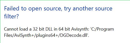

    DGDecode.dll doesn't seem to be 64bit, and I couldn't find a 64bit version anywhere (one in here still showed as being 32bit), so now i'm looking to find either an x86/32bit StaxRip and/or 32bit/x86 AviSynth just to make that DGDecode.dll work for the source filter (MPEG2Source).
    [Attachment 48310 - Click to enlarge]
    Hope I find a balance here that's compatible....
    Edit = I imported a D2V into StaxRip and for the Source Filter 'MPEG2Source' a plugin called MPEG2DecPlus64.dll was loaded =
    [Attachment 48311 - Click to enlarge]
    Is that as trusted and as reliable as the 32bit DGDecode.dll? I will give it a go in the morning!
    P.s. I managed to get StaxRip_1.2.2.0_x86-32bit - and might see if I can do everything i've been doing in the 64bit version (with EEDI3 & QTGMC) but in this 32bit version with DGDecode - after I try this MPEG2DecPlus64.dll (if it doesn't produce an in-sync result).
    Aug 2017
    That doesn't work too well and is not official. I'd suggest taking MPEG2DecPlus out of the 64-bit StaxRip and using that. It's a fork of some kind from DGDecode and works great.
    Feb 2019
    Australia
    G'day! Thank you - that is the one I tried last night which gave the same 32bit error as the actual 32bit dgdecode.dll produced (maybe it is 64bit, but just not working so well with StaxRip? That's alright anyhow). Am now just about to start an encode using MPEG2DecPlus with the D2V file. Fingers crossed, and hopefully have something to share in the next few hours.
    Feb 2019
    Australia
    I have fantastic news to report, everyone! MPEG2Source as the source filter referring to the D2V (using MPEG2DecPlus) instead of FFVideoSource which StaxRip selected by default for the VOB - has resulted with an IN SYNC file!!!! It just finished, and I skipped to the end (like I normally do) and it wasn't out of sync, like the previous renders. I'm over the moon right now. When I have a proper moment to sit down at length, I will go through the whole file, and also analyze the file for the duration+frame count, just to see if everything IS all good. Thank you so much everyone! Will edit this post later with those details .

    How cool is that!?! I'm so pleased with it. Every piece of information above matches the source exactly. I even went ahead and compared this new render (that is fantastically in-sync) to the old render (that was not-in-sync) in Premiere, and was happy to see this =
    [Attachment 48316 - Click to enlarge]
    For now, I am keeping my fingers crossed that we have finally found a process that I can use, that continues to give this great result, as I go forward with all of the other episodes. I hope I don't need to ask for more help, but if I do, I know where to come for the greatest assistance i've received thus far anywhere on the internet. Thank you so much!
