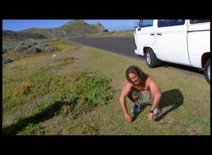

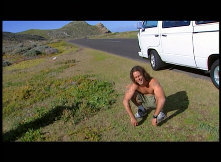

    I'm very new here, and also pretty new to the world of deinterlacing. For a couple of years now, I have been trying to correctly deinterlace some DVD footage that has been the most difficult thing to figure out ever, out of all of my DVDs. When I first started, I used Wondershare software to simply cut each clip I wanted to extract, and it would deinterlace automatically, BUT would make the video laggy (repeated frames). Then a while later, I came back to the project, and found out how to stream VLC deinterlaced footage (using VLC's range of different deinterlace options) to file. Which gave much better results! BUT far from perfect. I've always wondered if there was maybe a combo of Telecine & Interlace happening..... but after recent tests, I think it is just Interlace that I need to find out how to deinterlace properly. So recently, after such a long time not playing with it (because it is so frustrating), I found a deinterlacer called QTGMC. Looks very complicated, but I found that StaxRip has this plugin built into its GUI. So yesterday I got back into trying to deinterlace my DVD footage. Just a moment though - for your information - the DVD I used originally a couple of years ago was a PAL DVD. I bought a collection of the same series but in NTSC last year, and did a side-by-side comparison to see which had a better image quality (pre-deinterlace and post-deinterlace), and the NTSC did indeed look better overall, even with a few less pixels (being NTSC). The NTSC version also gave me slightly better results when using that VLC deinterlace trick - but still problematic as it either gave me lag on some options, or remaining interlace/telecine lines on other options. So I gave up for a while. Anyway, back to yesterdays QTGMC! QTGMC via StaxRip has given me the BEST result yet, and i'm very happy about that (as I remember having really poor quality using handbrake a year ago or so, as a test, as I wanted to see how other deinterlacers worked).
    Problem number one I have with everything that I would really appreciate help with is figuring out the pixel aspect ratio of the original clip, so that my rendered clip, doesn't change to a different size (my renderings squash slightly, and I can't figure out what the correct setting is - pixel aspect ratio?). THe resolution from Original clip to rendered/encoded clip are the same 720x480, but squash downward on output. Problem number two I have and need help with majorly, is getting QTGMC to deinterlace correctly. It gives me an amazing result - zero lag and no interlacing lines in areas of motion, which is thte best i've seen yet! Fantastic. However, on objects, and solid lines, like a telegraph pole electricity wire, or cats whisker for example, will not appear as a straight line, but as a zigzag. The clip I will attach here, will show exactly what I mean. If you use QTGMC on the attached clip (extracted from NTSC VOB's using DGIndex), it will remove the interlacing (and also double the frame rate to 59fps/60fps), but in the result, you can see the bottom of the van is jagged, and not a clean straight line (moire? or incorrect deinterlace?). Something isn't working right.
    Please try to help me with this, as it has been driving me nuts these past couple of years. Still can't achieve a 100% deinterlace for this footage. Will appreciate any QTGMC sample codes (which can be added in via the StaxRip filters options -for Field>QTGMC). I reckon i'm doing something wrong, and would absolutely love it if I could learn how to do this properly, after all these years. Any help as to fixing this problem, I will greatly appreciate! Thank you!
    Kind Regards From Guy!
  2. Too much information. Yes, you want to provide everything necessary to those willing to help, but that was way too wordy. Also, it's a very poor sample. Please provide one with steady movement, not just some guy squatting and moving his arm a little bit. Yes, you wanted to show the aliasing. Actually,I think the content is progressive 29.97fps, meaning you don't need to bob it with QTGMC.
    The reason for the aliasing, like along the side of the van, is because there's not enough resolution to resolve fine lines. It has nothing to do with interlacing. It's just a crap DVD. It's a widescreen source that should have been encoded as 16:9, not 4:3. All that black above and below should have been filled with picture.
    You might want to try out an anti-aliasing filter.

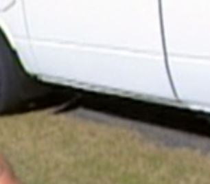

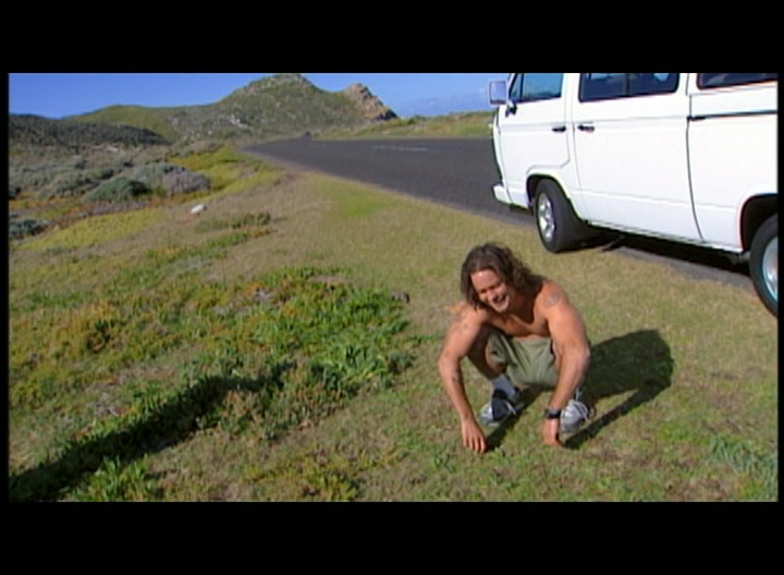

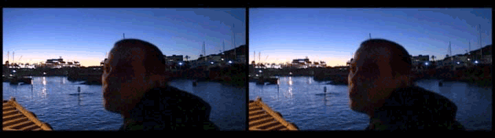

    Thank you so much for such a quick reply, Manono! Very new here, please allow me time to adjust to how this place works. I want to learn how to do this properly, once and for all. I uploaded that clip because it is the one area of footage that I could quickly share, that shows an area of problem. If that source clip (attached above) is deinterlaced using QTGMC (the best I could find thus far), it leaves the following ugliness which I would love to figure out why it exists exactly and how to fix it =
    [Attachment 48168 - Click to enlarge]
    Is the QTGMC Progressive Input Mode something that would mean that I use QTGMC to deinterlace the source footage, and THEN use QTGMC again but on the 'deinterlaced' footage? (so, a second pass of QTGMC? In this order = Source>QTGMC = DeinterlacedFootage..... then DeinterlacedFootage>QTGMC with ProgInputMode code added = Deinterlaced fixed footage?).

    The file you provided is not truly interlaced. The jaggies are baked into the image. It is at 10:11 pixel aspect, typical for 720 × 480 sampling of a 4:3 frame.
  5. Originally Posted by hickeyguy View Post
    Yes, I edited. I tried out QTGMC's Progressive Input Modes and they didn't seem to help much. So I edited to point you to other anti-aliasing filters. I didn't try any of them. Anti-aliasing might also degrade the rest of the video.
    As JVRaines also said, it doesn't seem to be interlaced at all. The 'jaggies' are part of the picture for reasons I already explained.

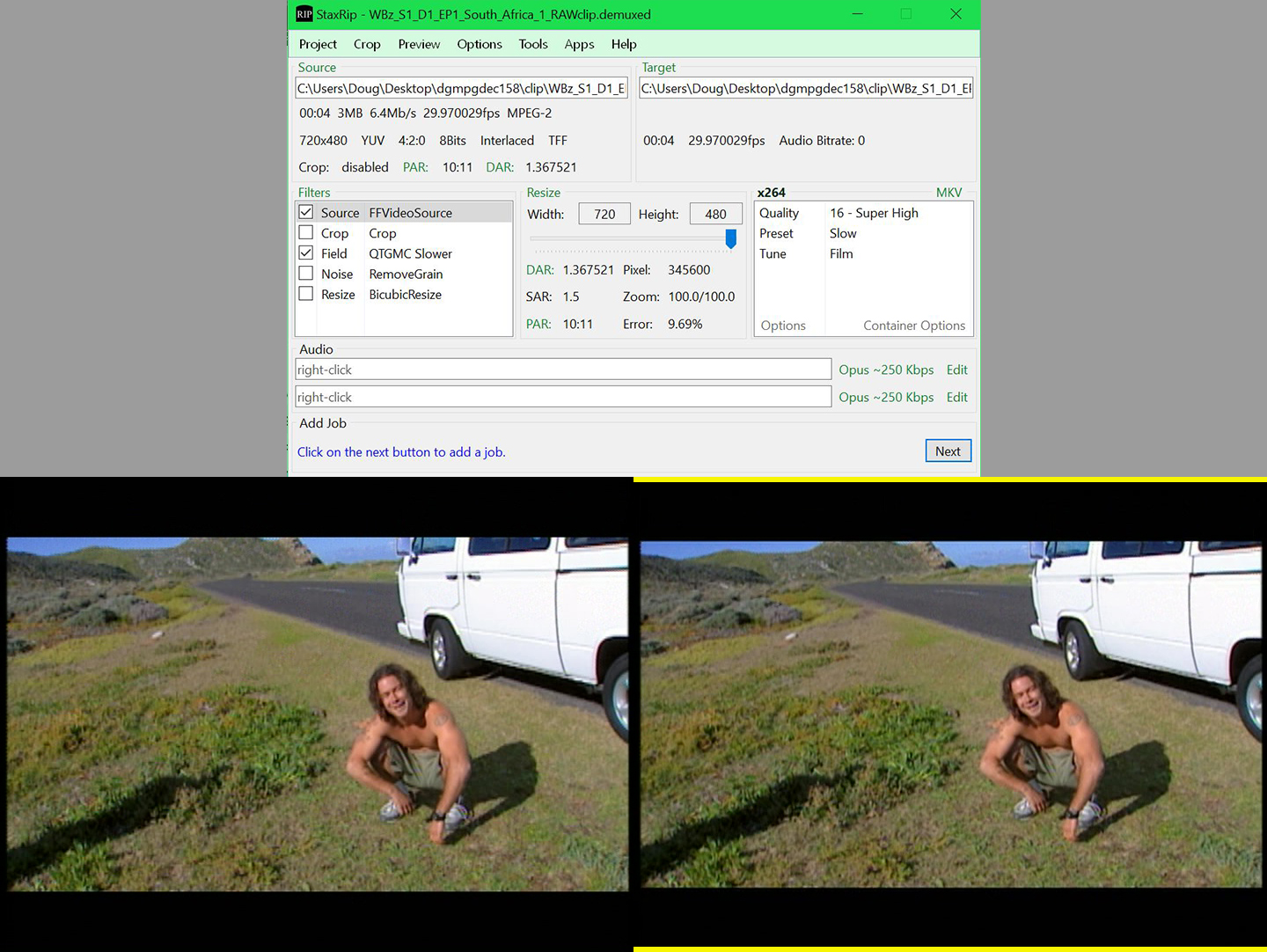

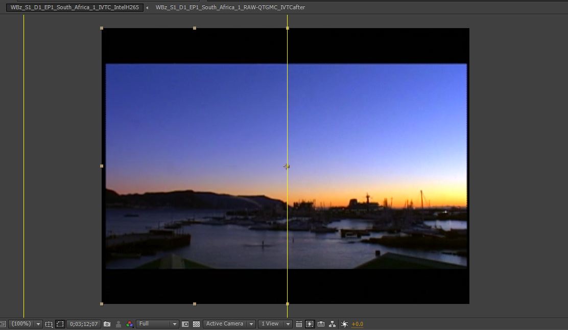

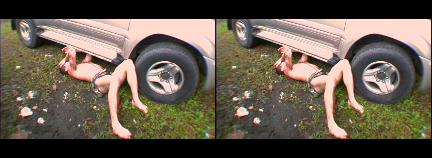

    G'day JVRaines! Thank you for your quick reply as well. I find it very interesting that the jaggies might be there, baked or pre-interlacing from the people who made the DVD's (meaning that they will always be there on both PAL & NTSC sourced DVD's). Does this then mean that the following lines (in the following screenshot/vlcsnap) are possibly telecine lines? (screenshot from a different area of video containing lots of motion, compared/opposed to the van clip from above, which doesn't really contain any motion for the interlacing to appear... just those annoying jaggies or antialiasing?) =
    [Attachment 48169 - Click to enlarge]
    And thank you for your observance on the pixel aspect ratio. I'm confused as to why StaxRip squashes my output, when PAR, DAR & Resolution are all the same (maybe the SAR number is ruining it for me?)... here is an example of what I mean (yellow being where the squash occurs) =
    [Attachment 48170 - Click to enlarge]
    Would love an example process (step by step) from someone that is able to properly deinterlace or detelecine or fix this problem i'm having. Happy to provide more DGIndex clips from the source NTSC VOB's. Please do let me know.
    Thank you!

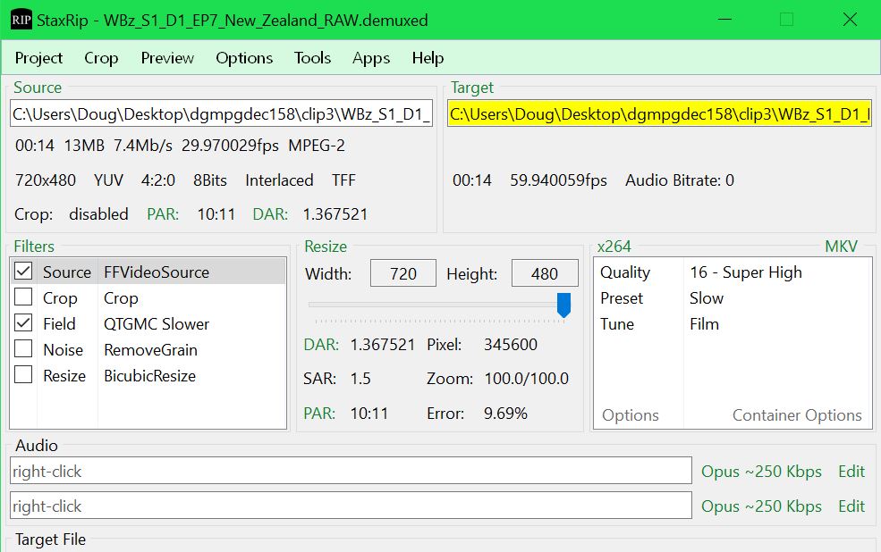

    Here is a second clip extracted with DGIndex, which shows both the interlacing (or telecine?) and the jagged/anti-aliasing attached as filename [1a-Source.m2v].
    I have also attached [1b-QTGMC.mkv] which StaxRip has produced. From what I am assuming, it has deinterlaced with QTGMC wonderfully with no resulting lag (repeat frames) or any remaining combing of which I have received from other deinterlacing methods in the past (using Wondershare software, Handbrake, and VLC's built-in stream-to-file options). The only problem I see (a part from the doubled framerate and slight squash), is with those ugly jagged lines on the truck, which if you are right 'is baked into the original video to begin with'. Here is a screenshot of my StaxRip job settings =
    [Attachment 48176 - Click to enlarge]
    I would like to know why my output is squashed slightly - as DAR, PAR & Resolution are the same. SAR isn't editable, from what I can see... is that the problem? (regarding the squash?). The only other thing i'd like to figure out is how to fix those jagged lines... there has to be a fix for that, even if it is in the prior progressive master (pre-interlaced-DVD).
    Thank you, all, for your time! Looking forward to seeing how we go with this. If there's anything I might be able to do to contribute in return, for your great help, i'd love to know. Much appreciated!

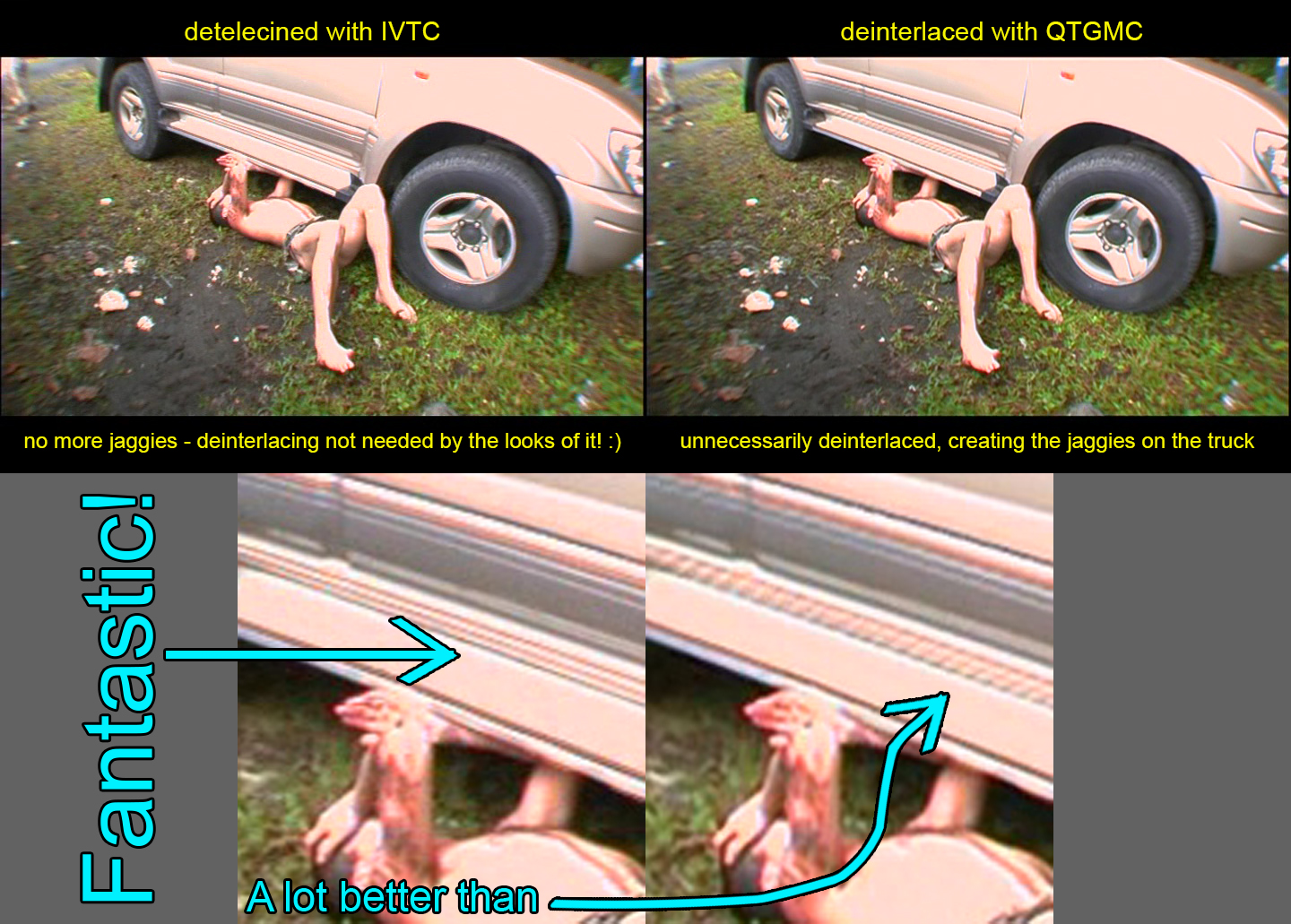

    Thank you, Manono! I went ahead and turned off QTGMC in StaxRip, and just applied a 'simple IVTC', and it yielded a much better result!!! I have to explore it more, to see if I get any combing elsewhere (like in any of the motion graphics - a problem I has having late last year using VLC's IVTC stream output), but I am liking where it's all going. Have a look at this comparison I put together =
    [Attachment 48177 - Click to enlarge]
    Thank you, again!

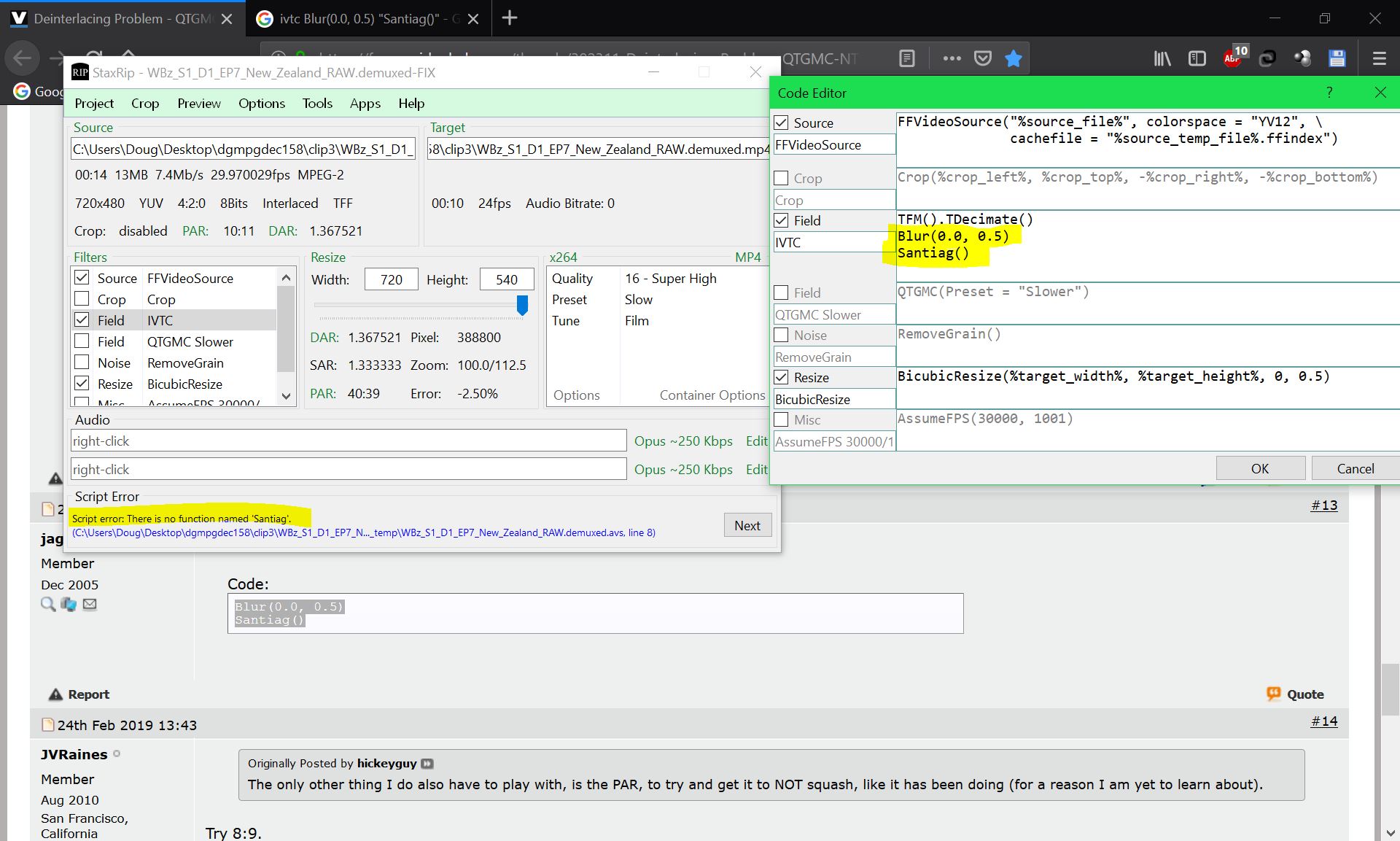

  13. After IVTC add
    Blur(0.0, 0.5)
    Santiag()

    G'day jagabo & JVRaines!
    Thank you for your added input here. As for the aspect ratio problem I was having, I managed a way around it by doing something that may be frowned upon here, but for my test it worked just as I wanted it to (thankfully). I changed the 'height' from 480 to 540 (StaxRip had me change a setting called "Output Mod" from number 8, to number 4, so that the height could be divisible by that number - something 8 & 540 weren't compatible, but 4 was). I didn't mess with the automatic PAR, DAR or SAR (just the resolution). I will definitely do a test later today and try your suggestion, JVRaines - thank you!
    For you code, jagabo - I would like to try a test to see what your code does, but I think I need you help as to how I need to implement it into the workflow i'm using (with StaxRip). Do you know how I need to enter this code, as placing it in the IVTC field, after manono's IVTC code, gives an error (seen in screenshot below). If I were to add another entry to the script/codes filters list, what might I add (to enter your code - like some kind of 'custom code filter' where that code can be placed in the list?). Thanks!
    [Attachment 48185 - Click to enlarge]
  16. You're have the code in the right place but you need to download the Santiag() filter.
    http://forum.doom9.org/showthread.php?p=1393006#post1393006
    http://avisynth.nl/index.php/Santiag
    Copy the text and paste it into a file called Santiag.avsi. Put that file in AviSynth's plugins folder and the filter will be available any time your use AviSynth.

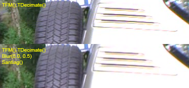

    Thank you very much, Jagabo. I did as you have instructed, and successfully got a render after I placed Santaig.avsi (with the script in that file) into the AviSynth+ plugins folder (along with nnedi3.dll - as it was required). The following image is a comparison between the IVTC code Manono suggested and then that code again but with the added Jagabo code as well =
    [Attachment 48187 - Click to enlarge]
    You can see that the blur in the code does make it blurred slightly (details in the grass, tail light and tire for example, have degraded). Is this the Anti-Aliasing degradation from the filter that Manono mentioned before? If so, I think I might stick with TFM().TDecimate() and not TFM().TDecimate() Blur(0.0, 0.5) Santiag(). Thank you though! I've learned something, and I really appreciate that.
    Right now, after a day of experimenting and contemplation, I am really happy with how the 'simple IVTC filter' processed the video, compared to the QTGMC filter which was unnecessary. The only problem I have with the IVTC right now (which I want to see about fixing somehow) is the framerate. Both the source and QTGMC renders run very smoothly, as the source is 29.97fps and the QTGMC is 59fps (motion is so smooth and fast). The IVTC takes it down to 23.976fps, where I can actually see very slight stutter in motion. Maybe stutter is the wrong word... It just isn't as "smooth" (to my eye) as the videos with the higher fps. I would love to figure out how to remedy this!
    Does anyone have any idea's as to how I might get this IVTC filter to give me this amazing detelecining result, but keep a higher frame rate? (so I have the smoothest motion possible). It is only very slight, but enough to bother me. That would be amazing if we could fix that!

  18. The point of adding Blur and Santiag was to reduce the aliasing on near horizontal edges that are visible in the "after" shot in post 12. It reduces the "buzzing" of those edges when viewed at normal playback speed. Of course, the result is less sharp. If it blurs too much for your taste lower the vertical blur value or remove the Blur entirely. Or leave out both and live with the buzzing edges.
    The source you provided was shot on film at 24 frames per second. It was then slowed to 23.976 frames per second and telecined to 59.94 fields per second analog interlaced video. When digitized, pairs of fields were woven together to create 29.97 frame per second digital video. IVTC with TFM().TDecimate() reverses the process and restores the original 23.976 frame per second progressive film frames. That is the correct way to handle this video (unless there are native 59.95 field per second shots mixed in with the telecined film). When this 23.976 fps video is displayed on a 59.94 Hz display the frames are repeated in a 3:2 pattern. That is, one film frame is repeated for a total of 3 frames, the next for 2, the next for 3, the next for 2, etc. So 23.976 frames becomes 59.94 frames (or fields in the case of old analog interlaced TVs).
    QTGMC peeled the digital interlaced 29.97 frame per second frames apart into 59.94 fields per second, then attempted to turn each field into a progressive frame using information from fields around it. The result is 59.94 frame per second video with repeats of the original film frames in a 3:2 pattern. Its deinterlacing isn't perfect so some the repeats may not be exact duplicates. There may be some small defects where detail is lost, horizontal edges bounce a little, etc.

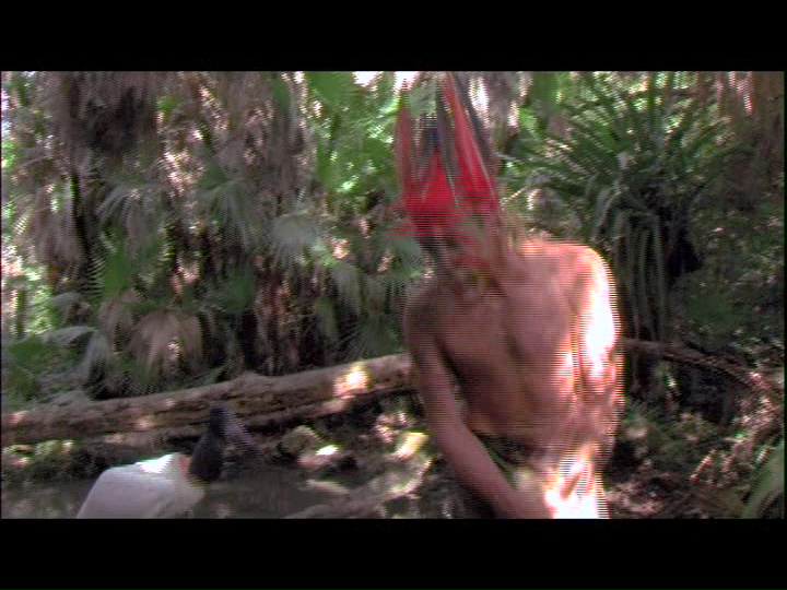

    That clip was original interlaced video (59.94 fields per second). It was very poorly deinterlaced to 29.07 fps progressive, then encoded 29.97 fps interlaced. It's progressive frames with 29.97 unique pictures per second. TFM() will not improve the picture. TDecimate() will make it jerky. QTGMC(InputType=3) will help a little.

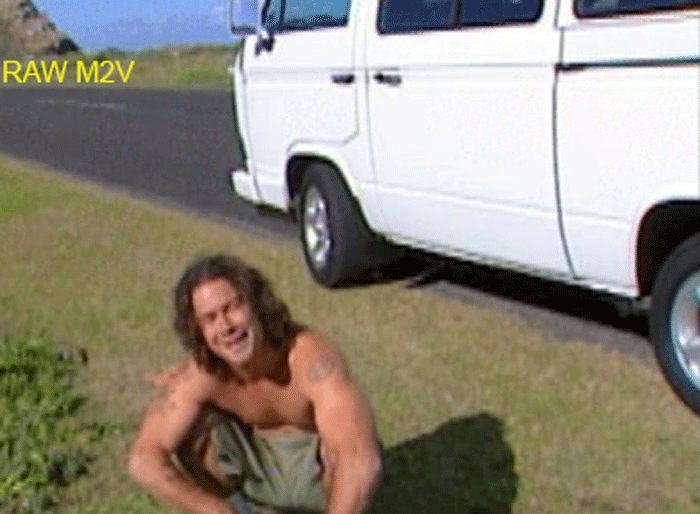

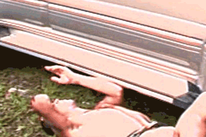

    G'day Jagabo!
    Thank you. I actually had a look through torrent search engines, to see if anyone out there has ever successfully deinterlaced/detelecined (or whichever) these DVD's, and I found a Russian page which had MKV encodes for all of these episodes including a MediaInfo breakdown for the MKV's (not sure if PAL or NTSC though - I believe NTSC - I have both in my collection, but both have proven to be very problematic with these jagged lines). I downloaded them, and noticed that they have had the exact same problem i've been having (the jaggies are everywhere, in so many scenes, throughout all 4 seasons!). So it isn't just me that has had trouble, I see - which makes me feel a little better, as i've been feeling like i'm missing something. I had a go with your QTGMC(InputType=3) code suggestion (thank you! - also tried type 1 and 2 along with ProgSadMask to see what that would do), and did not see ANY change regarding the jaggies in the m2v clip shared in post #1).
    I would absolutely love and dearly appreciate if you or someone could have an experiment with that clip (in post #1) and try to see if you can do anything to affect those jaggies. I've tried so many deinterlacing filters, and different softwares (tried Dscaler last night with some difficulty), and nothing is working on my end. The only glimmer of hope i've seen, is when using VLC, starting with the video PAUSED - when I TURN ON the deinterlace function (with any random deinterlacer selected as default - ANY of them produce this weird result) the image loses quality (blurs slightly), but there are no jaggies to be seen!!! BUT, the moment I pres play or 'E' to go to the next frame, the jaggies appear again, and that frame never appears again unless I turn off the deinterlace function, and turn it back on again (with the video paused). Here is an example framegrab of the moment I turn on the deinterlace function.... it only seems to last for 1 single frame, and it seems to appear that the deinterlace no longer affects the footage after resuming to further frames in the video.
    [Attachment 48237 - Click to enlarge]
    And for your reference, this is the next frame - and as you can see the deinterlace that VLC applied to the previous/above frame, no longer is in effect =
    [Attachment 48238 - Click to enlarge]
    Surely there is something in AviSynth/StaxRip that can fix this. I am highly intrigued by this! If it is baked into progressive frames (or whatever the case), i'd love to learn how to manipulate it in a way to stop them from appearing. I'm sorry if a solution has already been shared with me (if anti-aliasing, as mentioned previously, is the answer?), but i'm still new to this, after years of starting/stopping this project of mine. I feel like an annoyance to everyone here, but I was expecting this to be a challenge people might enjoy learning from along with me! If more m2v's are desired, please do let me know - however, I think if the clip in post #1 can be fixed, that there is hope for the way forward through the rest of the videos.
    Kind regards!
  25. Originally Posted by hickeyguy View Post
    Yes, you can use an antialiaser (AA) as mentioned earlier. There are dozens to choose from; some are better at different types of aliasing (or some settings work better for specific types of aliasing patterns)
    In general, AA filters are very damaging to fine details, so in general you'd only want to use them sparingly (not that you have much fine detail here to begin with, so you can probably go overboard)
    Some work intra frame only, some are temporal. You usually need some temporal smoothing for video, or you will get flickering in motion across frames
    You might use different settings, or different types of AA filters for different scenes. You might even apply them selectively through masks (apply to different sections of an image, selectively) as you don't want to blur or damage all the details to much
    Your two samples have different characteristics, so you 'd have to treat them differently (this one is actually progressive and badly deinterlaced)
    For this scene ("WBz_S1_D1_EP1_South_Africa_1_RAWclip.demuxed.m2v ") , it might look like
    MPEG2Source()
    EEDI3(field=1)
    QTGMC(inputtype=1, sharpness=0.2, preset="very slow")

    G'day poisondeathray!
    Thank you for your detailed response. Very much appreciate it! I just gave your script a go (after placing eedi3.dll in the plugins folder), and have just received the BEST result i've seen yet, for that clip shared in post #1. I'm shocked, as i've tried so many deinterlacers - but this script you have kindly shared with me, has given a really nice result. Here is a screenshot, which i'm very excited to share =
    [Attachment 48240 - Click to enlarge]
    And my goodness! I've just compared it to the above 2 screengrabs I shared yesterday, and it even surpasses the VLC deinterlace that I was so confused by. Wow!
    I have some further testing to do tomorrow, and some reading to do for EEDI3 (I need to learn more about it). Exciting stuff, poisondeathray! Are you a fan of the MTV series Wildboyz? Well, from one fan to another (even if you're not), thank you so much. Fingers crossed with this new start, I can figure out what to do next after tomorrows tests. I want to encode the entire episode just to see how it affects other scenes. I am also very happy with this script as it keeps the original 29.976fps... I was worried that QTGMC might interpolate it up to 59.94fps, but it looks like it didn't .

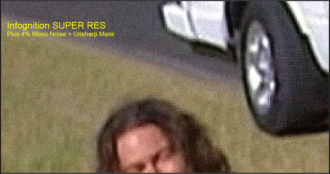

    G'day Everyone!
    Just a quick update from me today! I've had a lot of fun - yesterday I spent a good amount of time testing and comparing the quality of pixels in frames (between each encode), and i'm very happy with it so far. The below is a quick animation showing 4 frames - 1 original M2V, 2 EEDI3 & IVTC/TFM(), 3 EEDI3 with the suggested QTGMC code, and 4 an upscale with added noise and sharpen (maybe too much sharpen), just for fun (to see if I could improve the picture quality in Premiere Pro).
    [Attachment 48258 - Click to enlarge]
    Today, I have tried searching around for reading material. I've only scratched the surface regarding all of the documentation and forum threads about EEDI3 & QTGMC, but I found that adding NoiseProcess=2, NoiseRestore=1.0 seemed to bring back a lot of the detail that QTGMC removed by default, but didn't really affect the magic EEDI3 did on those jaggies thankfully!). I haven't created an animation or side-by-side comparison for everyone to see, but it really did the trick. Still more testing for me to do, as I still need to try this noise bypass thing on another scene.
    Thank you again, Everyone! I just love where we've reached thus far. I'm not sure if there's really anywhere further to go from here. I will definitely add more here in this thread, if I find anything or need your assistance. Actually, just for fun - i'd love to know if anyone has an AviSynth process for upscaling, like Infognition's SuperResolution plugin, but better? Maybe that's not really possible right now - creating detail where none exists (maybe something for in the future - as I had a read of an article about GAN 2.0 - NVIDIA’s Hyperrealistic Face Generator, and about how these learning computers could be used for super resolution - maybe better than using algorythm's like Steffen Gerlach's 'A Smarter Scaling' or Topaz Gigapixel).
    Kind Regards!

    i'd love to know if anyone has an AviSynth process for upscaling...
    NNEDI3_Rpow2, perhaps with some sharpening afterwards.
    A sample script might go:
    nnedi3_rpow2(rfactor=2,cshift="Spline36Resize",fwi dth=704,fheight=480)###VCD to DVD
    Geez louise! Thank you, manono! I had a go (and did a little quick reading as well) and made a comparison between my fun test last night (using Infognition's Super Res plugin - for AFx/PremierePro) and tonight's NNEDI3_rpow2 code you have shared with me for AviSynth.
    I amazed, as after my initial comparison, I didn't think it worked very well. But after a closer look, I am amazed by the result! Have a look at this 2 frame animation/comparison! =
    [Attachment 48260 - Click to enlarge]
    Isn't that amazing! More detail AND the colours haven't altered (like it did through the Super Resolution plugin). Both of those frames are screenshots from within After Effects, so the comparison is true. Thank you manono - I appreciate it very much, and will be reading more about this going forward. My plan is to first create EEDI3-QTGMC renders for all of the episodes using all of the information we have shared and learned about here, over the past week - and then afterwards, try to upscale to 720p, as a kind of fun project to see if I can improve the image quality (as HD versions of this show have not yet been released on Blu Ray, or on WEB streaming services). That's pretty exciting!
