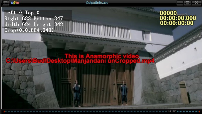

unless there is something differnet with x265 codec crop should work but has a threshold setting. Below is a sample to detectcrop show, using a setting of 30% for threshold:
Code:LoadPlugin("C:\Users\Bud\Desktop\MEGA_Trimmed_Tabbed_2_2\bin\Debug\AutoCrop.dll") DirectShowSource(("C:\Users\Bud\Desktop\[dp]Manjandani-1.mp4"), Pixel_Type="yuy2").AutoCrop(mode=1, threshold=30) Subtitle("C:\Users\Bud\Desktop\[dp]Manjandani-1.mp4", x=864, y=204, font="Arial", size=24, text_color=$ff0000, align=3) Subtitle("This is Anamorphic video", font="Arial", size=24, text_color=$ff0000, align=5) ShowFrameNumber(scroll=true, x=560, y=27, font="Arial", size=24, text_color=$ffff80) ShowTime(x=622, y=44, font="Arial", size=24, text_color=$ffff80) ShowSMPTE(fps=23.976, x=618, y=61, font="Arial", size=24, text_color=$ffff80)
[Attachment 48142 - Click to enlarge]
It has a lot of extra stuff spit out from my auto program, but alter as necessary.

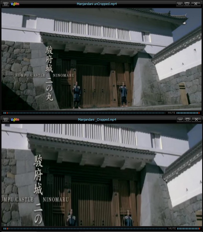

Crop using the following format:
again, -ss and -to are not necessary but I include in case future editing needs it. In this example they do not alter at all.Code:ffmpeg -i "C:\Users\Bud\Desktop\Manjandani unCropped.mp4" -ss 00:00:00.000 -to 99:00:00.000 -vf crop=564:228:60:60,scale=684:348,setdar=1.966 -vcodec libx264 -crf 22 -r 23.976 -acodec aac -ac 2 -ar 44.1k -b:a 128k "C:\Users\Bud\Desktop\Manjandani_Cropped.mp4"
[Attachment 48141 - Click to enlarge] -
