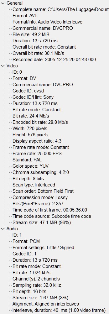

    I've attached a picture showing what Mediainfo has to say about the recording. I just can't understand what's going wrong! Any help resolving the puzzle will be greatly appreciated.

    that mediainfo says the audio is 32kHz which is 12 bit. 16 bit audio would be listed as 48kHz. something is wrong with the audio it can't be 32kHz and 16 bit.

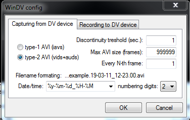

    first make sure you have windv set to type-2 avi. second, what can happen with capture programs is that they only look at the first frame they receive and set the audio type for the entire file from that. i'd try not starting a capture until the audio on the tape has played on the camera for a few seconds and see how that comes out. only capture about 10 seconds and upload it here for others to check and see if they can figure out what's wrong.
    here are the settings i usually use for windv captures

    Here's the thing: ON THE TAPE, 32kHz is always 12bit, 44 & 48 are 16bit. When it gets transferred, computers don't like non-Mod8 bit structures, so it pads it to 16bit. Under the hood, it's still 12bit. So ignore MediaInfo in that regard.
    The other thing is that 32kHz is also always 4 channels, not 2. However, not counting the audio stream embedded in the DV video, just about ALL transfer apps (WinDV, Scenalyzer, PremierePro, etc included) will ONLY transfer 2 channels at a time. So if you have ch1,2 set to transfer, but the sound is primarily/only on ch3,4, you get nothing in the resulting separate Audio stream.

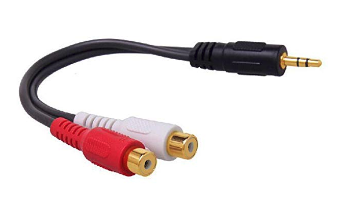

    the yellow is video, red is right audio, and white is left audio. if your computer has audio line in you can get a dual rca female to stereo male 3.5mm. and then use something like audacity to capture the audio.
