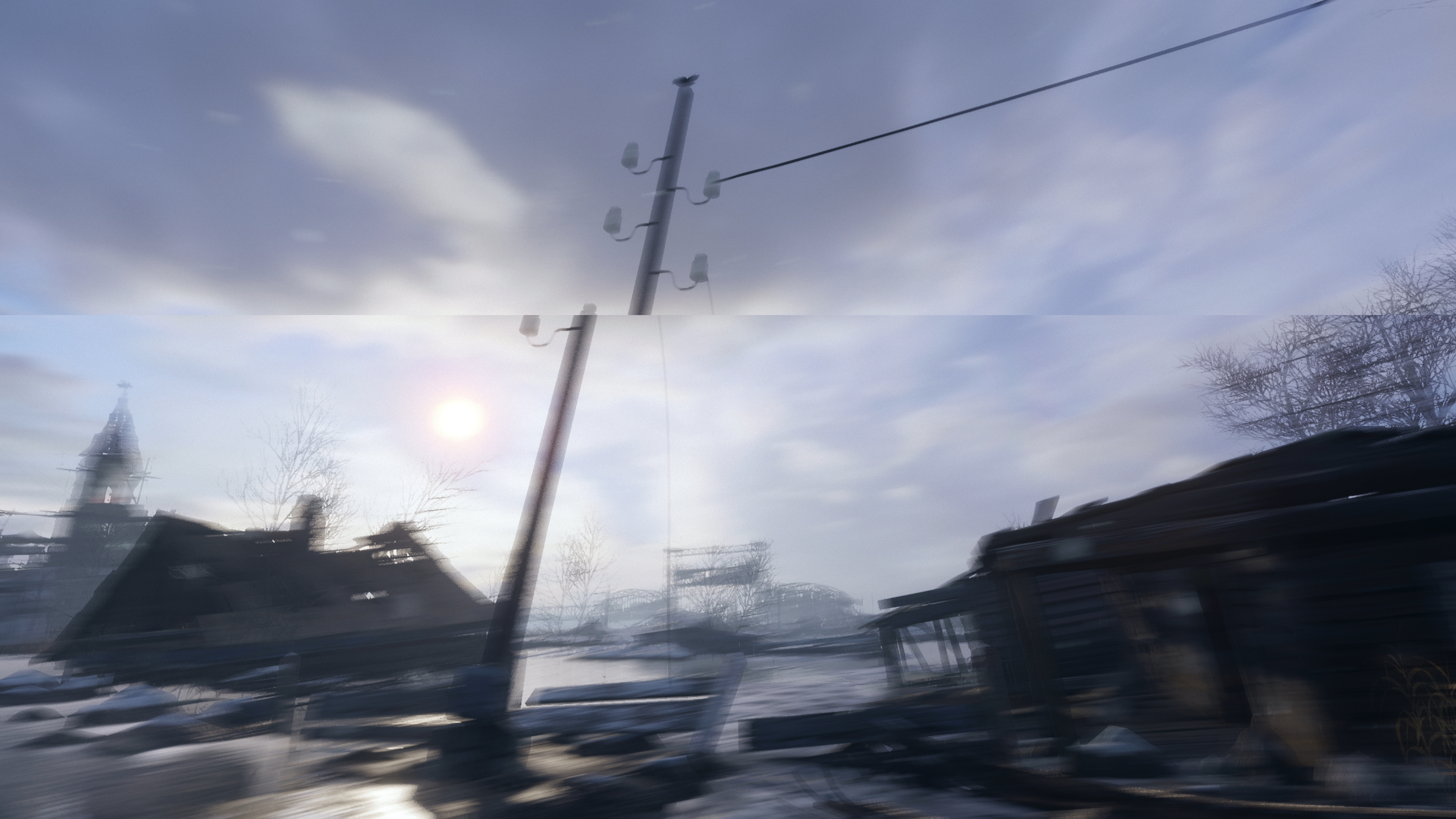

    I am recording with a VisionSC-UHD2 card, but basically the problem exists with all my capture cards. When I try to record from that card with lossless settings, I get color ghosting in my video files. The color ghosting only appears while recording in 3840x2160, and not in FullHD recordings.
    I use standard settings for OBS which means: simple mode, lossless quality, 3840x2160. From what I know OBS uses UT.video as codec for lossless recording.
    The captured sources are video game consoles connected via HDMI.

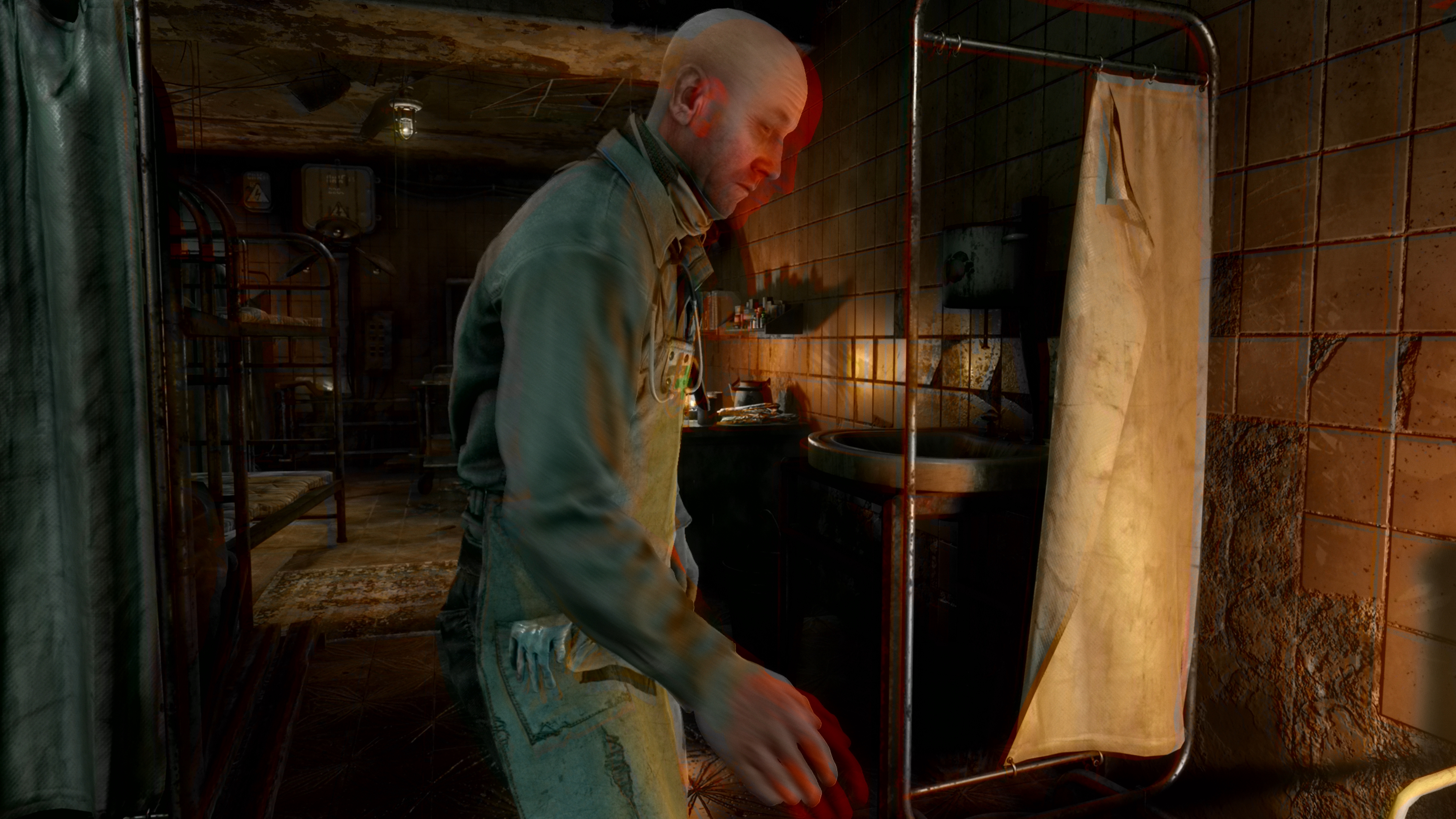

    The ghosting looks like this, look at the doctors head.
    [Attachment 48137 - Click to enlarge]
    Can anyone help me, this is driving me mad. Thanks in advance, I appreciate every tip.

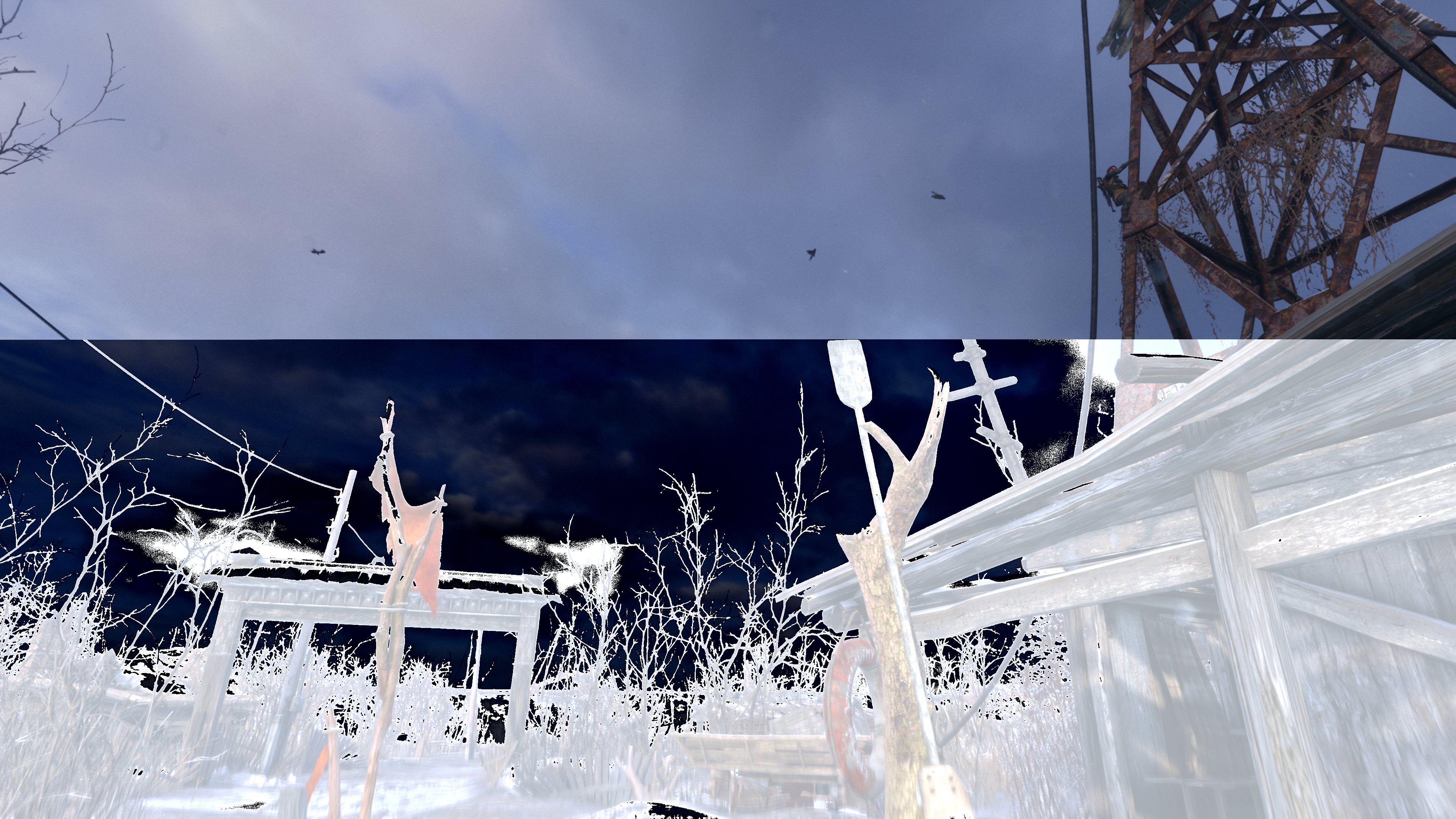

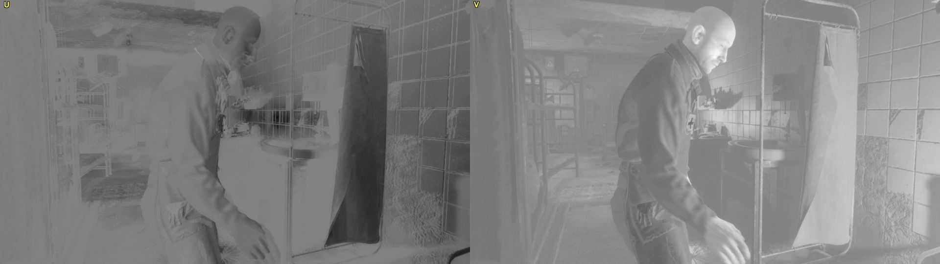

  7. Looking closer, it doesn't look like the usual interlaced/progressive chroma problem. The errors appear to be limited to the U channel:
    [Attachment 48140 - Click to enlarge]
    You can see the ghosting in the U channel but there doesn't appear to be any in the V channel.

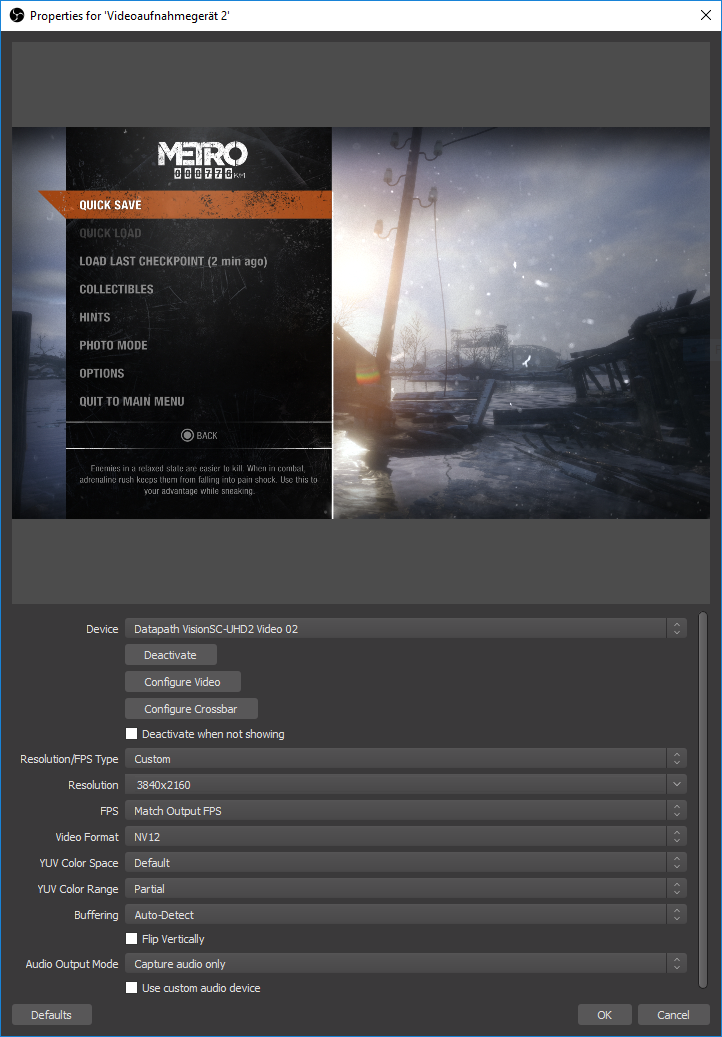

    ...Do yo have YV12 as an option?...

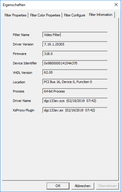

    [Attachment 48143 - Click to enlarge]
    [Attachment 48144 - Click to enlarge]
    [Attachment 48145 - Click to enlarge]

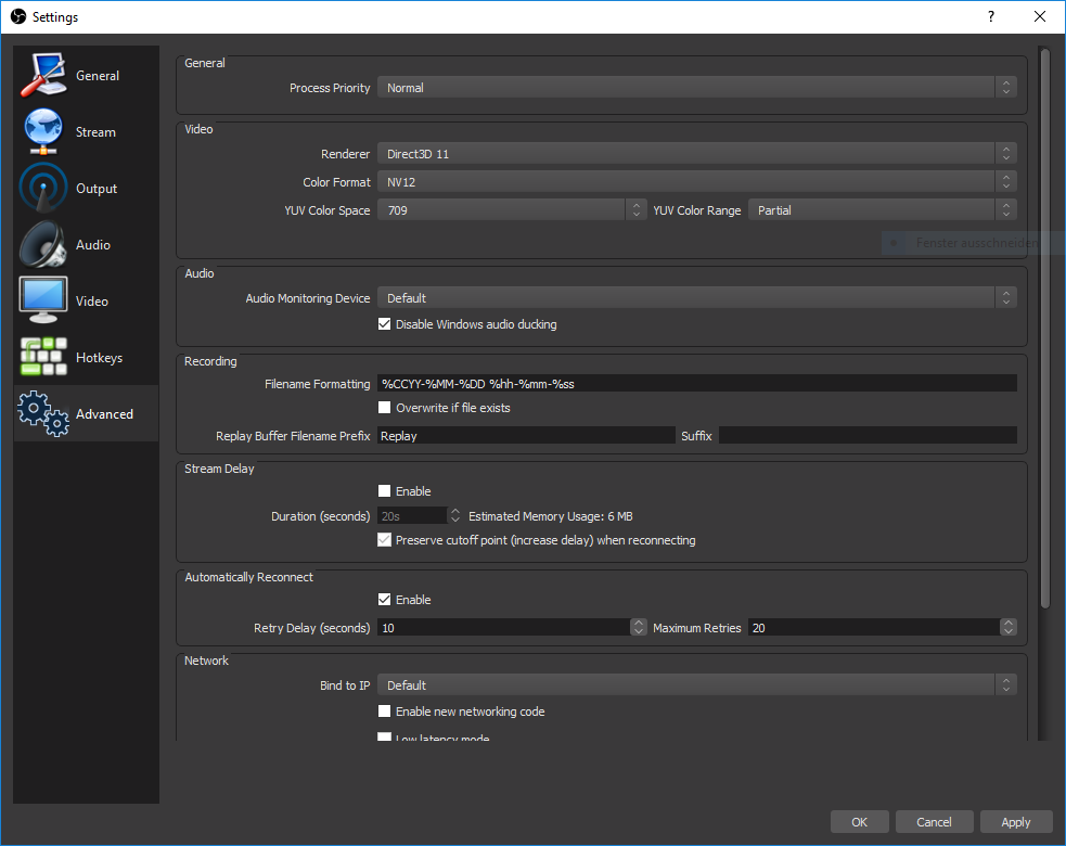

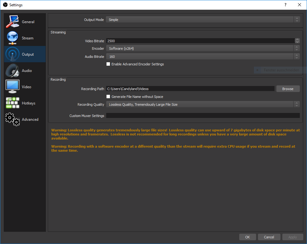

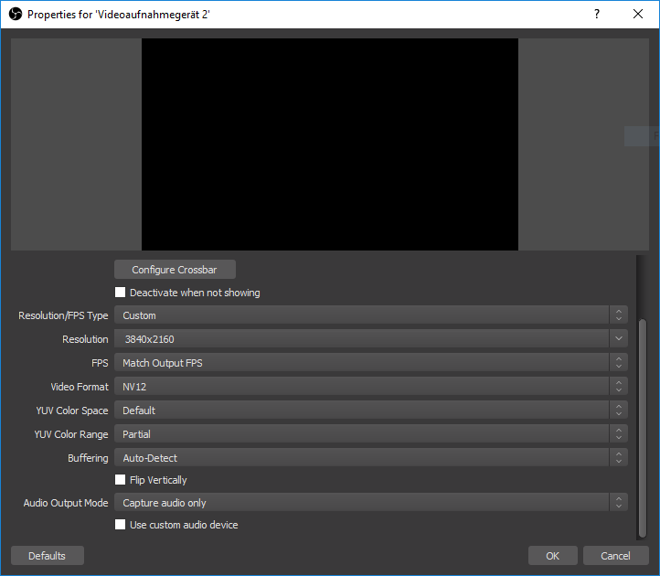

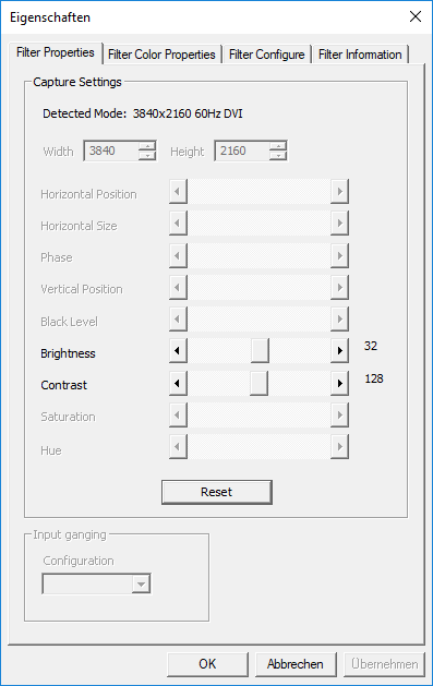

    My config is normally like this:
    [Attachment 48207 - Click to enlarge]
    [Attachment 48208 - Click to enlarge]
    [Attachment 48209 - Click to enlarge]
    [Attachment 48210 - Click to enlarge]

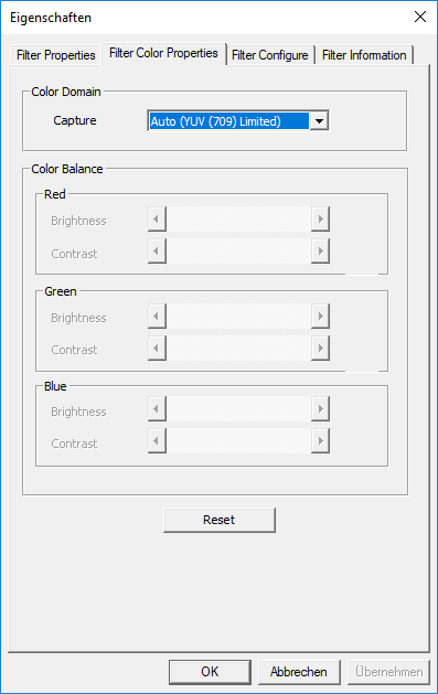

  26. Dinosaur Supervisor KarMa's Avatar
    Jul 2015
    US
    In post #23, on the 5th picture there is a drop down menu called "Capture". It's in auto mode, what other options are there? As the output from something like a Playstation or a Xbox over HDMI is going to be RGB, not YUV. So capturing in YUV might be a problem.
