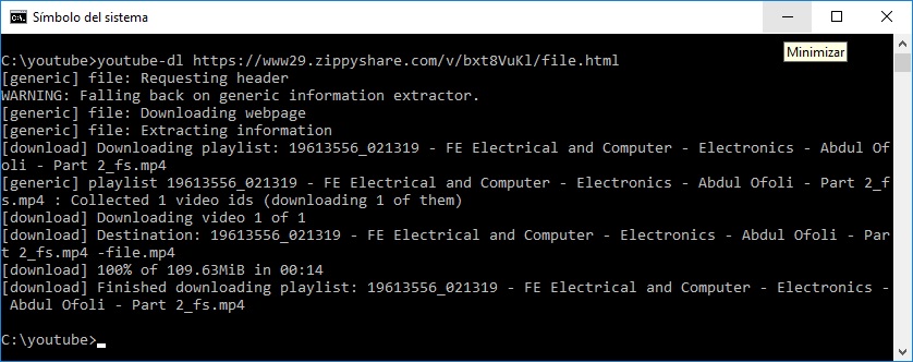

  7. Last edited by sekininsha; 20th Feb 2019 at 23:25.
    責任者-MDX
  8. I found this thread https://forum.videohelp.com/threads/390844-How-to-download-from-this-website trying tube digger doesn't work with m3u8 files. I am not sure how xlmpaler managed to work it out. I am still stuck with this, I do know the Cookie parameters values. Can that be used w/streamlink or youtube-dl to get a valid session? If anybody has a solution pls share your knowledge thanks
  9. That's the video that Ponens managed to extract from the m3u8 in the first post. @sekininsha
