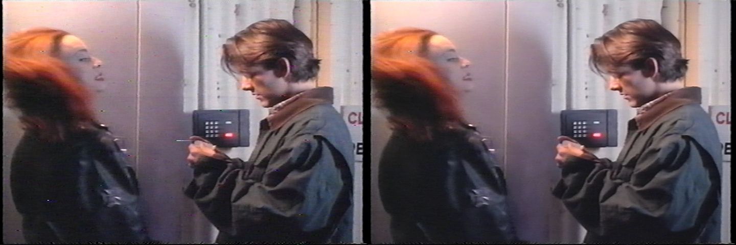

  5. I was wrong earlier. SpotRemover crashes with recent versions of VirtualDub but appears to work when imported into an AviSynth script.
    Original : SpotRemover.vdf (via AviSynth script)
    [Attachment 48122 - Click to enlarge]
    Note that some of the comets/spots are gone. My guess is you can reduce them further by tweaking the settings.
    With the native RemoveDirtMC(30) in AviSynth:
    [Attachment 48119 - Click to enlarge]
    One small comet left in the woman's moving hair but otherwise clean.

  7. Originally Posted by LMotlow View Post
    My experience with the VDub remove spots filter is that it didn't remove anything, period.
    In the video I was testing (called from AviSynth) it removed most of the comets and other small blemishes.
    I was able to get it working with some videos and a recent version of VirtualDub. With other videos VirtualDub crashed once the filter was added.
