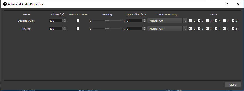

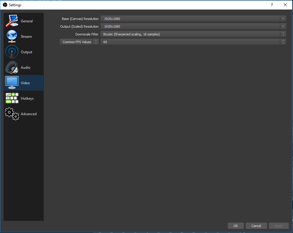

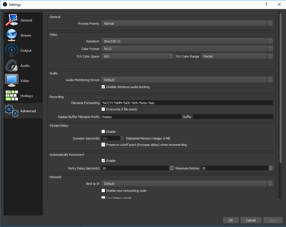

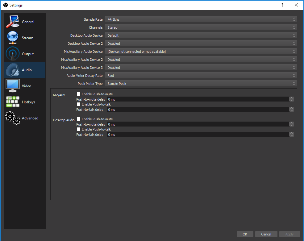

    Hi Karma and other video experts.
    I did the screen recording with the above settings. The small jerks(type1) which I faced was resolved when I used the H.264 AMD GPU encoder, so that the GPU encodes the video and not CPU
    Please see the type1 jerks as below.
    cut-2.mp4
    However after using OBS Studio with the above settings Im seeing another type of jerk(type2), please see video below occurring between 0:33 and 0:40
    type2.mkv
    This happens multiple time(like once in every 10 minutes)
    Here are all the video and audio settings I use in OBS Studio
    Any idea why Im getting this and how this can be resolved. Any help is much appreciated.
  5. Your first problem is that you're capturing 25 fps video at 30 fps or 60 fps. As a start, setting your graphics card to 50 fps and capturing at 50 fps or 25 fps might help.
    The problem in the second file looks like dropped frames while streaming, not a capture problem.

  8. aBigMeanie aedipuss's Avatar
    Oct 2005
    666th portal
    in the obs settings click on video and there is a setting for common frame rates. choose 25fps.

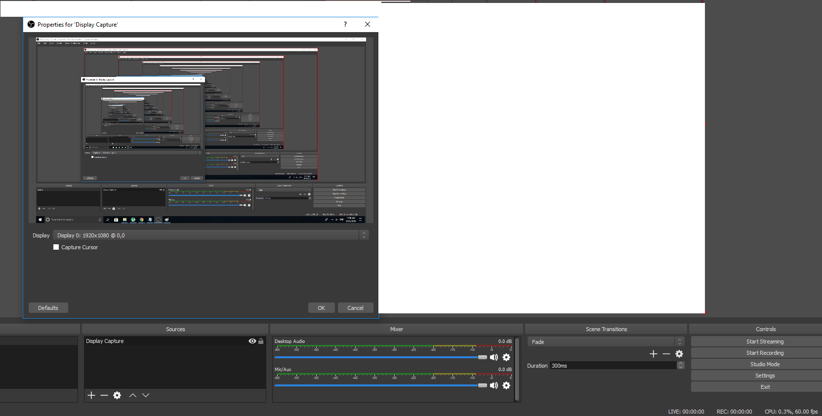

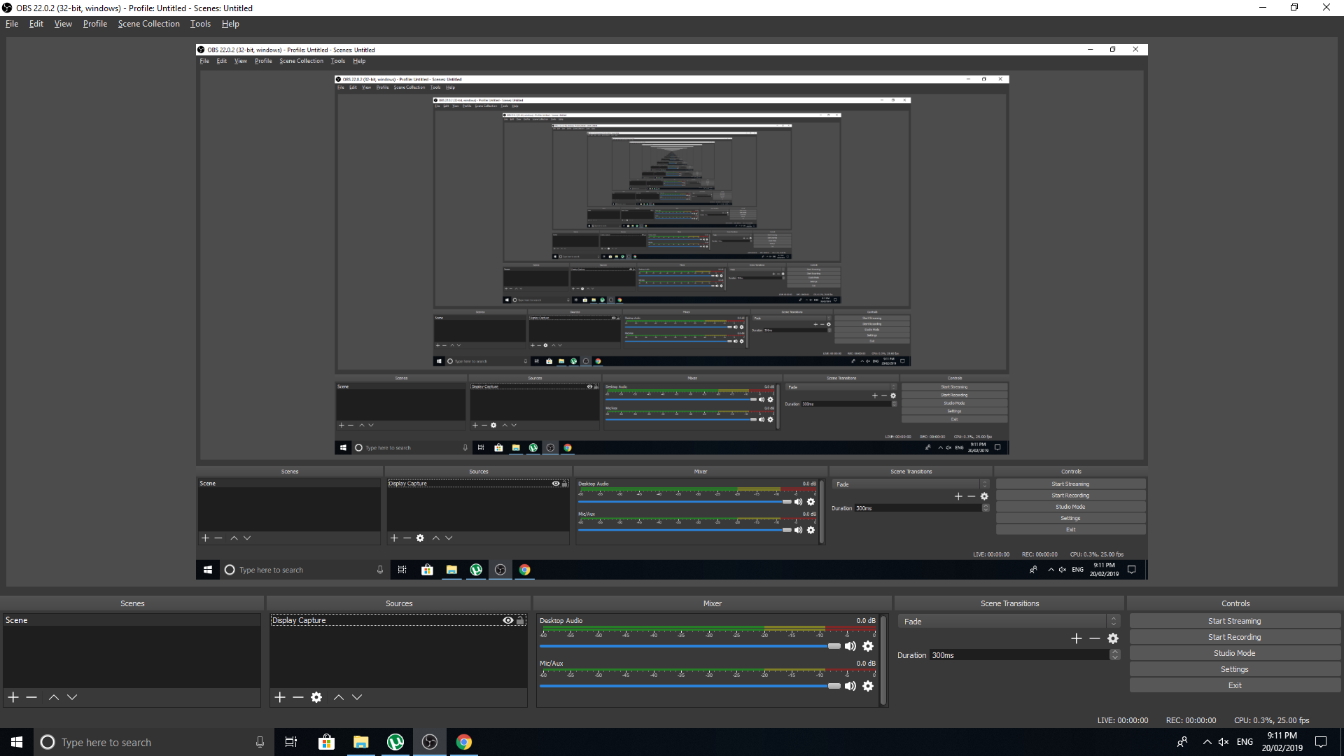

  24. Friends, facing a strange issue. When I open the OBS Studio Im not getting to see the desktop. All I see is OBS Studio window inside OBS Studio windo infinitely.
    Like this..
    Any idea how to get to show the desktop so that I can select what to scree record?
  25. Member Cornucopia's Avatar
    You ARE seeing the desktop. You're just seeing OBS on the desktop, and it sees itself, within itself, within itself, etc. Standard video feedback. It's a catch-22 where you can't see what your doing if you minimize it.
    You can change that by going into your prefs and choosing a different window size and then move OBS out of that area. Me, I just use 2 monitors and put OBS on 1 monitor and record the desktop of ONLY the 2nd monitor. Works real easy. Hard part is making sure that there are no stupid desktop notifications popping up to ruin the perfect recording.

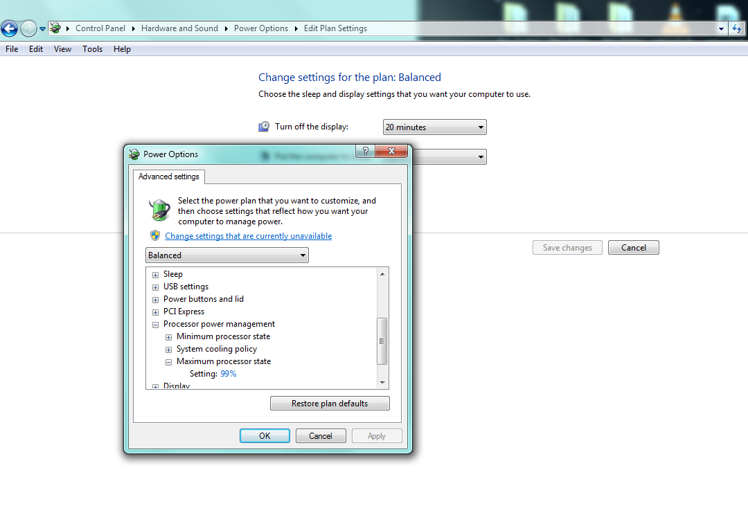

  27. Dinosaur Supervisor KarMa's Avatar
    Jul 2015
    US
    [Attachment 48152 - Click to enlarge]
    In Windows7, under processor state I keep it at 99% Max if I want to prevent the highest processor state (which is the hottest and least efficient). I would assume Win10 has similar Power Management options. If you ever try again, I'd suggest you record at 60fps simply because you don't know what the original rate should be. It was probably something between 24fps and 30fps but your 60fps looked fairly smooth and should help to reduce jerkyness.
