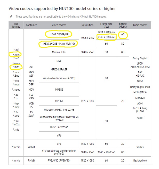

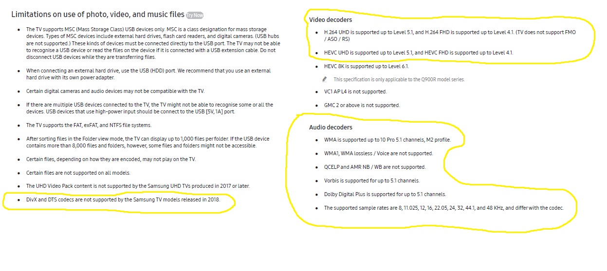

  1. Hi all hope you can help. I want to get the most out of my new Samsung 49" 8070 4K TV
    4K tv. I have some 4K videos that I want to encode to get the most out of my TV. However I'm struggling to find the best encoding as either the audio or video isn't supported or a combination of both. This is what my TV codec supports:
    (see pictures in attachments)
    I'm using Handbrake to encode my videos and although it has most options for video its hard to encode the audio as my TV no longer supports DTS codecs and handbrake doesn't seem to give you the option to convert DTS to Dolby Digital.
    What would be you recommended encoding software for my videos and which settings would you choose?

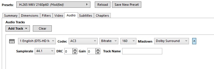

    Would these audio settings be ok also:
Name:	audio codec.jpg
    Is the source really 44.1 kHz? Most Movie/TV stuff is 48 kHz.
    "Dolby Surround" mixing is not recommend, usually. Either use "5.1 Channels" if you want to preserve multi-channel audio from the source or "Stereo" if you are fine with 2 channels. If you go multi-channel I would recommend 640K bitrate for high quality.
    Mar 2008
    Leave the sample rate as 48, the same as the source
