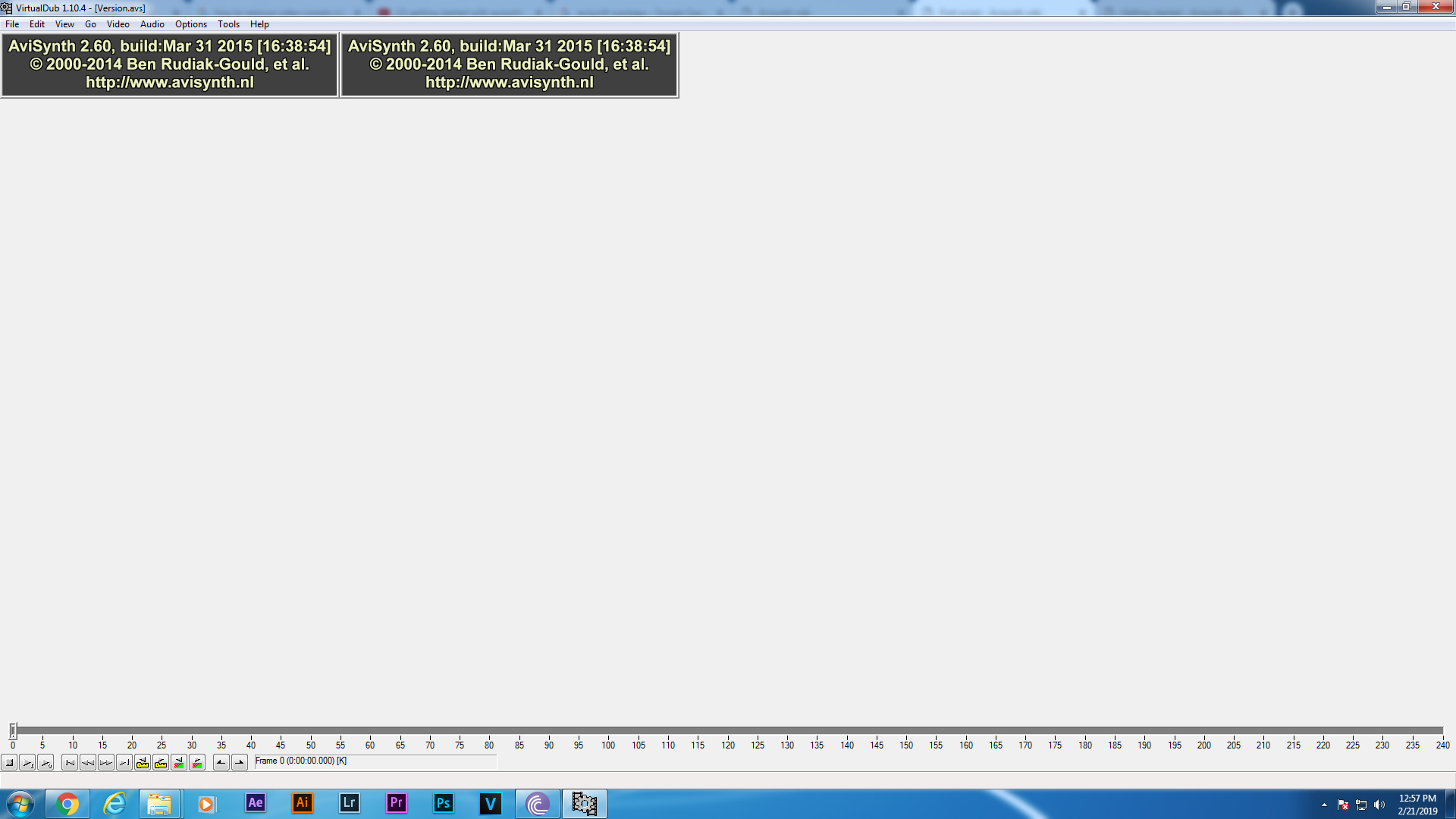

Okay, I am finally sitting down and trying to get through this....
[Attachment 48150 - Click to enlarge] -
You got AviSynth installed correctly, so, congrats. It's the + version so someone else will have to take it from here as I've never used it and have no idea what additional problems it might present for using QTGMC, if any. If I were you, I might take blud7's suggestion of installing StaxRip and using the QTGMC in it.
That image indicates you have 32 bit AviSynth+ and 32 bit VirtualDub installed. QTGMC works with 32 bit AviSynth if you install all the correct 32 bit third party dlls.

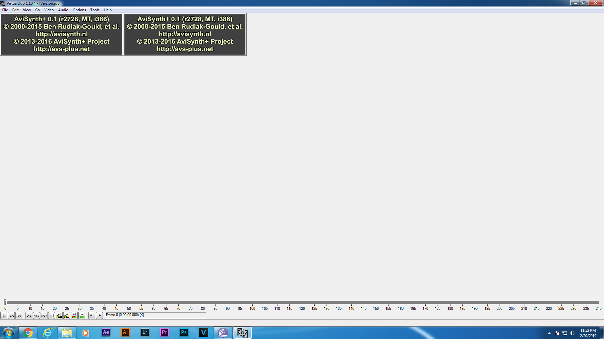

[Attachment 48158 - Click to enlarge]
I went back to the regular instead of the plus. Now I am starting to follow along with the guide on the AVIsynth site. -
