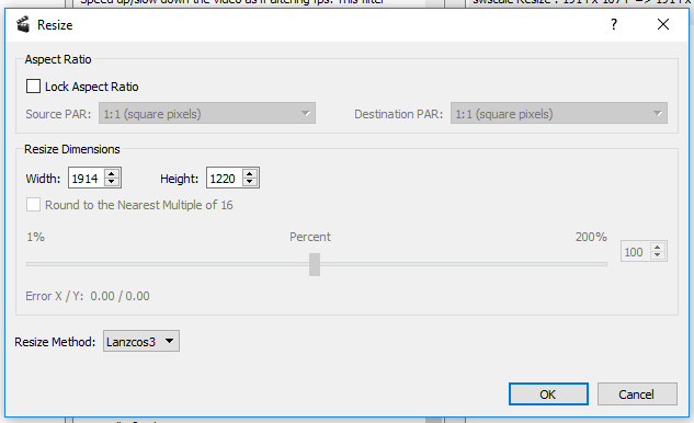

    This video has a resolution of 1914 X 1074
    The issue is that it is squeezed vertically. Horizontally its fine
    So I just want to keep the horizontal measurements same and extend it a bit vertically

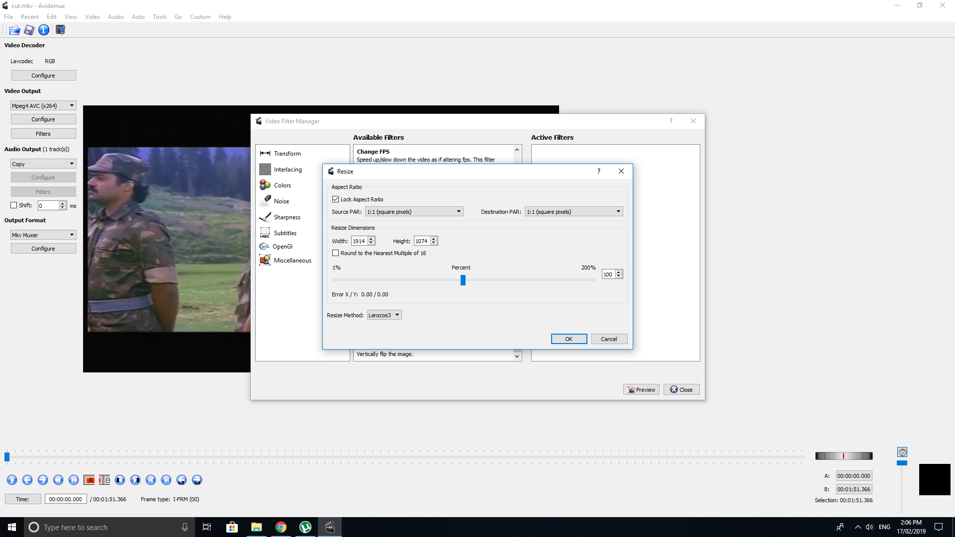

    I decided to edit it to 1914 by 1220 pixels
    Using resize filter in avidemux I gave the above values and did the edit.
    But the resulting video has height fixed, but the width became shorter as well.
    I don't want to change the width at all.
    Is it possible to do that?

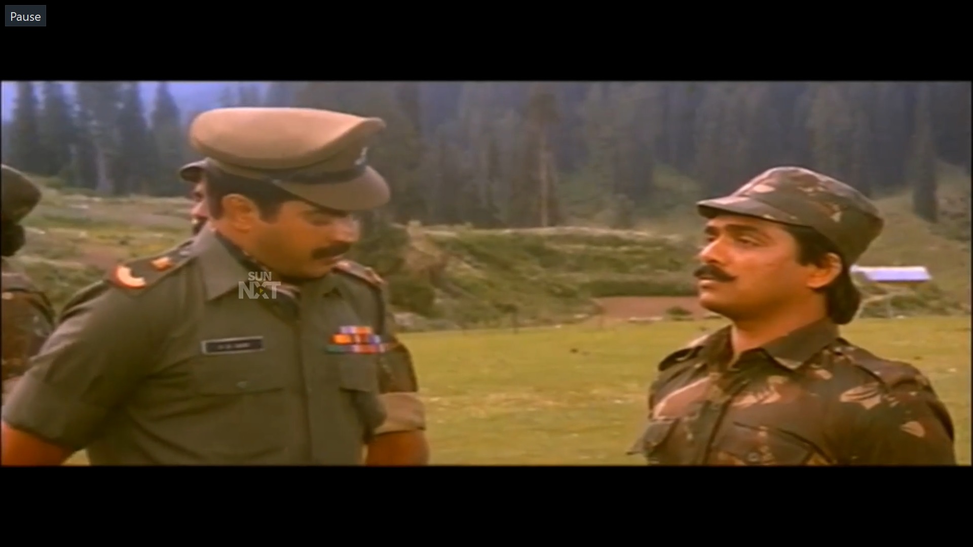

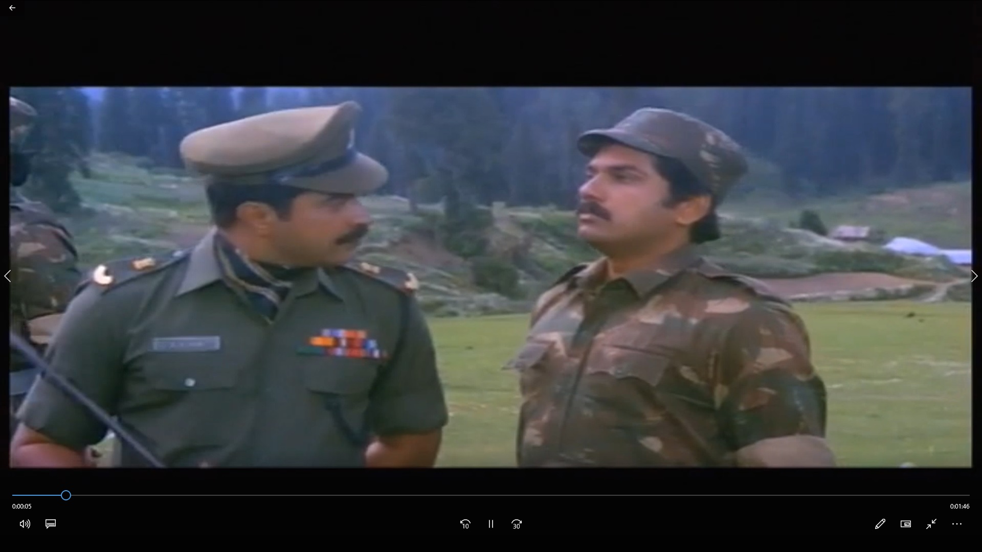

    This is how the video looks on my 1080p HD monitor(spans fully across the width of the monitor), but this has the face of characters squeezed vertically. Also see the setting when this video is opened in avidemux
    Now I appy the filter as
    1914 X 1220 ( I assume the width is same but the height is expanded)

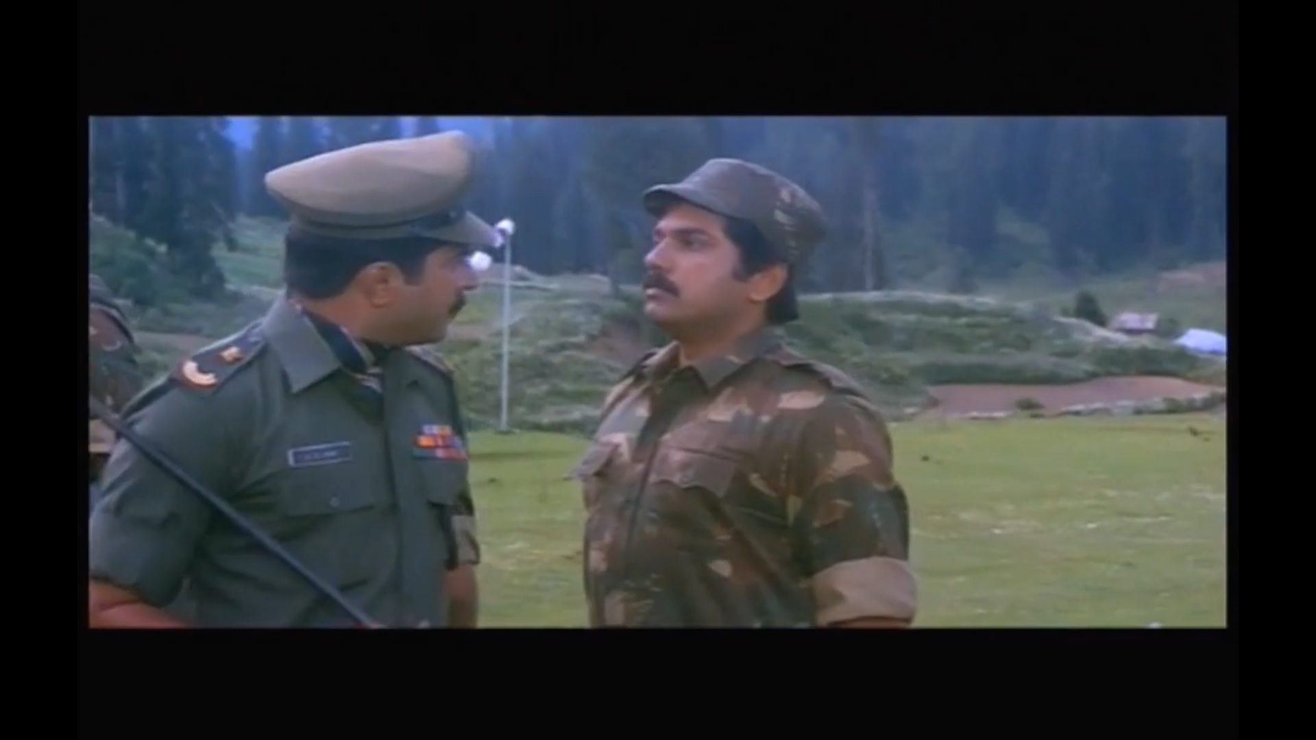

    When I open the edited video this is how it looks
    The issue is the width also got reduced and now it doesnt span across the whole width of the monitor. The video had become smaller

  10. The width isn't being reduced by AviDemux. It's being reduced by the player because your monitor is 16:9, not 16:10. You need to crop away some of the letterbox bars to maintain a 16:9 aspect ratio. Ie, upscale to 1914x1220 then crop 72 lines off the top and bottom leaving 1914x1076.
    I didn't verify that 1914x1220 is the right size to upscale to. I just used your values.

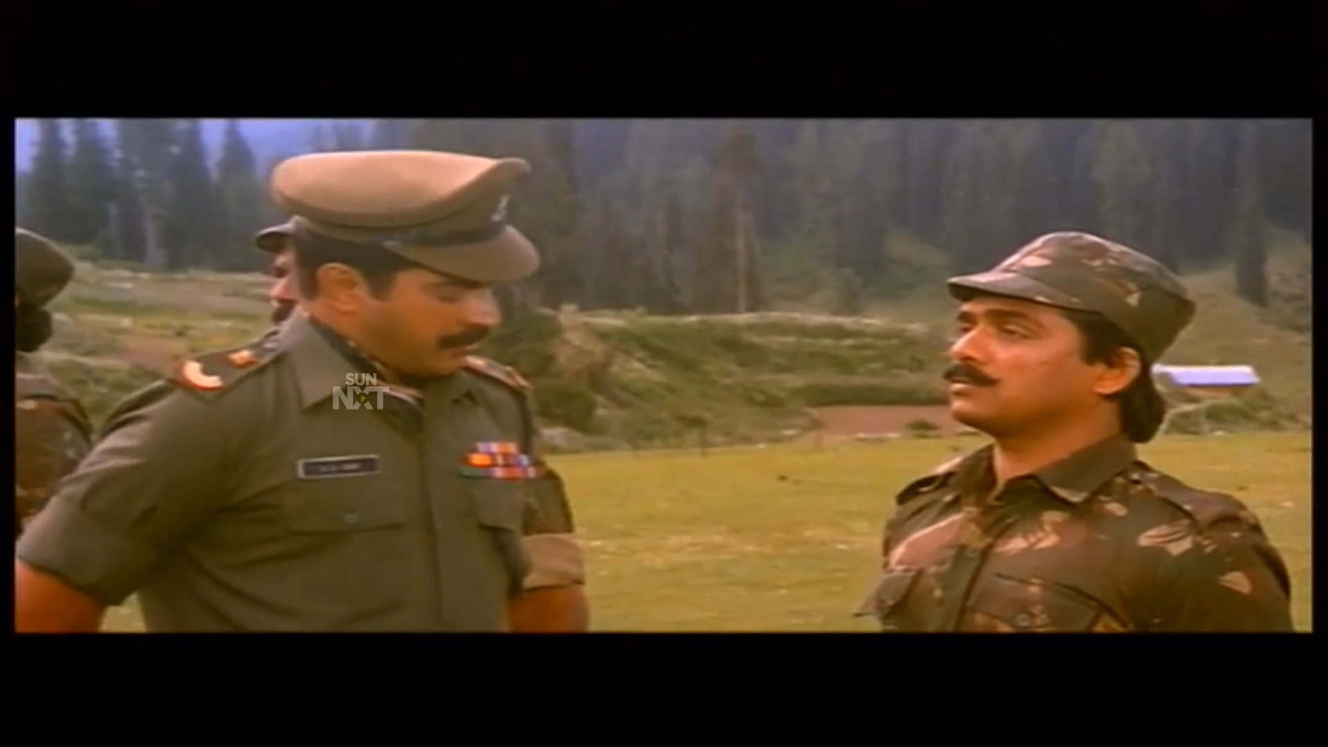

    Here's a quick and dirty fix, crop top, bottom and sides, resize to 1:85 aspect ratio giving width of 1920, then re-add the borders top and bottom
    to give 1920x1080

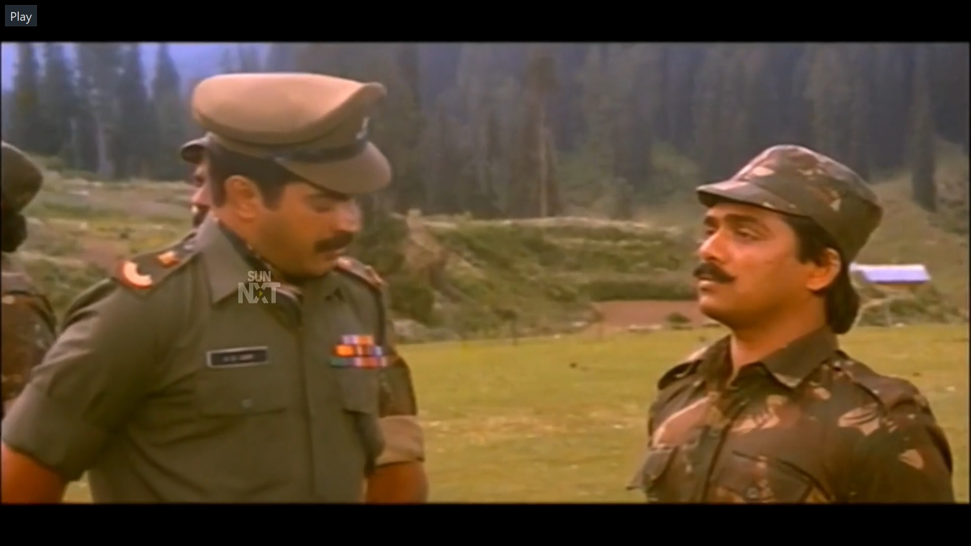

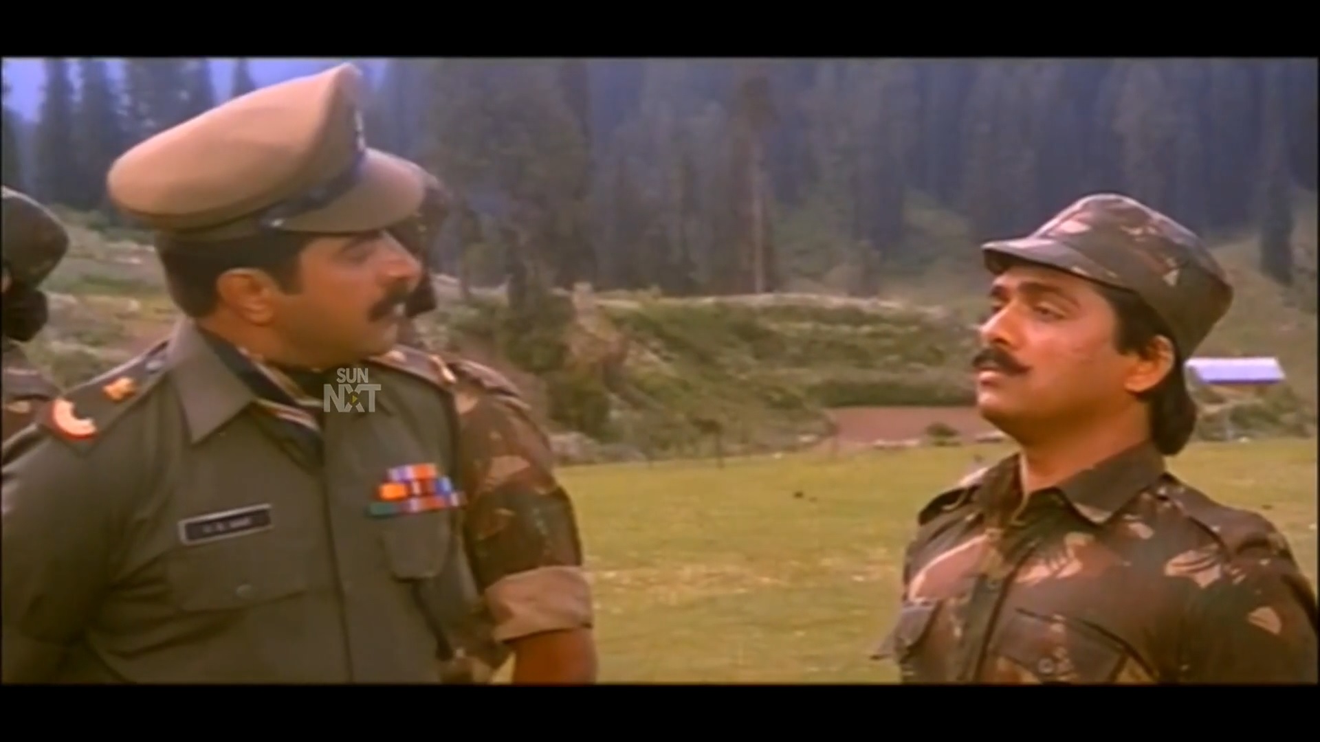

    I did something which actually fixed the problem with AR.
    But based on the understanding I have from this thread, it doesn't make sense to me.
    Here is what I did
    Original video 1920 X 1080
    1. Cropped all the black borders around the video to get full screen of picture -> 1880 X 750
    2. Resized to -> 1920 X 920
    3. Add 80 lines top and 80 lines bottom to bring it to 1920 X 1080
    However the video after step 2 and step 3 looks the same.
    Why is that. Attached a screenshot of each step..
    Does that mean I can save around an hour of Step3?
  20. When you play a 1920x920 video full screen on a 1920x1080 monitor the player adds letterbox bars to fill the screen. That's why cases 2 and 3 look the same.
  21. Originally Posted by navarannan View Post
    Not that I'd bother adding borders myself, because as jagabo said, if you don't add borders the player will add them as required on playback anyway (as opposed to stretching the picture to fill the screen instead), but why does adding them take an extra hour? Maybe I'm missing something, but normally you'd configure your encoding program to crop, resize and add borders as required (as per the screenshot in my previous post), and from there the cropped/resized/bordered output is encoded, so from that perspective it's all done in a single step.
    PS. When I cropped the black I ended up with picture dimensions of 1866x736. Your cropped picture is 1880x750, so I assume you didn't crop all the black, even if there wasn't much remaining.
