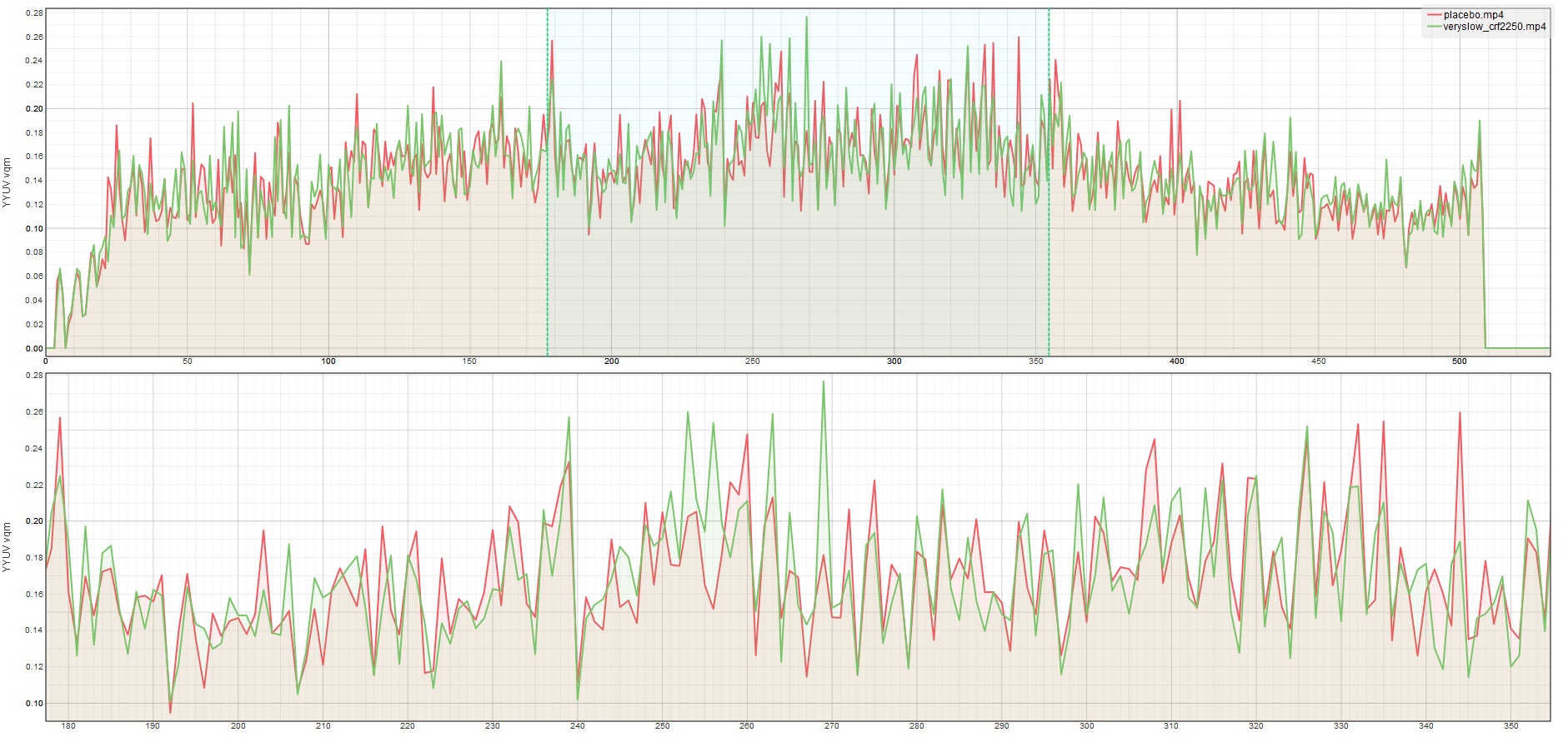

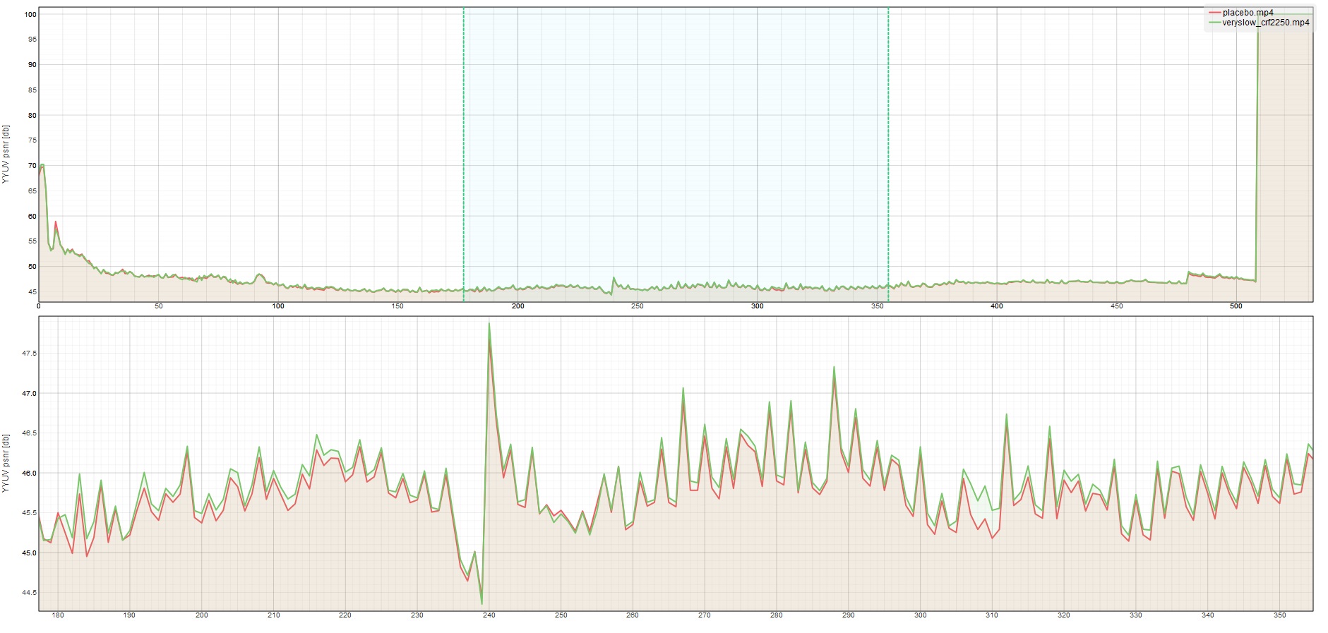

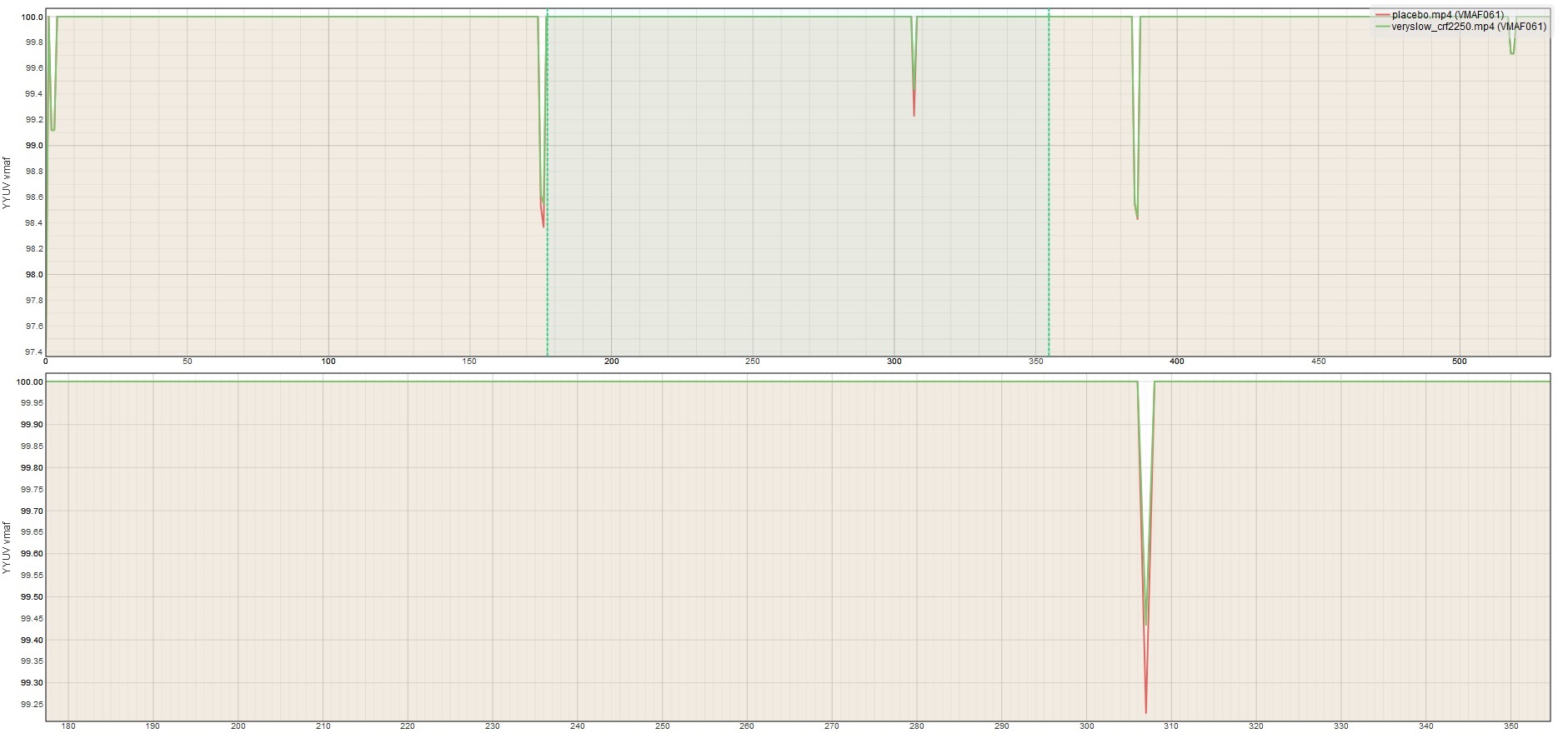

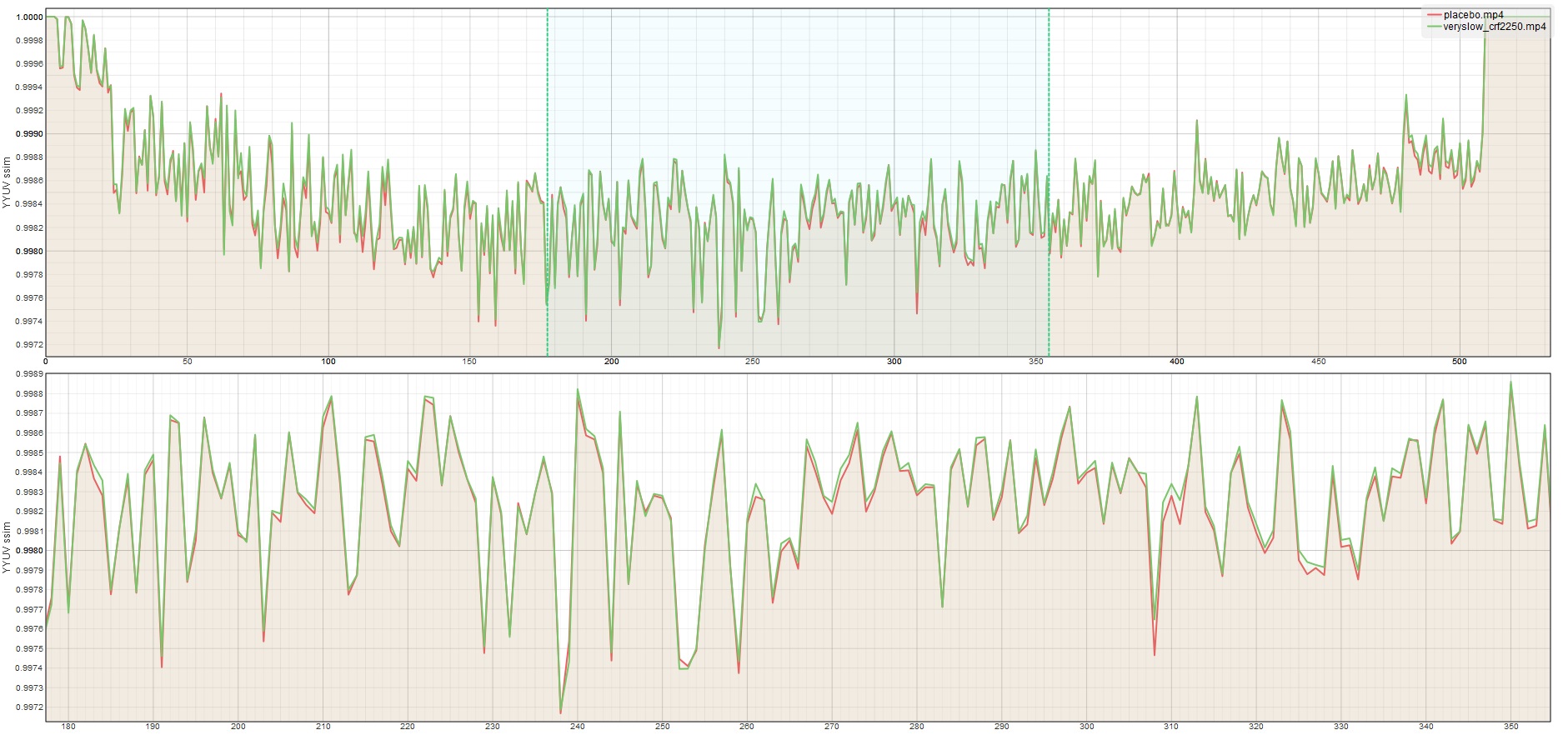

  3. So I've encoded one more time to achive the same bitrate with placebo and veryslow preset... this time I've changed CRF to 22.5 for veryslow preset so the bitrate now is 2330 for placebo and 2333 for veryslow, 3 bps is no big deal, right?
    And compared both video to original using PSNR, SSIM, VMAF and VMQ techniques of MSU VQMT
    Results below:
    PSNR

    VMAF
    [Attachment 48073 - Click to enlarge]

    So does that mean that in case of this particular video it is better to encode with veryslow preset and CRF 22.5 than placebo with 23.0 ?
  4. Maybe marginally worse for placebo, but those results are probably not statistically significant on that test.
    The quality metrics don't necessarily have high correlation with human perception of "quality" or "similarity" . But if you check with your eyes and zoomed in , frame by frame, it's probably quite close too , right ? You might be able to pick up some part of a frame slightly better on one, but slightly worse on the other.
    What was the encoding time difference ? Probably not worth it

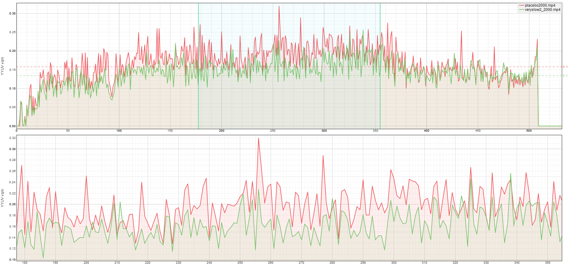

  22. I have to thank you for your perseverance... you forced me to make another couple of tests
    --preset veryslow --tune grain --pass 2 --bitrate XXXX --stats ".stats" --slow-firstpass
    vs
    --preset placebo --tune grain --pass 2 --bitrate XXXX --stats ".stats" --slow-firstpass
    I've compared 500, 1000, 2000, 3000 bitrate encodes and always "veryslow" has better VQM-metric test average values, PSNR and SSIM differences are negligible
    I just don't want to spam this message with bunch of graphs but here is 2000 VQM-result ( lower is better ):
    [Attachment 48241 - Click to enlarge]
    The results are almost the same on every test even 500
    So finally... I do not know why does "placebo" even exists =)
