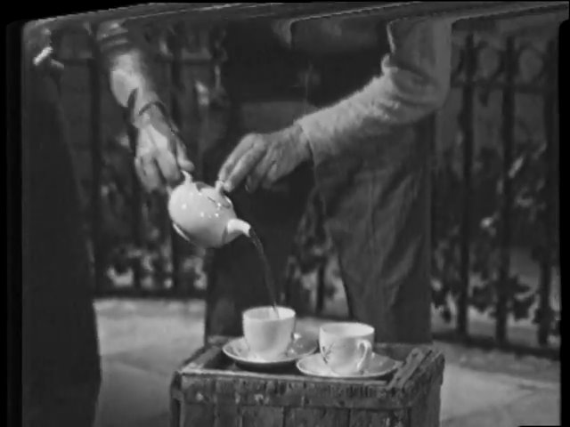

That is a great tool @rsnitsch. Are you able to create a tool that will focus on the top of the video. For those of us who don't have the original tape, I can't figure out how to correct such a problem. I think you have the right approach to this.
[Attachment 70832 - Click to enlarge] -
The best way is to mask it, Even if the lines are shifted back to their original position you will end up with a black triagle on the right side just like the one on the left side, You can't bring back what is missing.
Thanks @dellsam34, the top area is such a big chunk, I think it would be worth it. I thought I could correct it or partially correct it in premiere pro, but its too skewed
I think vhs-deshaker must be changed/extended in two ways before it can be used for such a video:
- Most important: Add the possibility to change the colRange parameter. The colRange parameter basically limits how big the horizontal distortions can be. It is deliberately kept small by default because in my own videos the horizontal distortions were alternating like crazy (very bad shaking) but very small in terms of the shift. Currently there is no way of changing the parameter except recompiling the code yourself. I thought of adding a commandline option for that like --col-range <some-number>.
- Add the possibility to specify a vertical subrange of image rows to be fixed. First, the video will be processed much faster if analysis is restricted to the section at the top. Second, vhs-deshaker isn't perfect and sometimes can induce new shaking/distortions that weren't there in the original video. So it's best to not touch the bottom part of the video which looks pretty perfect to me.
I don't know when I will have the time for these changes. Is it possible that you send me a small clip of that video so I can test it? Maybe there are other changes that need to be made for it to work well... - Most important: Add the possibility to change the colRange parameter. The colRange parameter basically limits how big the horizontal distortions can be. It is deliberately kept small by default because in my own videos the horizontal distortions were alternating like crazy (very bad shaking) but very small in terms of the shift. Currently there is no way of changing the parameter except recompiling the code yourself. I thought of adding a commandline option for that like --col-range <some-number>.
Thank you for the quick reply. I'm attaching two sample videos. One I managed to almost fix perfectly with premiere pro, its wasn't skewed too badly, there is a before and after. The other one is extremely skewed on top.
https://youtu.be/6U9a0YyOVMI
https://youtu.be/450vIdqDJdM
https://youtu.be/2849o_T11WM -
out of curiosity, I focused on the top part of the video and I manually aligned multiple thin horizontal sections to see if there is a potential fix to such a problem. Just to get a general idea. If I was more careful in my cropping, perhaps thinner sections, I think it would be a cleaner image, it is just very tough to see what is being cropped when its only few pixels in size. The shaking left and right was the revelation to me. The top part of the video isn't entirely lost as before. @rsnitsch, I believe more and more that a solution is there to fix these type of tearing. Have you made any progress in your program?
https://youtu.be/DOAw8eHEh00
