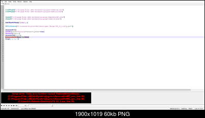

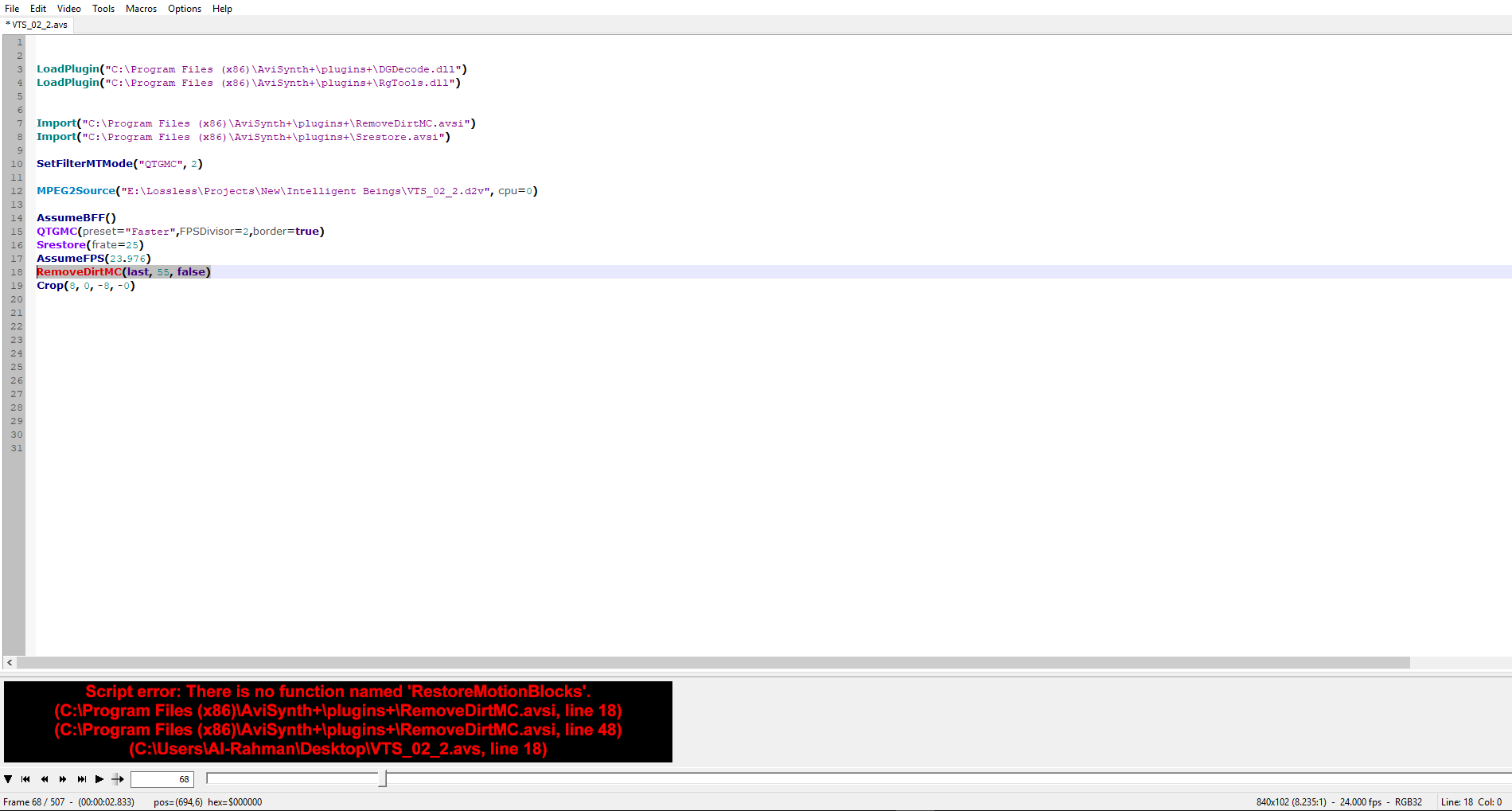

    I changed my old avisynth into Avisynth+(x86) 32Bit but I can't make RemoveDirtMc works on it, I tried both RemoveGrains (RemoveGrainSSE2,RemoveGrainTSSE2 and it keeps giving me this error message:

  4. What script?
    You need to also download and load RemoveDirt dll in your script.

  7. Originally Posted by TeNSoR View Post
    I have tried many RemoveDirt dll and the only one has worked "RemoveDirt_x64"
    Then you're using 64 bit AviSynth+, not 32 bit.

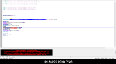

    Yes! luckily it works now but on plugin+ not plugin64+. Is there are other equivalent to RemoveDirtMC that works in plugin64+ because I want to use StaxRip and giving me error

  9. I have tried many RemoveDirt dll and the only one has worked "RemoveDirt_x64". I tried "RemoveDirt() but gives me error, any suggestion?
    RemoveDirtMC() is the script which uses RestoreMotionBlocks() function from the RemoveDirt.dll.
    If you wish to use the x64 version of AviSynth you'd also need to use the x64 version of RemoveDirt dll.
    And that error is for DGDecode.dll not RemoveDirt.

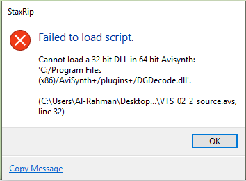

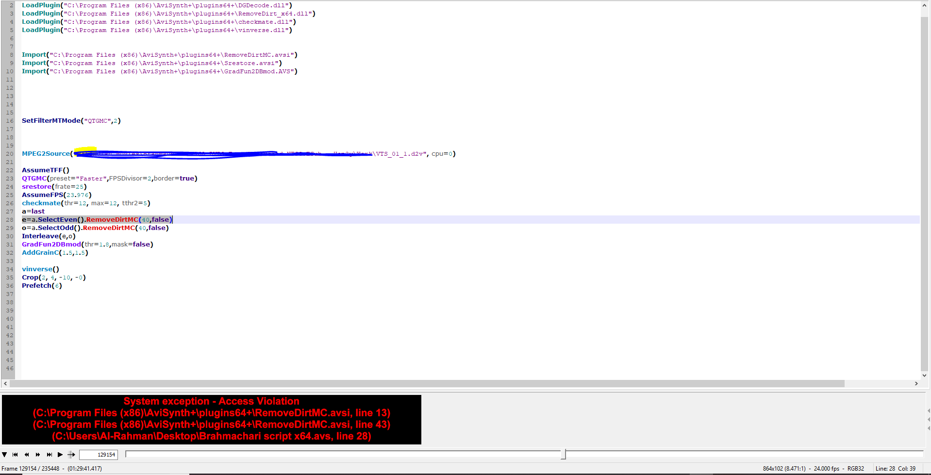

    Still after I put the DGDecode dll and RemoveDirtMC AVS I'm getting this error message:

  14. Yep. As far as I can tell RemoveDirt_x64.dll doesn't work with 64 bit AviSynth+. It probably doesn't even work with 64 bit AviSynth 2.6. It's an old AviSynth 2.5 dll that was never updated.
