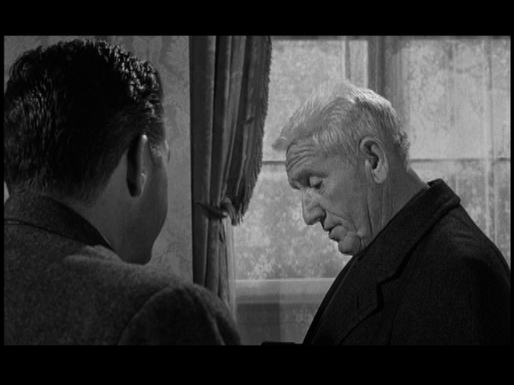

    I mean 16x9 content encoded within a 4x3 file. Like a lot of old MGM DVDs of films, the US release of the first season of House, the Australian release of the third season of The West Wing, etc. So it plays windowboxed on a 16x9 screen.

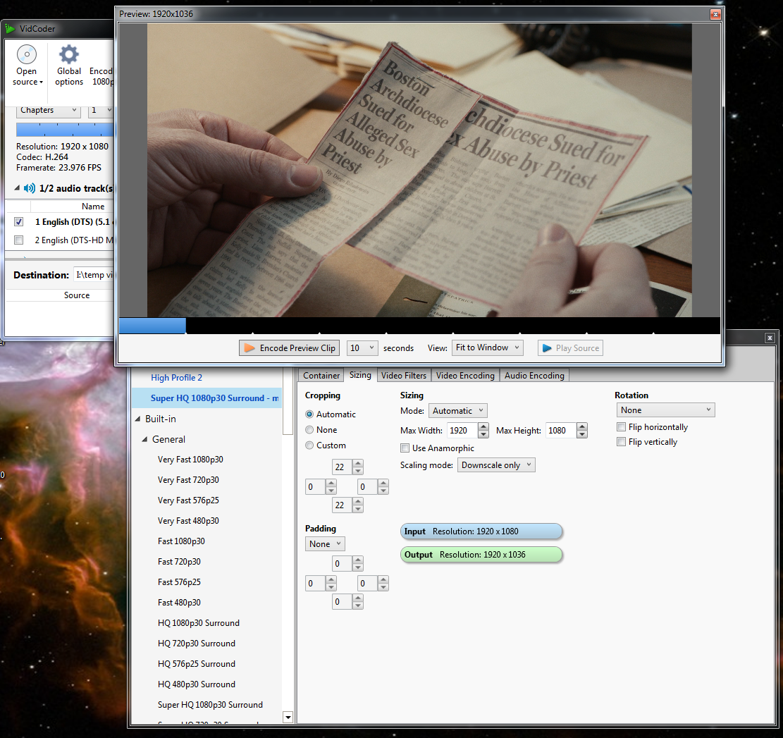

  16. aBigMeanie aedipuss's Avatar
    Oct 2005
    666th portal
    i'd use vidcoder for an easy way to do it. it has a manual crop mode and preview to adjust the crop if you don't like it's auto mode. allows passthrough of any audio you want or re-encoding. along with subs and chapters.
    [Attachment 48000 - Click to enlarge]

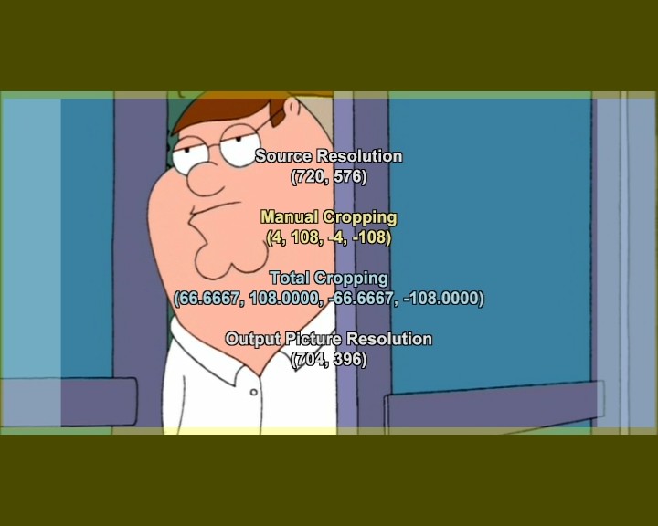

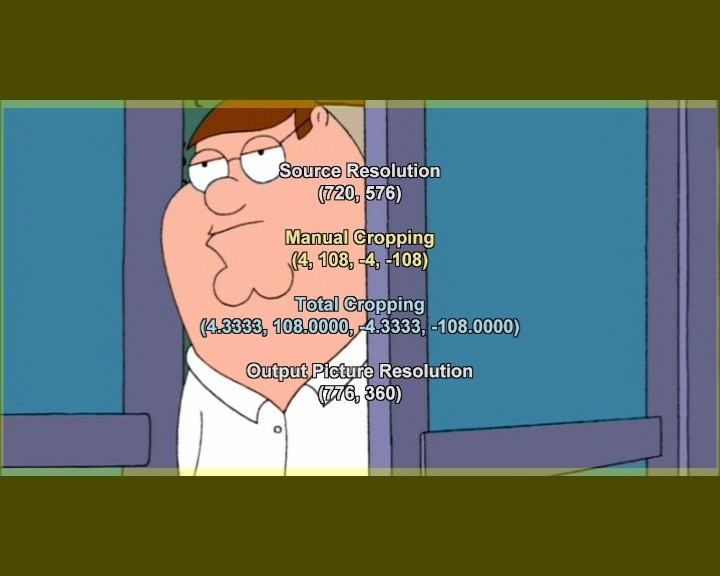

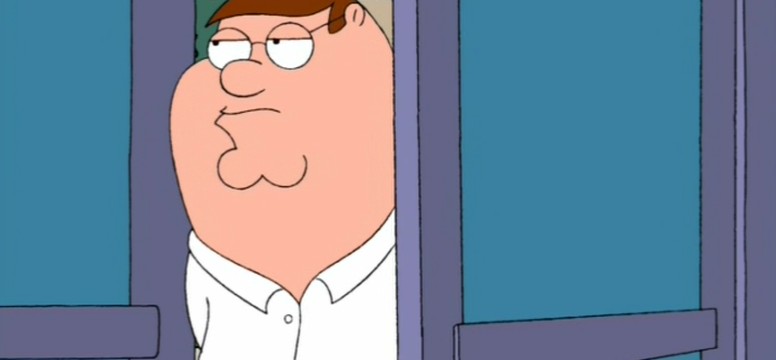

    I'm thinking this is an opportunity to shamelessly plug my CropResize script. CropResize 2018-03-17.zip
    The source I had handy wasn't a DVD, so I simulated a DVD with a widescreen picture by cropping 100 pixels from the top and bottom, adding 100 pixel borders, and resizing to PAL DVD dimensions. Hopefully _Al_'s brain won't melt. It's just a demo.
    By default, the script resizes to square pixel dimensions. You can disable resizing if you prefer an anamorphic output.
    The first screenshot shows the script with the cropping preview enabled. There's no need to specify any resizing (you can use zero for the width and height). You only need to specify the desired cropping and the input display aspect ratio and the script will do the rest. For the first screenshot below, the yellow overlay shows the specified cropping.
    I'll probably get into trouble for taking liberties...., but I regularly use the script to crop and zoom to 16:9. All you need to do is specify a 16:9 width and height. I don't crop to 16:9 for video I'm archiving, just for temporary copies.
    Screenshot two shows how the video will be cropped and resized when just cropping the black. The equivalent of Crop(4,108,-4,-108) for this example (extra height cropping to make the yellow overlay for the preview more obvious).
    Screenshot three shows the cropping preview after telling the script to output 16:9 dimensions (704x396). It'll do exactly what you tell it to, but it crops the picture to the same aspect ratio as the output (16:9 in this case) so as not to distort it. Unless you specifically want to crop to a certain aspect ratio, it's usually better to only specify the output width and let the script take care of the height. That way, you won't accidentally crop lots of picture by specifying the wrong dimensions. The light blue overlay in screenshot three (left and right sides) is the extra cropping the script applied to achieve 16:9 dimensions. The cropped and resized result is the fourth screenshot.
