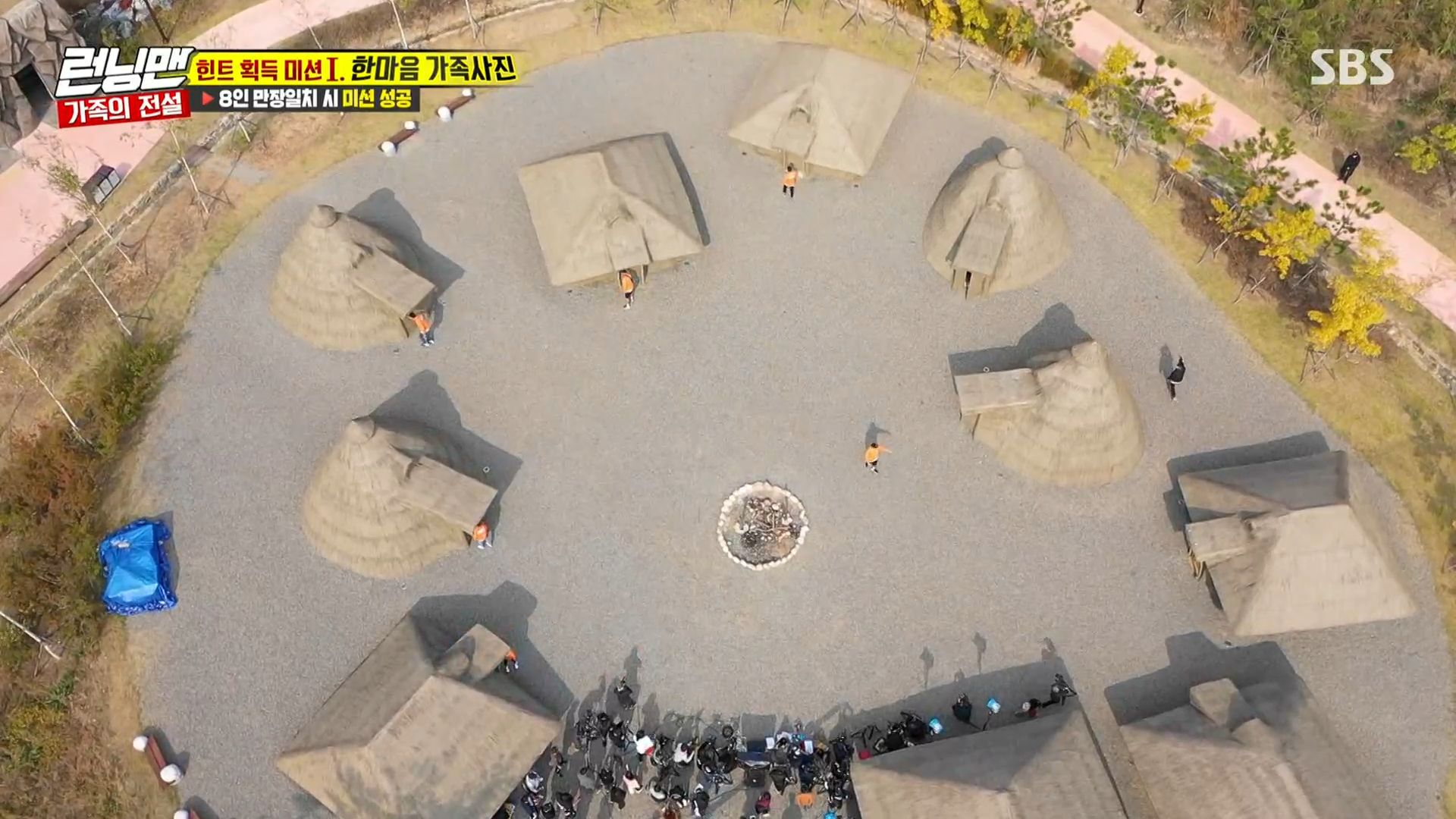

As I stated, some of my favorite Korean variety shows display a brightly colored logo like this on the top left.
[Attachment 47968 - Click to enlarge]
After a 1 1/2 hour episode, the logo on the right is faintly there, but the logo on the left is clearly there especially on light colored scenes such as sky. I didn't notice it at first, but once I did it bothers me if I watch something else after.
I don't blame my plasma as the logo is way too large and bright, but watching it on my 40" LCD is fine for most of my viewing. It's a prime example of how not to do logos, but pretty prevalent in Korean and some Japanese shows.
