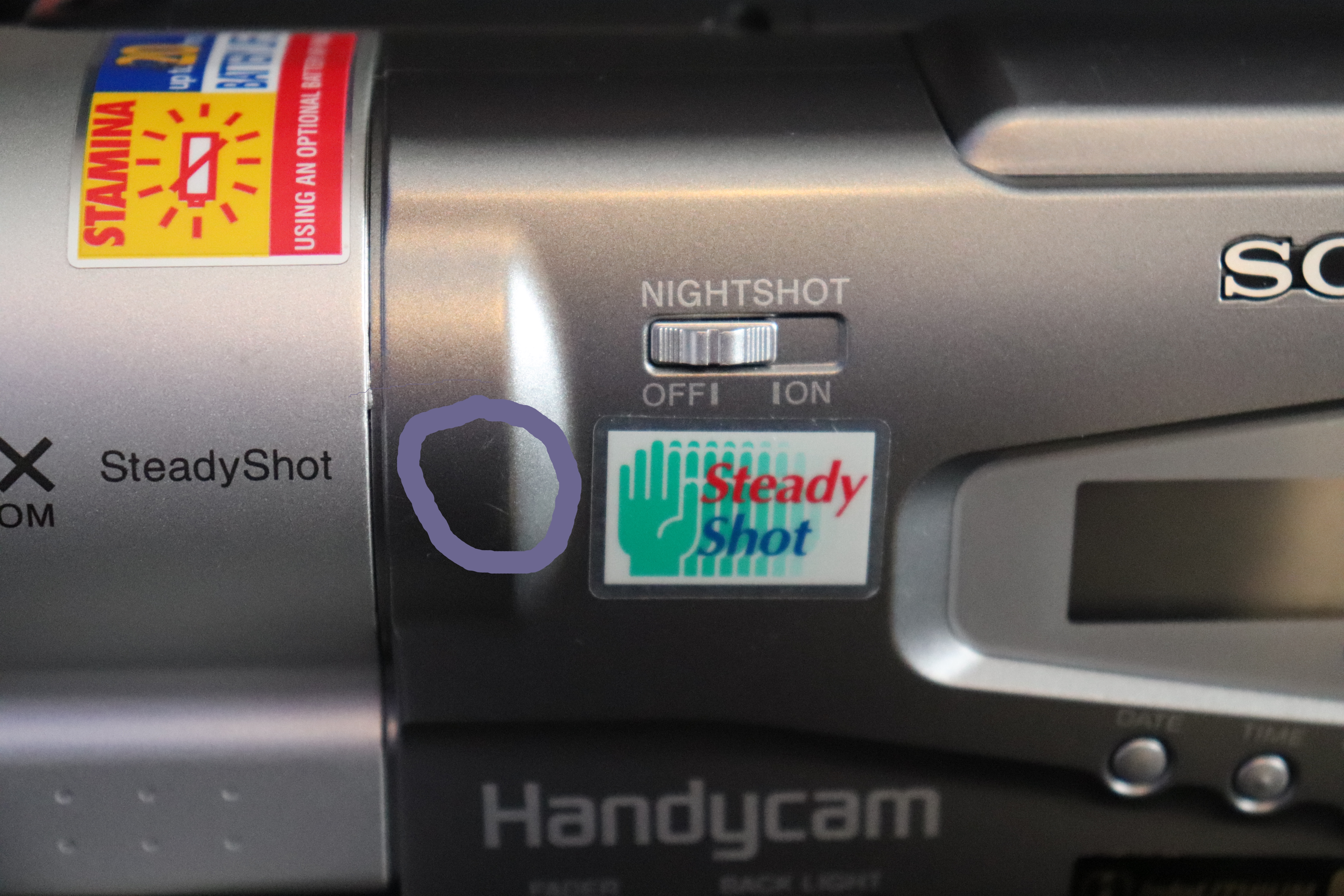

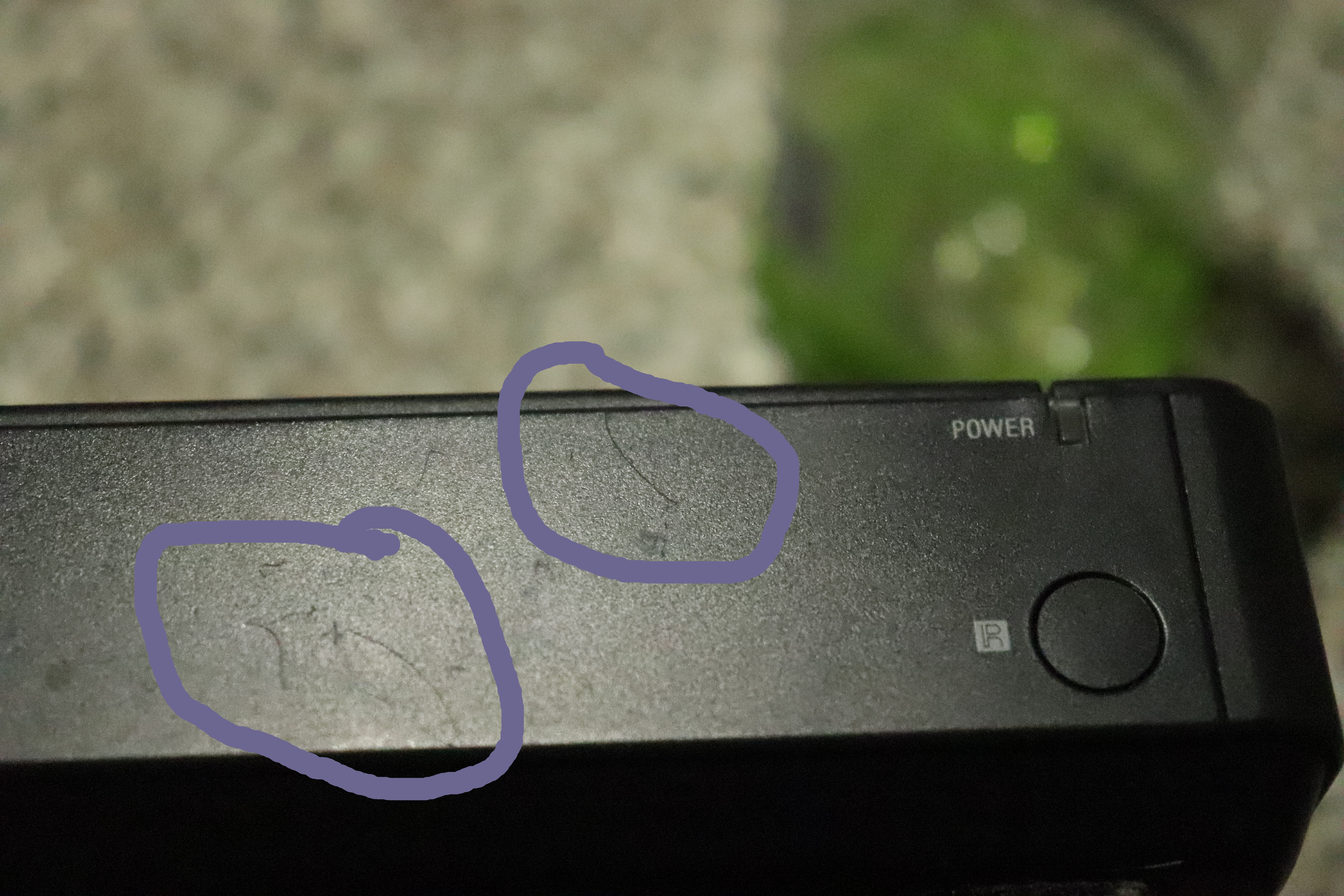

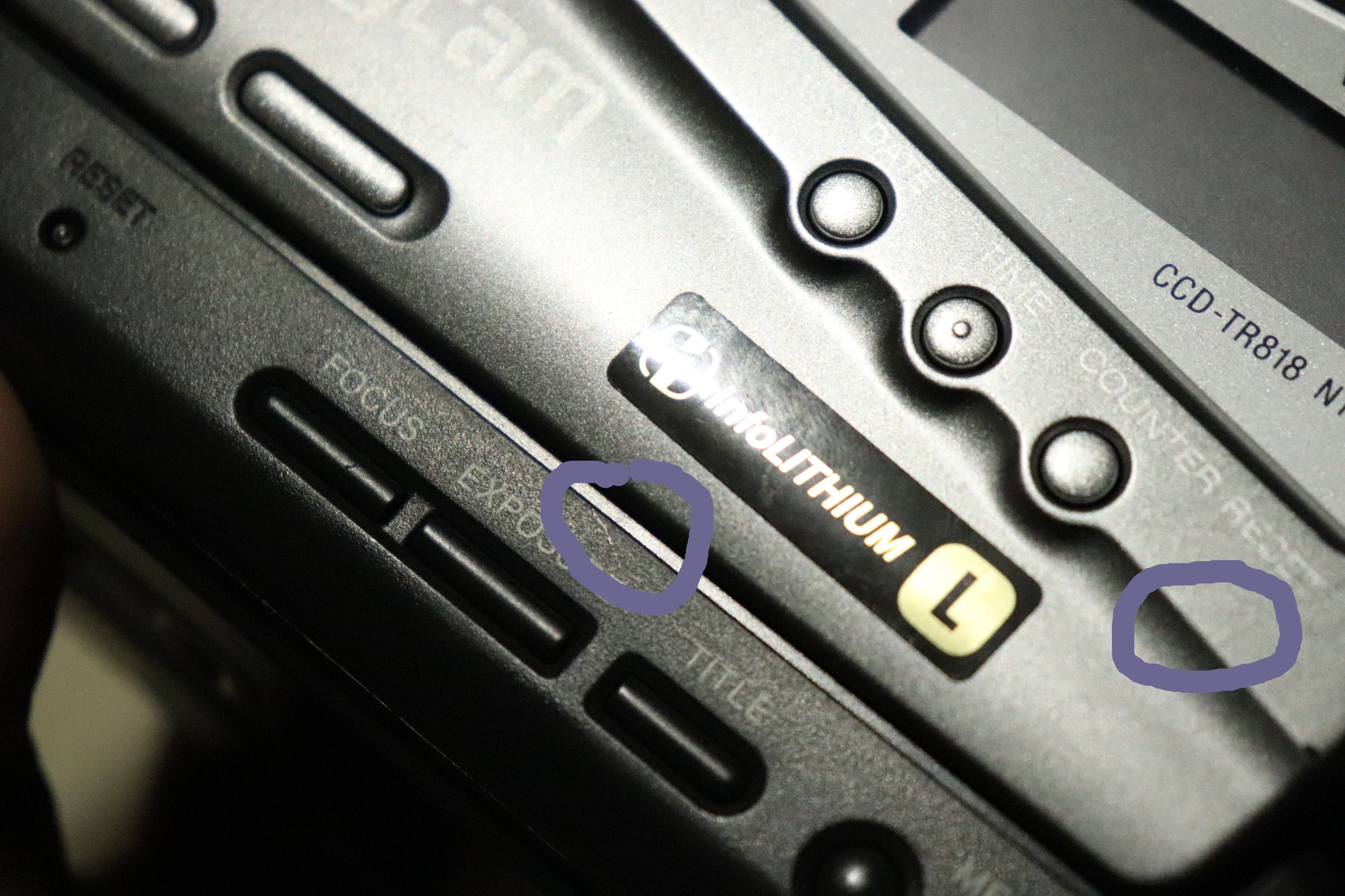

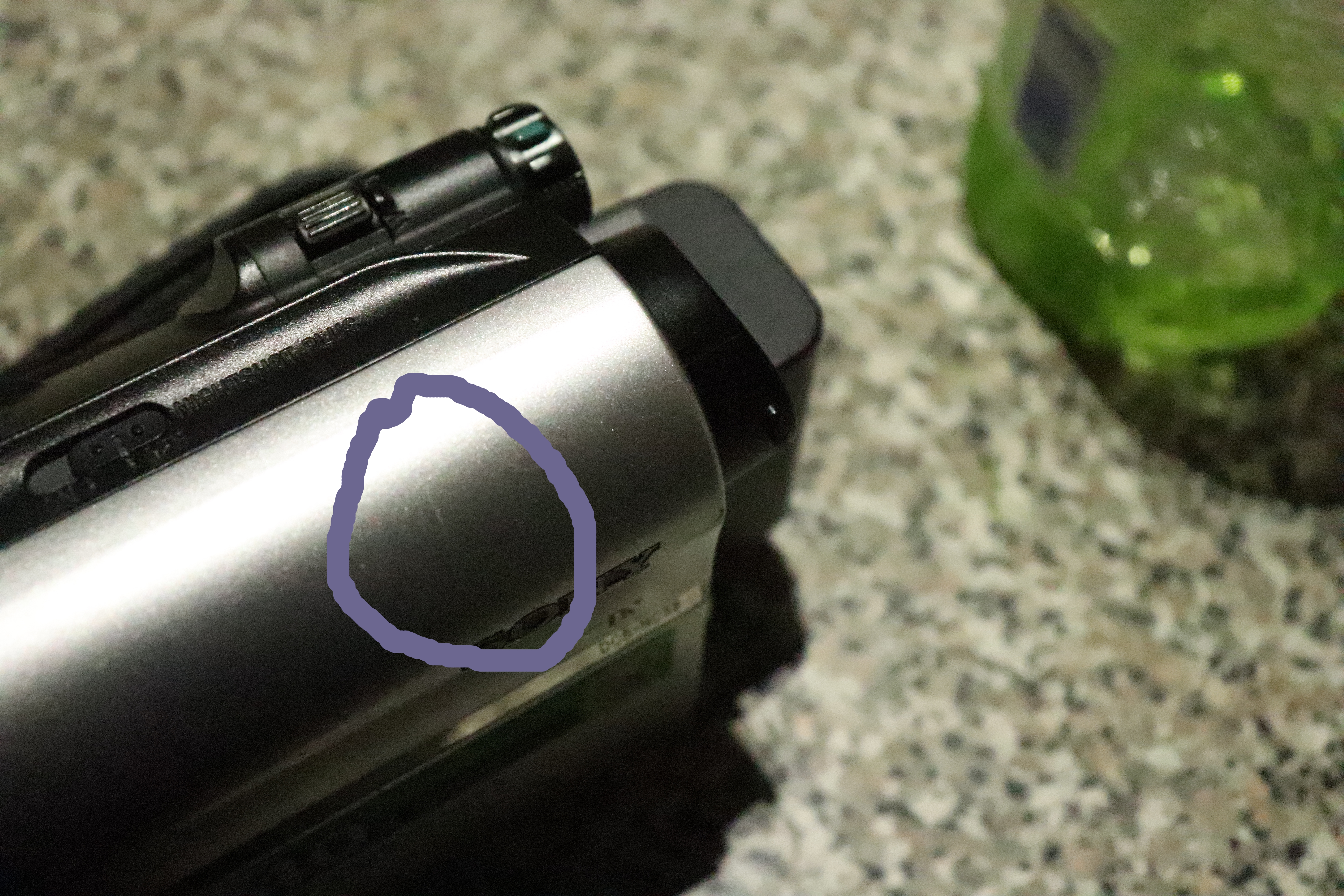

I have a few Sony Handycams/VCRs that I got for free, but there's a few scratches. Is there any way to polish or buff these to have reduce or remove the scratch?

	Plastic polish. Be advised that if you use it on painted parts, you will have to repaint them. Those shiny silver parts are painted.
	You have to take the part off to know for sure if it's painted. Use plain old spray paint.
	Try a hobby shop. You're unlikely to find an exact match. But if you spray the whole part, you will have to restore the decals/silkscreens. Why go to all this trouble??
	Krylon makes paint that can adhere to most cleaned plastic surfaces, but I doubt you would find a exact color match.
 You might have to blend several colors, then brush it on with an artist brush, thinned with the correct liquid thinner..
 You could also look to paint for plastic 'toy' models, though it may not wear well.
 I would probably live with the scratches and not risk the possible damage to the surface of the camcorder.
 Yes, you could use masking tape, blue or green type may seal the edges better than the cheap stuff.
	But then you will have a little mismatched stripe of color that will draw as much attention to itself as the scratch.
	To match colors you need first to decontaminate the surface with melamine foam + water ONLY (this is how we did at Sony), be aware that the melamine foam remove silk screen markings and everything else, including body paint:
 And only after that you'll mix up your own paint to match the colors using spectrophotometry and for that you need a spectrophotometer, your best option is to Google for "match car colors", find a company to sell you the paint and type of pain you need.
 This need to be done by a professional by the anyway.
 That markings can be removed away by heat, hot press and other techniques that I'm not disclosing any of it because people learn this over 10 to 15 years of practice and can't be compacted in a "10 easy steps" how to.
 Good luck.
