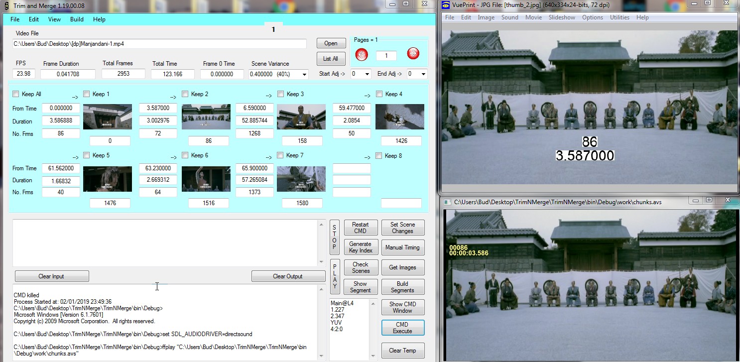

For this reason I am attempting to write a GUI that cuts only at I-Frame after finding them from a general area of cut. It will play the segment with frame and DTS times embedded or display the first frame as JPG to make sure the preceding segment ends prior to the next I-Frame. The resulting video contains only the frames asked for.
It has no time line, cut point flags, can only do several segment at a time but it has preview, corrects DTS to 0.00000 even if original does not start there.
It is slow, buggy and I have no idea how it will handle an h265 video since I do not have any currently. It does what I need by cutting only at I-frame, for the length that I need and does NO recoding at all. Turning it into a 'Smart' cutter will be the next task after making sure bugs and H.265 videos are covered... if I live long enough. LOL
[Attachment 47957 - Click to enlarge] -
