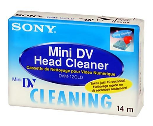

    there was also a problem long ago with different tape manufacturers using wet or dry lubes on the tapes. after using a tape with liquid graphite lube if you switched to a tape with powdered graphite lube you could end up with clogging heads.
    the sony minidv tape cleaner used to be an ok one. hard to find now but some still available on amazon.
