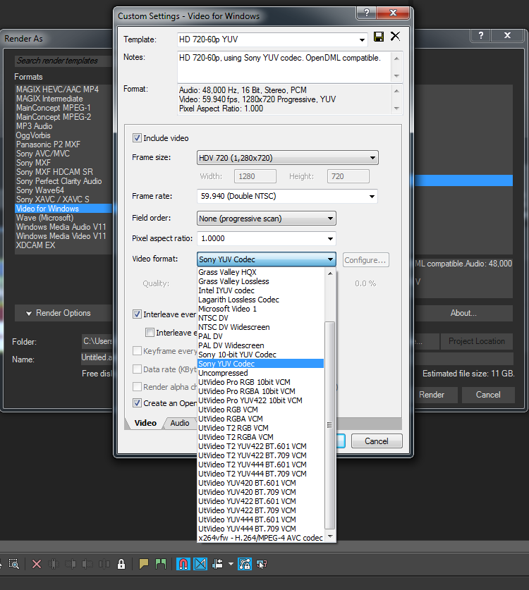

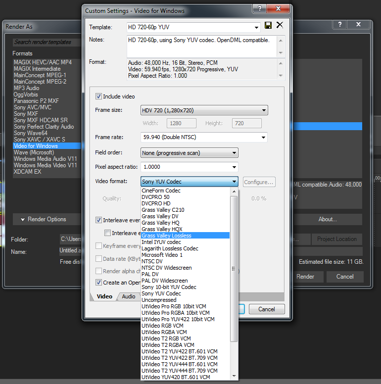

    why use cineform? it's only visually lossless unlike lagarith, huffyuv or utvideo.
    if vegas can use it and it's installed on your computer it will show up in vegas "video for windows" render as codecs. you can encode to it from within vegas.
    [Attachment 47929 - Click to enlarge]

    oops sorry the slider had moved
    [Attachment 47930 - Click to enlarge]
