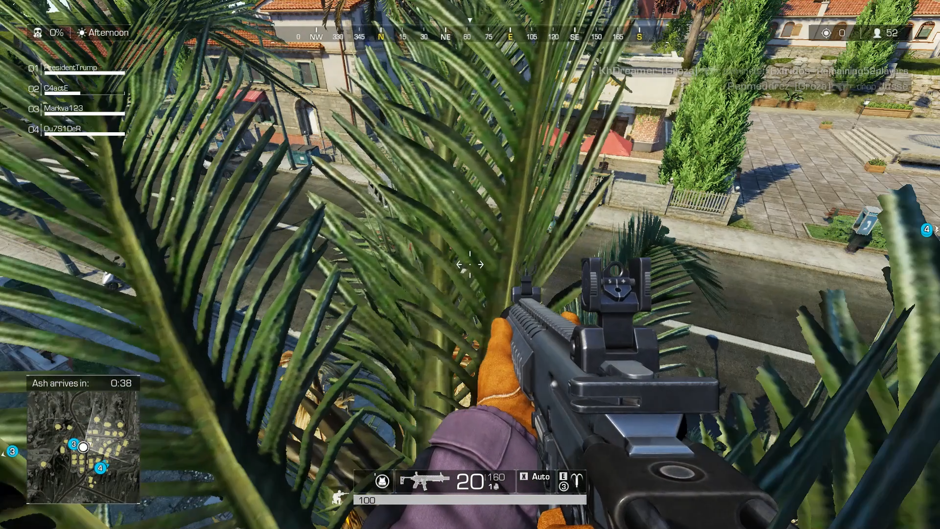

  7. Hell I used to believe the same thing.
    Have a look. PNG format
    The weapons sight and the brick pattern on the building wall scream the difference.
Name:	ROE AK and palm CRF 18.png
Name:	ROE AK and palm CQP 24 NVENC from CQP 18.png
  8. Source
Name:	ROE AK and palm original.png
  9. Dinosaur Supervisor KarMa's Avatar
    Jul 2015
    US
    I don't really like to compare single frames as a representation of the entire video, but even the single frames makes x264 look better. Mostly by retaining more of the high frequency detail, such as the purple coat coving the wrist and the orange glove to the stone tile detail to the top right. High frequency content is going to be the first to go with lossy compression, and x264 manages to retain more.
  10. Originally Posted by KarMa View Post
    ^this
    Did you look at any other frames ? e.g. this might be an I-frame vs. B-frame comparison
    Maybe post samples of the actual videos
    Some parts of the frame look better, some worse.
    Look at the entire picture. KarMa pointed out the glove, and arm cloth textures and tile details differences - but street pavement textures look significantly worse with nvenc as the details are blurred away .
    Easy to blur details away with any encoder - for example , you can denoise or apply a blur. But retaining details is much more difficult
  11. Originally Posted by KarMa View Post
    You're right but still the sight and the brick pattern still retained more detail on NVENC
