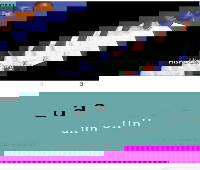

How can I encode mp4 video such that it plays ok on Mac, iOS, Android and win?
This one plays ok on win and Android but messes up on Mac.
[Attachment 47926 - Click to enlarge]

I have one video file that works on both MacBooks and one (see screenshot at the top of this thread) that only works on one of my MacBooks. I did a MediaInfo export on each file... can you see what may be causing the one to not work on both MacBooks?
This one does NOT work on all

Are the 2 MacBooks different models? Maybe one with AMD GPU and the other not and somehow the HW H.264 decoding is messing up? The MediaInfo logs don't show anything inherently "wrong" with either file except maybe that it's very small and the resolution is a bit uncommon. Maybe it's possible to deactivate HW H.264 decoding or update GPU driver or something like that (I'm not a Mac user). You can try to encode to more common resolutions (e.g. 1280x720) to be more compatible with devices but ultimately it is impossible to encode something that will work on every device because of these kind of device bugs. -
Yeah, maybe.
@BobAchgill
Is the file 108 KiB on all your computers/devices or is it maybe corrupted after all? Same hash (CRC32, MD5, SHA1 ...)?
