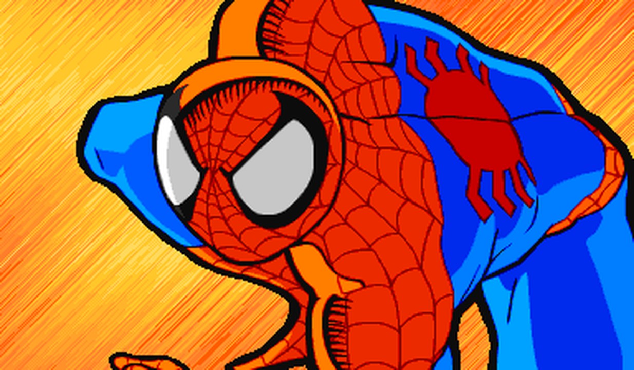

MARVEL Super Hero vs Street Fighter(point)(720p)
MARVEL Super Hero vs Street Fighter(nnedi3)(720p)Code:PointResize(960, 720) TemporalSoften(13, 14, 18, scenechange=15, mode=2)
MARVEL Super Hero vs Street Fighter(bilinear)(720p)Code:nnedi3_rpow2(2, cshift="Spline36Resize", fwidth=960, fheight=720) aWarpSharp(depth=5) Sharpen(0.2)
MARVEL Super Hero vs Street Fighter(bicubic)(720p)Code:BilinearResize(960, 720) Sharpen(0.8)
MARVEL Super Hero vs Street Fighter(VEnhancer)(720p)Code:BicubicResize(960, 720) Sharpen(0.8)
Just selected the 960x720. -
