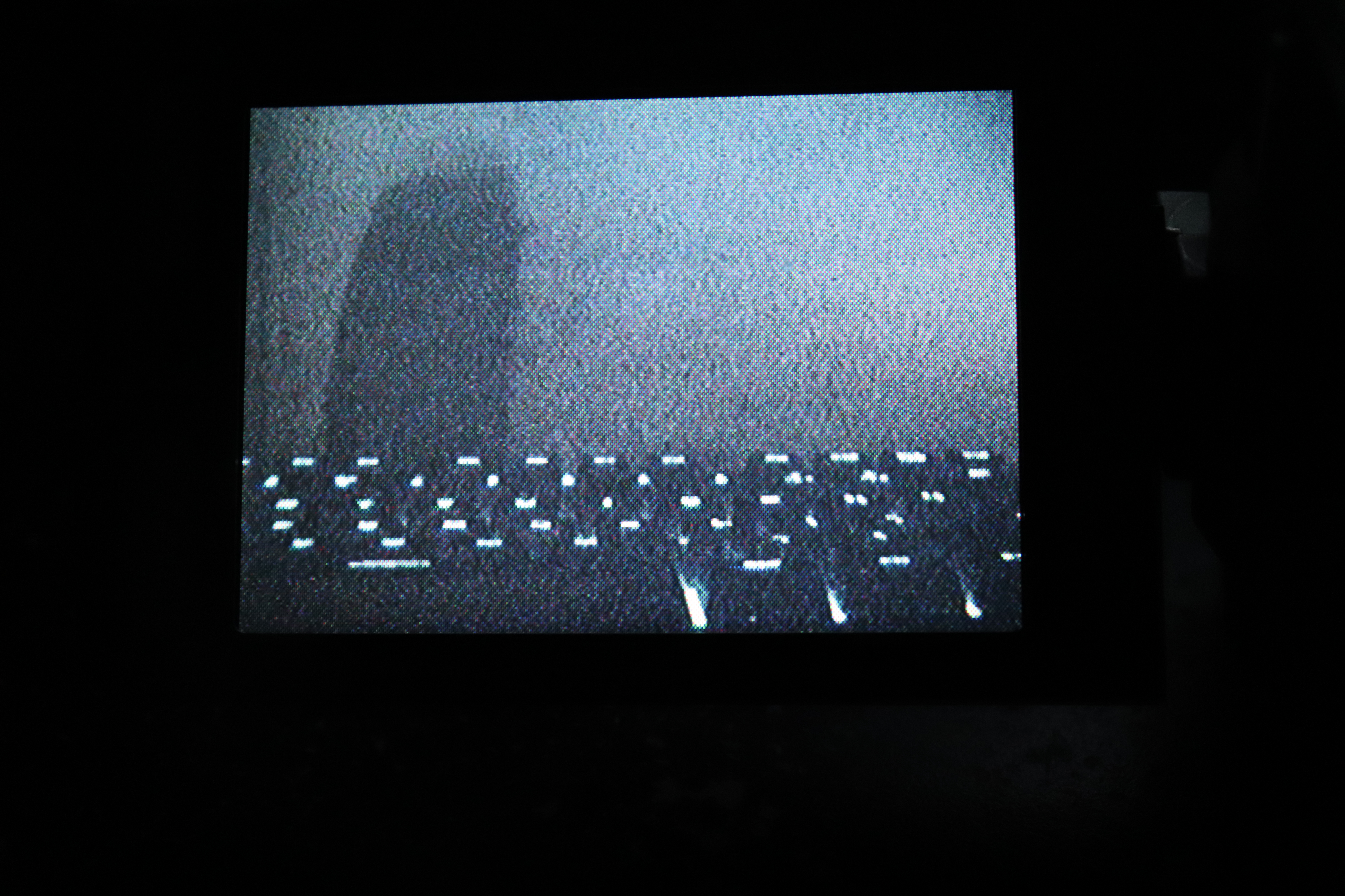

  1. Yeah. My Digital8 camcorder got dropped about 1-2 feet onto carpet. I don't seem to see any defeats, as I managed to record some footage and play it back with no problems. But I'm afraid there could be unknown damage. I shook it and there's no loose parts. The only issue I have is when I turn on Super Nightshot, there's a lot of judder and low FPS. Normal Nightshot doesn't have this. What should I try and do?
    Edit: The Super NS judder is normal

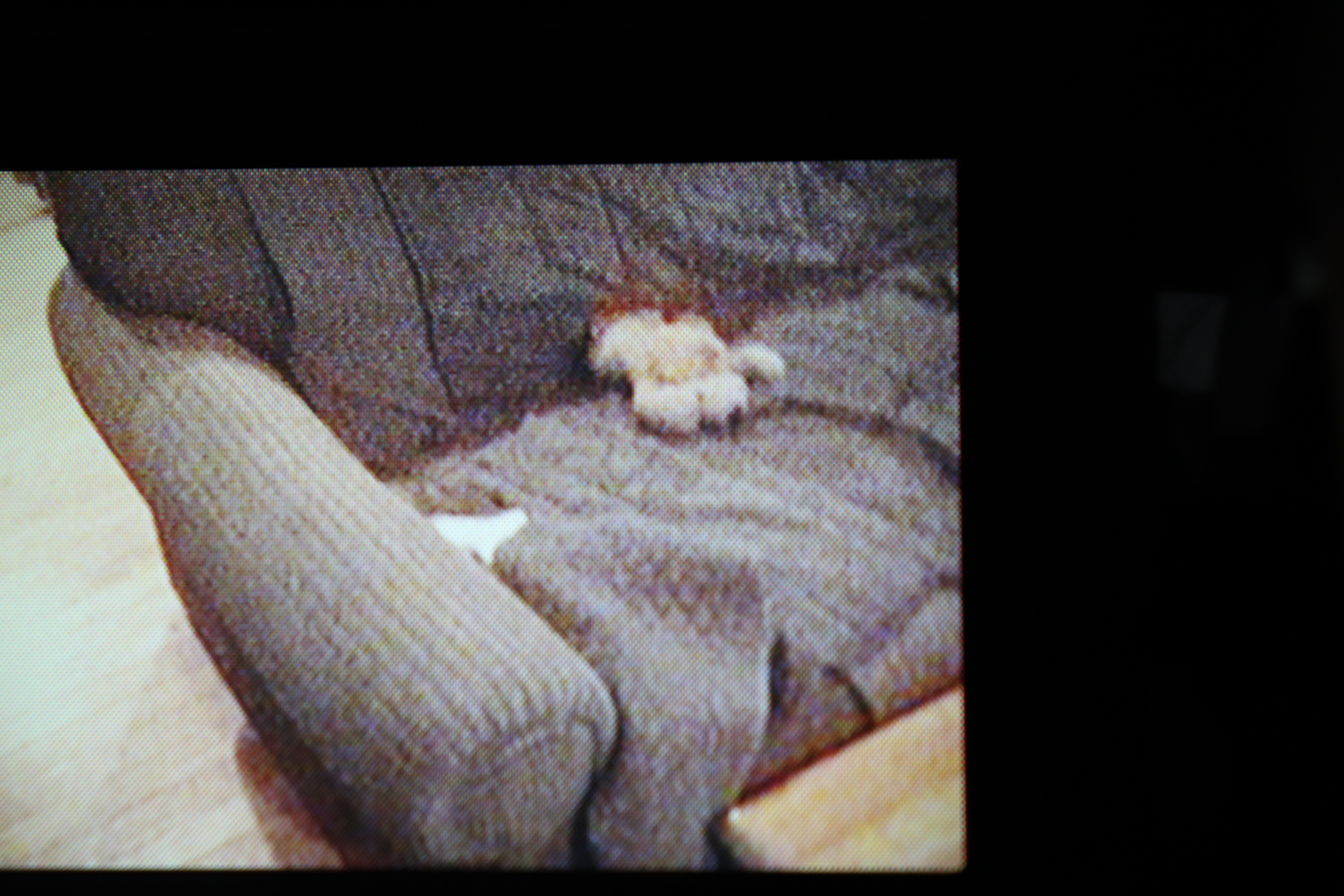

    Here are some pics of some "supposed defects":
    Ghosting effects:
    [Attachment 47907 - Click to enlarge]
    Strange "flash" that happens for 1 frame when I hit record.
    [Attachment 47908 - Click to enlarge]

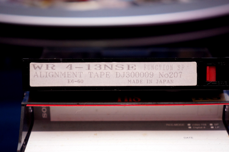

    They can be aligned, but you need proper tools and correct information to do it, along with a special alignment tape. This tape is not sold in the market, this is Sony "internal use only" material.

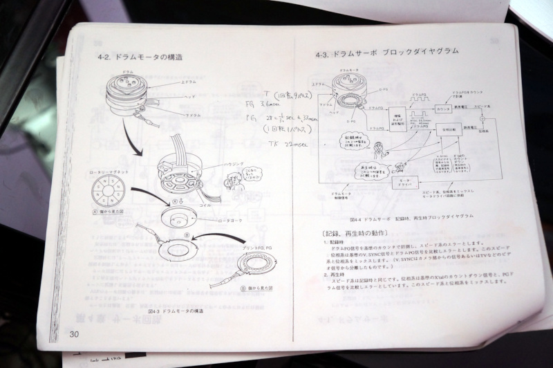

    I was one of the guys responsible to develop and record this tapes at Sony with a special device. I have developed my digital version of this tape some time ago.

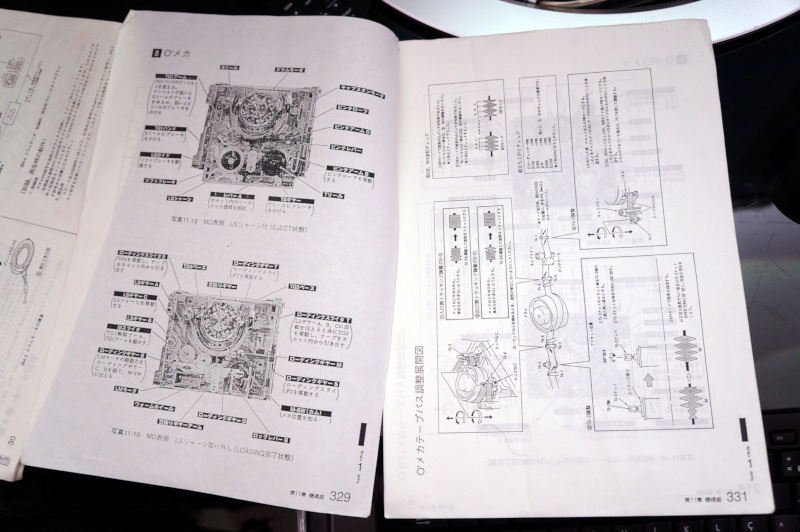

    At this pages you can see the alignment procedure for "O" Type mecha(you can see the Oメカ at the top left page), "O Mecha" or "meka" are the ones used by Video 8, Digital8, etc.
    Once you set the camera in service mode for infinite playback using the RM-95 to do the alignment with the alignment tape inside (page 0, address 01, data 01 / page D, address 10, data 02 + PAUSE), then as you can see on the right, you can procedure with the proper alignment, this includes normal playback and fast forward/rewind to check the signal stability. At the image you can see the correct waveform for fast forward/rewind signal at the bottom right, the bottom signal is bad and the top one is good.
    Some of the tape guides are glued because they come aligned from the manufactor, other are locked by small screws at the back of the tape guides. When alignment is needed, all the "TG's"(Tape guides) need to be replaced, adjusted and glued back with a special red glue.

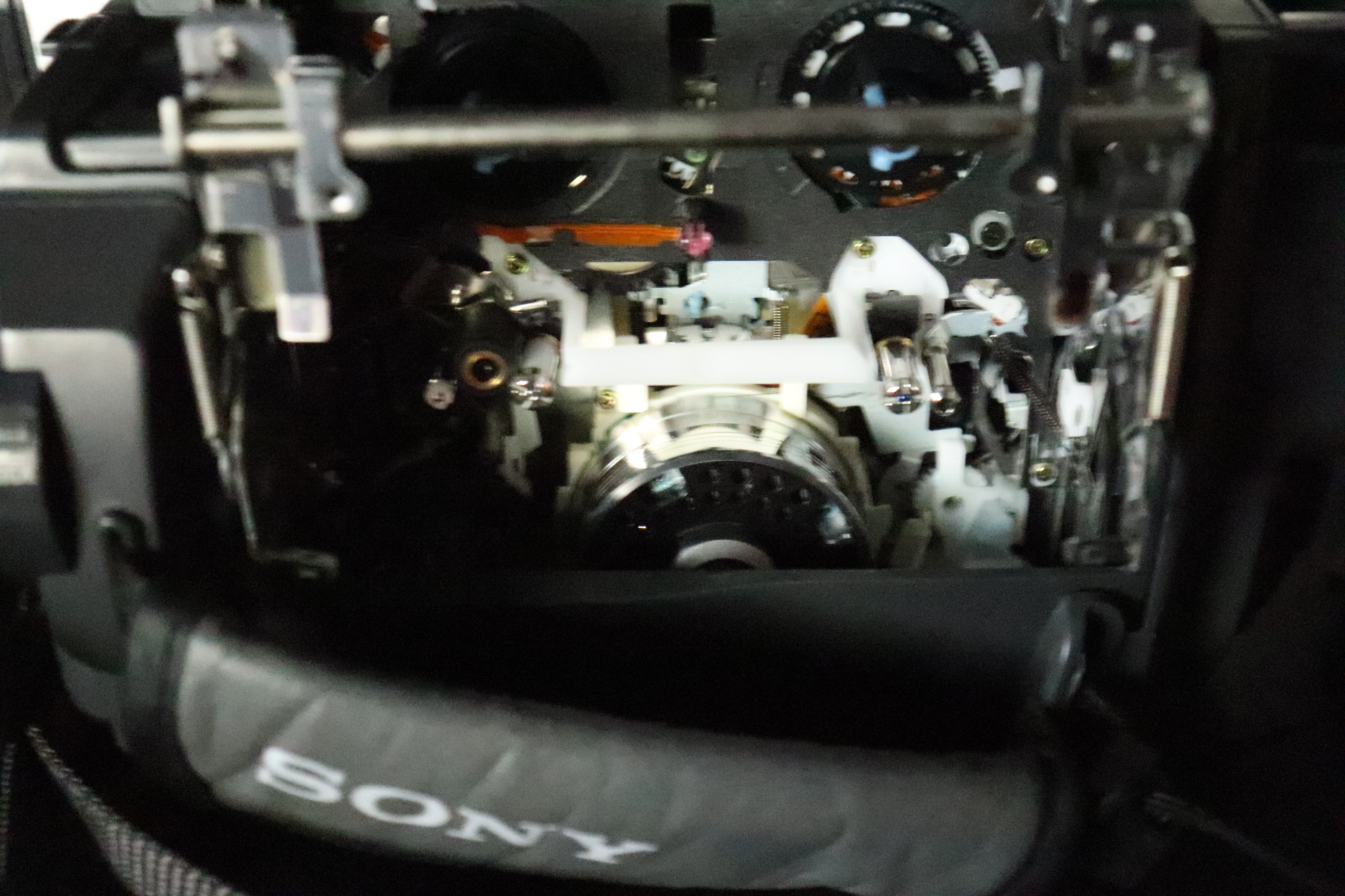

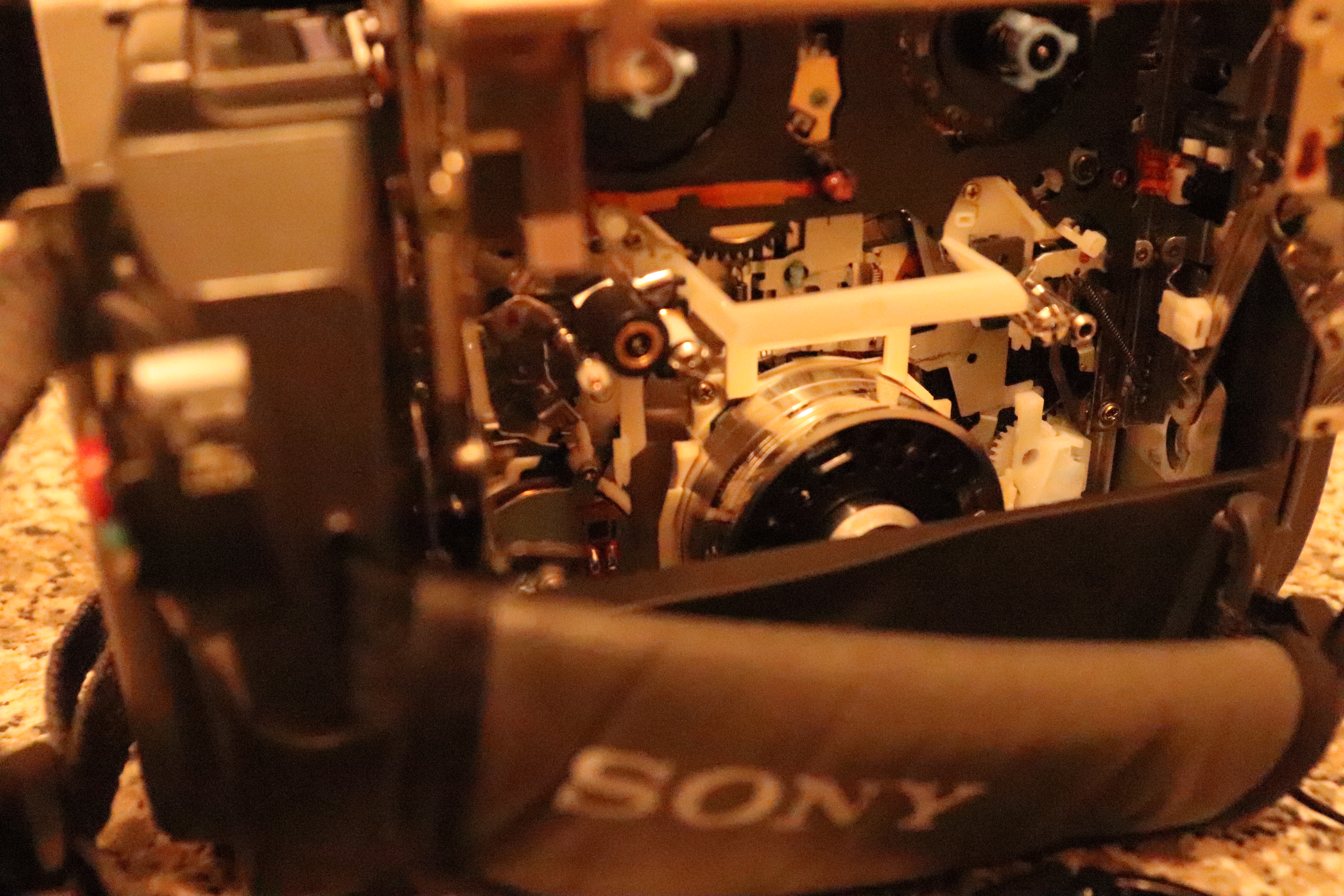

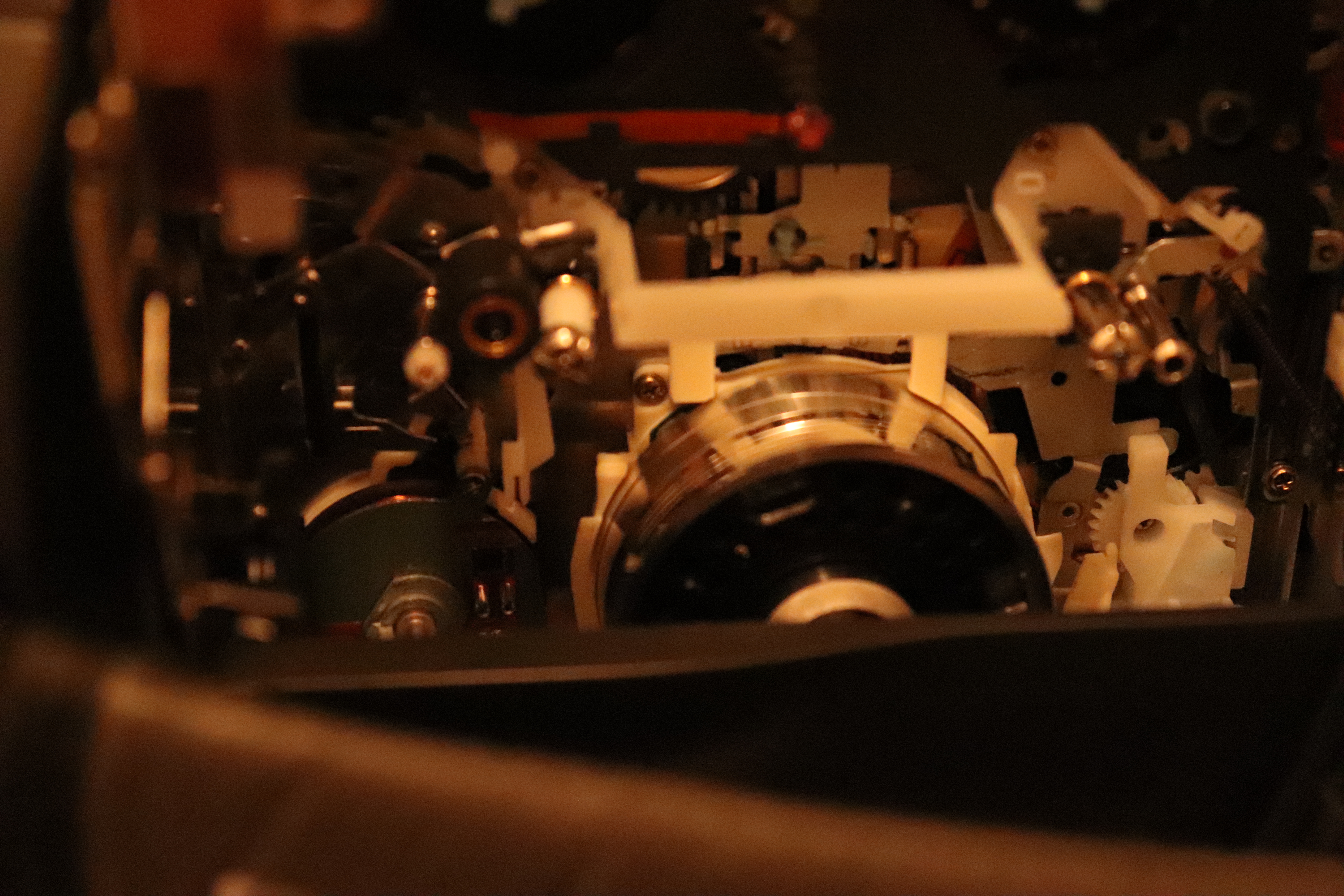

    [Attachment 47916 - Click to enlarge]
    [Attachment 47919 - Click to enlarge]
    [Attachment 47918 - Click to enlarge]
    Here are some high-quality (24.2MP) photos of the head drum. I'm not a pro at photos so IDK how much detail there is and if it's useful. Would the repair cost less than $160? Because I can get a new Digital8 camcorder for that price. Also, I managed to record and playback a tape after it dropped, it was like a few hours later it started with the blue screen.
  11. I'm really sorry for you, I don't know how much a service like this might cost to you, I don't live in America.
    I can't evaluate this kind of damage from the internet, this is not how repair works. I need to take your camera apart and with an oscilloscope mesure the main signals, then I can understand if the drum is OK, if the TG's are in the correct place or not, etc, etc. The symptoms you describe sound like the tape guides are loose or lost alignment, hard to tell but if you keep trying to play a tape with the deck in this condition, you can make a possible simple solution to a really expensive one, stop playing any tape on it, send it to a service center.
    You see that small metal spheres on the top of the drum?
    Those are to keep your drum in balance, as you dropped, you might have lost one or more, this is why I'm telling you, there is nothing you can do to fix this and playing tapes on it can make things worse.
    Send it over to a service center that works specific with this types of cameras or brand.
  12. Originally Posted by amaipaipai View Post
    So don't touch it and just send it to that place you mentioned? Ok

    Now I'm getting a signal from the tape. Sometimes it shows the "lines", so not perfect, but the audio is fine.

    I think I got it working! I ran a normal Hi8/Digital8 "mix tape" (it has analog and digital signals on it) for about 1-2 hours. Eventually the picture starting coming, and now it's clear. I haven't seen any glitching, no "blue screen" issues. The audio is fine quality and it will play analog tapes too. There's no glitching/etc.
    Aug 2010
    San Francisco, California
    My hypothesis is that dropping the cam jarred loose some gunk which made its way to the video heads. Running a tape for 2 hours polished off the gunk. This frequently works with scanning heads. Wouldn't be a bad idea to clean the transport, though. There may be more debris waiting in the wings.
    Another possibility is that during the long play, some guide that was knocked out of position reseated itself. If that's the case, it may go out again.
