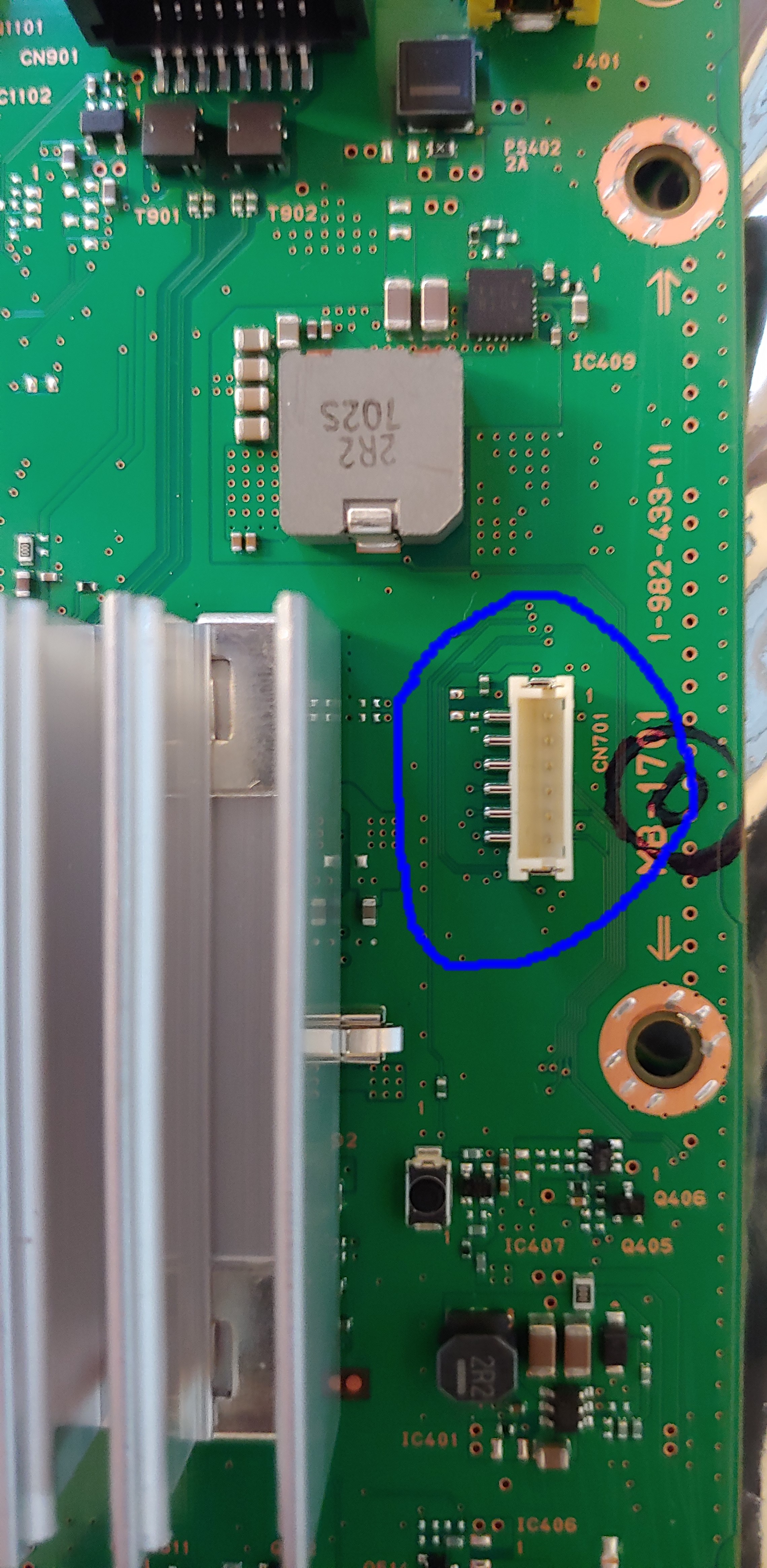

    I need help identifying the connector on the Sony UBP-X700 motherboard.
    I would like to find out the name/type of connector it is. I'm trying to modify the player and soldering would be my last option, reason why I would like to get it.
    This is a 6 pin male connector, I'm looking for the female connector.
    Any help will be much appreciated.
    Thank you all in advance.
    [Attachment 47903 - Click to enlarge]
    [Attachment 47904 - Click to enlarge]

  3. Thank you, misterbill.
    I did Google it as you suggested but unfortunately nothing that comes up matches this particular connector.
    I even tried typing CN701 but that didn't help either.
    Thanks again.

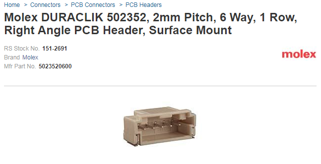

    you need to take it to a component distributor and see if they can match it. i'd guess it's a molex connector also they makes thousands of different part numbers so picking one from a picture is impossible. but this is similar but mounts differently.
    [Attachment 47911 - Click to enlarge]
  5. Thanks, aedipuss.
    It's being hard finding the female connector, although the picture you posted look very similar to one on the board.

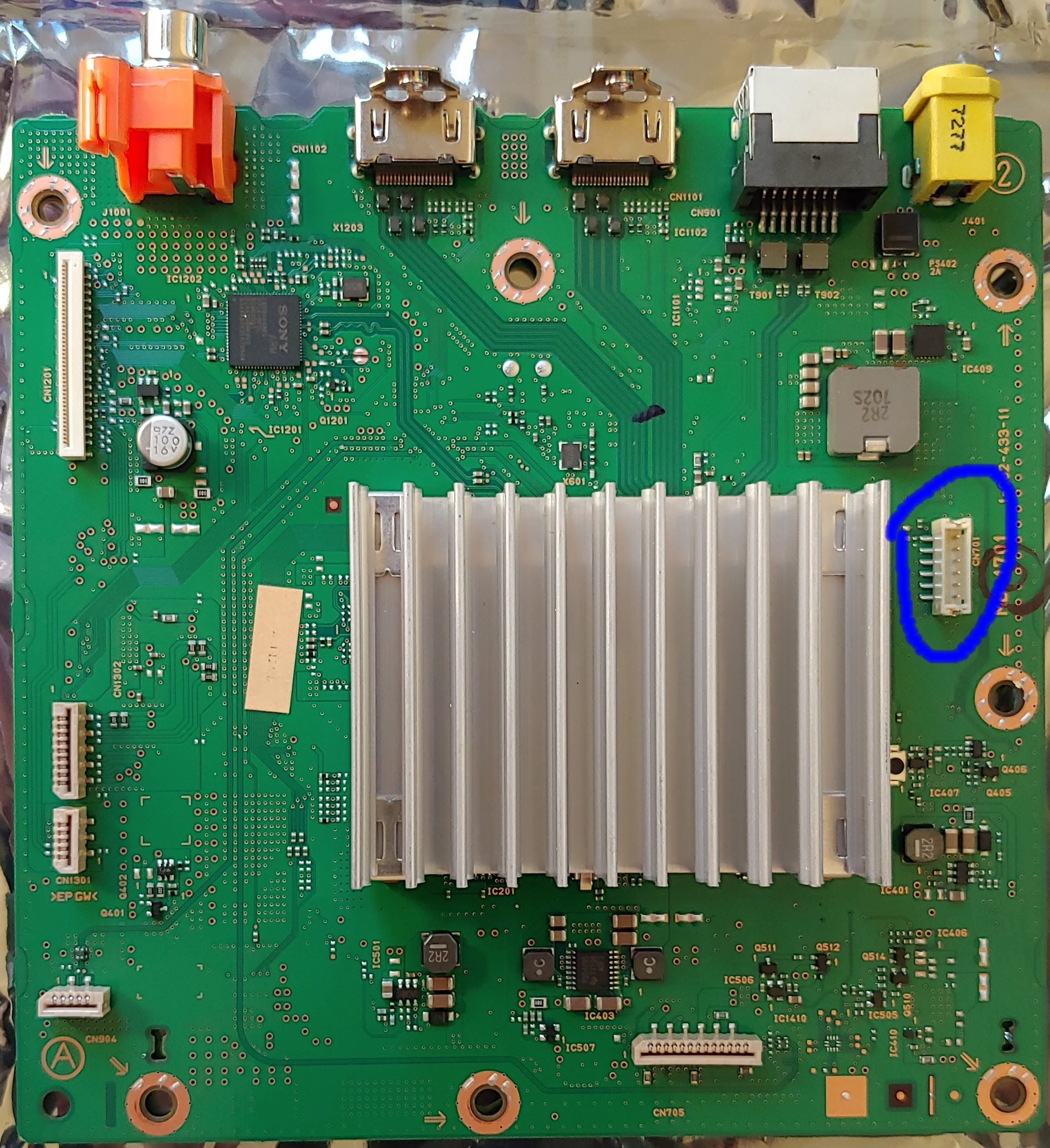

  8. This connector is for diagnosis of the Player.
    The pins I know are:
    1 -> ??
    2 -> GND
    3 -> Rx
    4 -> Tx
    5 -> 3.3v
    6 -> ??
    You can use a usb-ttl cable to connect the player to your PC. MTKtools app.
    But I tried to read part of the nand and it is not possible. With other players, no problem for read.
    I also don't have a decrypted sony firmware to be able to do an update via usb-ttl.
