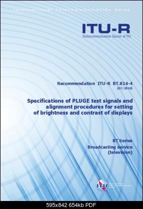

    I'm trying to say that those three vertical bars on left looks like under black, black, just over black for example -2.5IRE,0IRE,+2.5IRE IMHO without touching anything and with correctly set NTSC US you should see only 1 vertical bar +2.5IRE. If you start removing pedestal after capture then you will loose some quality.
    Below example of Pluge signal definition - i think you need to search for description of "your" Pluge signal.
    check also https://en.wikipedia.org/wiki/Picture_line-up_generation_equipment
    Perhaps SMPTE Pluge will fit your pattern

    Can I ask how you know the one pluge that you should see has a IRE value of +2.5?
    According to the Video Essentials laserdisc, the left pluge should be even with the black background in the SMPTE pattern, and same goes with "a pluge signal as viewed on a monitor". I'm just eye-balling the slider adjustment.
    Thanks for the ITU link.

    Have no idea but this can be measured - i don't know if NTSC PLUGE standard definition exist as i've saw various PLUGE from +-5IRE to +-2.5IRE, wiki says about PLUGE +-4IRE
    IMHO PLUGE idea is 3 level waveform to quickly adjust capture range - level lower than black (this is possible only in US NTSC where 7.5IRE pedestal exist) then black and then gray just above of black. Now it is tricky to say how properly setup your system - you should see things darker than black or not?
    If your decoder remove pedestal automatically then you should not see things darker than black...
