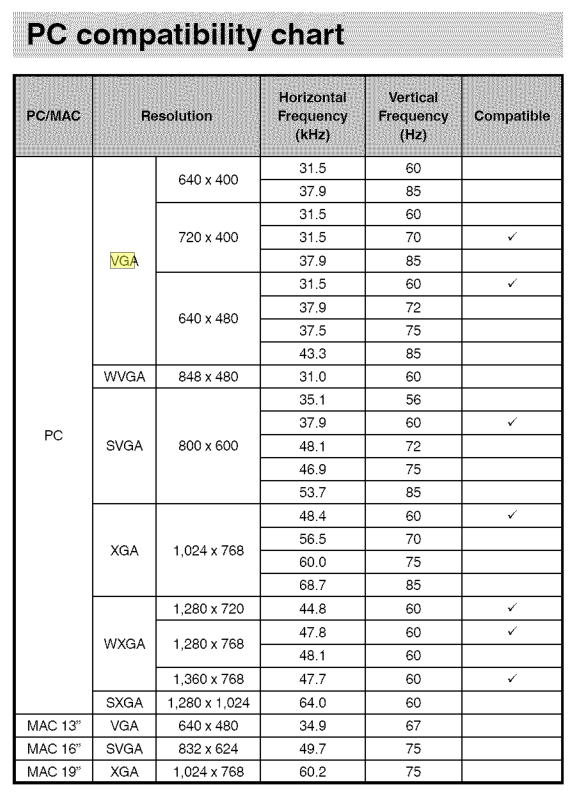

  12. You must configure the computer to output a resolution and refresh rate supported by the TV. From the manual:
    [Attachment 47874 - Click to enlarge]
    For example, the typical PC resolution of 1920x1080 at 60 Hz is not supported by that TV.
    Dec 2005
    Oh, so I should try all of the different Res options to see which one works?
  14. Member Cornucopia's Avatar
    Yes, work your way down from highest to lowest rez.
    Aug 2006
    I suggested 1360 x 768 because it's the closet supported resolution to the TV's native resolution (1366 x 768). You would also choose 60Hz as the refresh rate. I don't have your TV, but in the past, I successfully connected two different 720p TVs to a computer via their VGA port using that very same resolution and refresh rate.

    Doesn't work guys. Started from the max 1440x900 and worked down to 800x600 on both Inputs 4 and 5.

    The PC/laptop screen may not support all the same resolutions that the TV's VGA connection supports. You should extend your desktop to use the TV as a second display during your tests. The second display can then be set to a different resolution than the PC/ laptop screen. 1440 x 900 is not listed as a supported resolution in the chart for your TV. Restrict your tests to resolutions and refresh rates in the posted chart with a check mark in the supported column and set the TV to Input 5. There are two pages in the manual that you linked to which say Input 5 should be used for the VGA connection, pages 24 and 36. I am certain that Sharp tech support was incorrect to tell you to use Input 4 for VGA.
