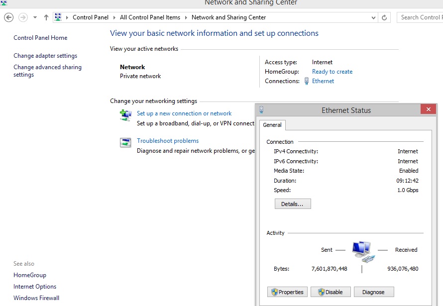

    Open control panel/network and sharing click on ethernet,
    it will show the connected speed

    Mar 2004
    It says 1 GB.
    Mar 2004
    Why is my network lying to me? LOL!
    Mar 2008
    Well at least that shows the laptop connected to that router has negotiated gigabit speed,
    sounds like the problem is upstream from the router
