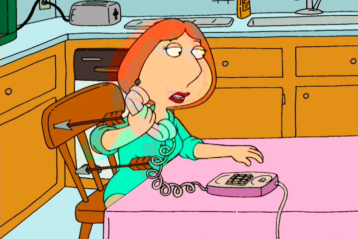

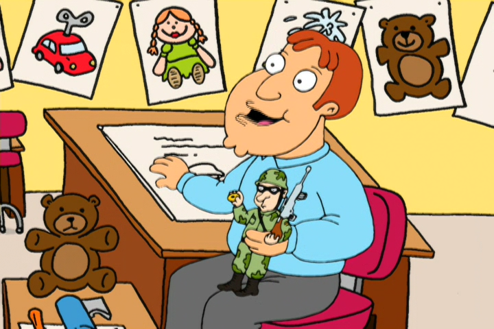

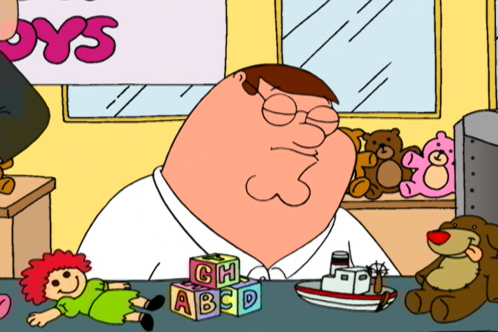

My code:
I use TDeint to deinterlace and SRestore to bring the framerate back to 23.976 instead of 59.940. However there is a weird line effect that isn't preset in the source but in the encode. I would say this is because the source is a mix of hard and soft telecine and this part is only soft-telecined, and TDeint is trying to deinterlace a progressive source.Code:MPEG2Source("%source_file%") TDeint(mode=1, mtnmode=3, blim=100) LoadPlugin("J:\StaxRip-x64-2.0.0.0\Apps\Plugins\AVS\GRunT\GRunT.dll") Import("J:\StaxRip-x64-2.0.0.0\Apps\Srestore.avsi") Srestore(frate=23.976) KNLMeansCL(D = 1, A = 1, h = 4, device_type="auto") DeHalo_alpha_mt(rx=2.0, ry=2.0, darkstr=1.0, brightstr=1.0, lowsens=50, highsens=50, ss=1.5)
VOB:
Deinterlaced and IVTC'd video:

Zoom in, it's very faint:
Isn't this interlaced YV12 being treated as progressive YV12 or vise versa? The source VOB claims to be Progressive scan in MediaInfo, but it has the 2:3 Pulldown flags. It's mix of hard and soft telecine. This scene at the toy factory seems to be hard telecined.Last edited by Vitality; 14th Jan 2019 at 10:00.

OK so it seems the actual ghosting is part of the actual stream. I watched the VOB with a deinterlace filter (MPC-HC, hardware deinterlace), but when you watch it raw it just looks like interlacing lines.
Is there anywhere to remove the chroma bleed? And if the deinterlace filter is causing the chrome bleed, could I hook up my DVD player over composite/S-Video into my Digital8 camcorder and stream the "raw" NTSC signal to my PC over DV-AVI?Last edited by Vitality; 14th Jan 2019 at 15:36.
All of this was covered in your previous thread.
https://forum.videohelp.com/threads/391643-Help-with-telecined-cartoon-that-has-combin...ues-on-encodes
The chroma of your video is screwed up in the source. The luma is screwed up in places too. Problems like this are quite common with cartoons because shots are often crudely time adjusted after being telecined. -

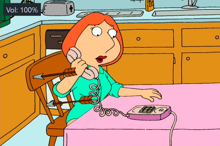

So I decided to give Handbrake a shot, and I used Handbrake's Decomb/Bob filter and the Detelecine one. Look at this:
The chroma bleed is almost completely gone. Now, how do i use these filters on AviSynth? HB is open source so it should be easy, right? Or are the Decomb/Detelecine filters already on AviSnyth? -
Handbrake has some good routines built into it. It's not a slouch. But anything they have is going to be outclassed by what's available for AVISynth. I just think you're not applying the filters in the correct way. TFM will do exactly what Deinterlace-Decomb does(deinterlace only the combed areas), but do it better and in higher quality. Use something like this:
