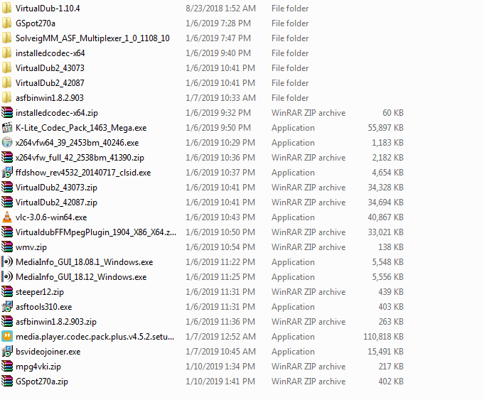

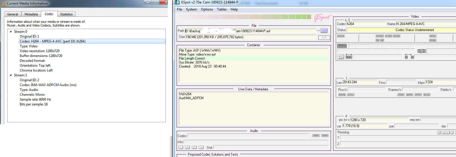

    I recorded files using my security ipcamera and it has created 2 asf files. Have tried everything possible to edit and open this files, but it only plays using plot player. I think it is not a codec problem, because its compressed with h.264. When i try to play using vlc, it only shows one frame and the audio keeps playing fine.
    I may found the problem: the 2 files are connecting each other (never saw this). The first video is named Cam-180823-104831-P.asf and has 1:00:11 and the second is named Cam-180823-114844-P.asf and has 00:20:42. When i open anyone of them on VLC, it only shows 1:00:11, no matter witch one i play.
    What i tried:
    VLC (shows one frame)
    Virtualdub (won´t open)
    megui (won´t work)
    Repair programs
    WMP (won´t work)
    Avidemux (won´t work)
    X media recode (won´t work)
    avisynth (won´t open)
    potplayer (working fine)

    Also try Asfbin ; it's in your screenshot, but you didn't put it in the list

  8. i stalled VirtualDub-MPEG224586 (had tried a lot of other versions) and could open the file!! Thank you guys for your help.
