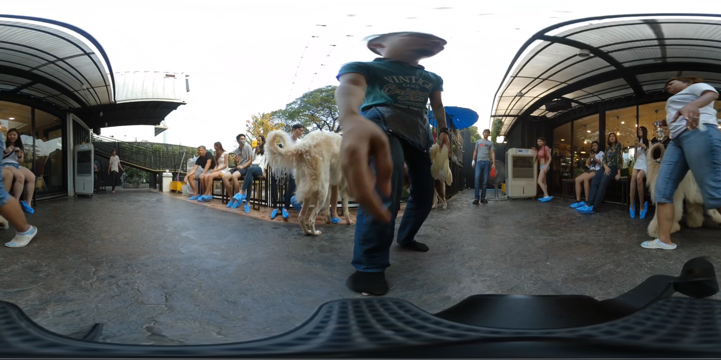

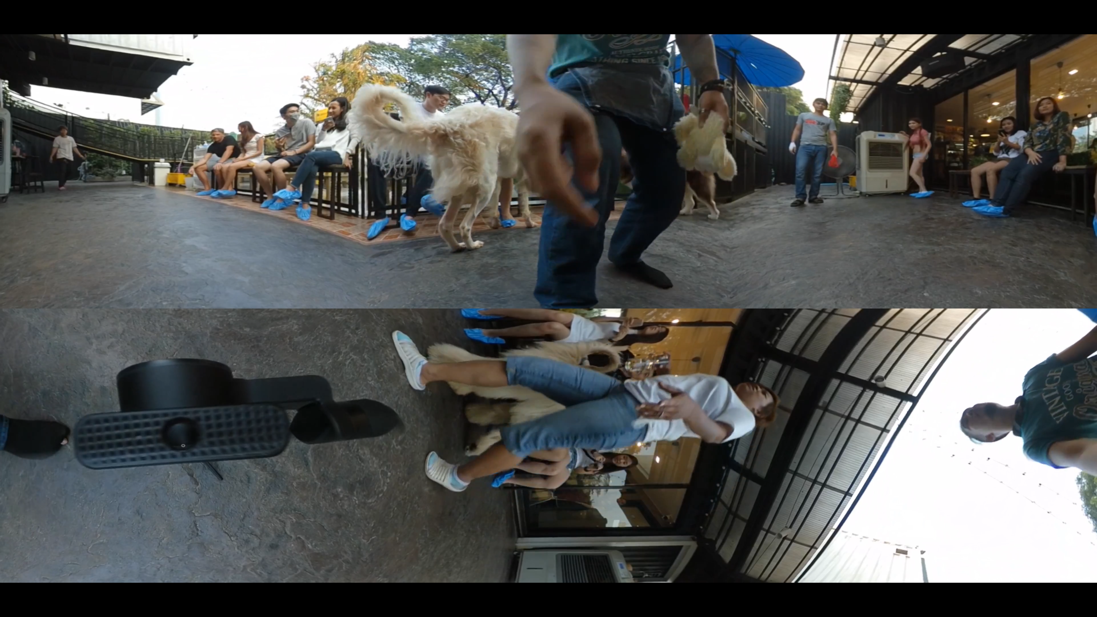

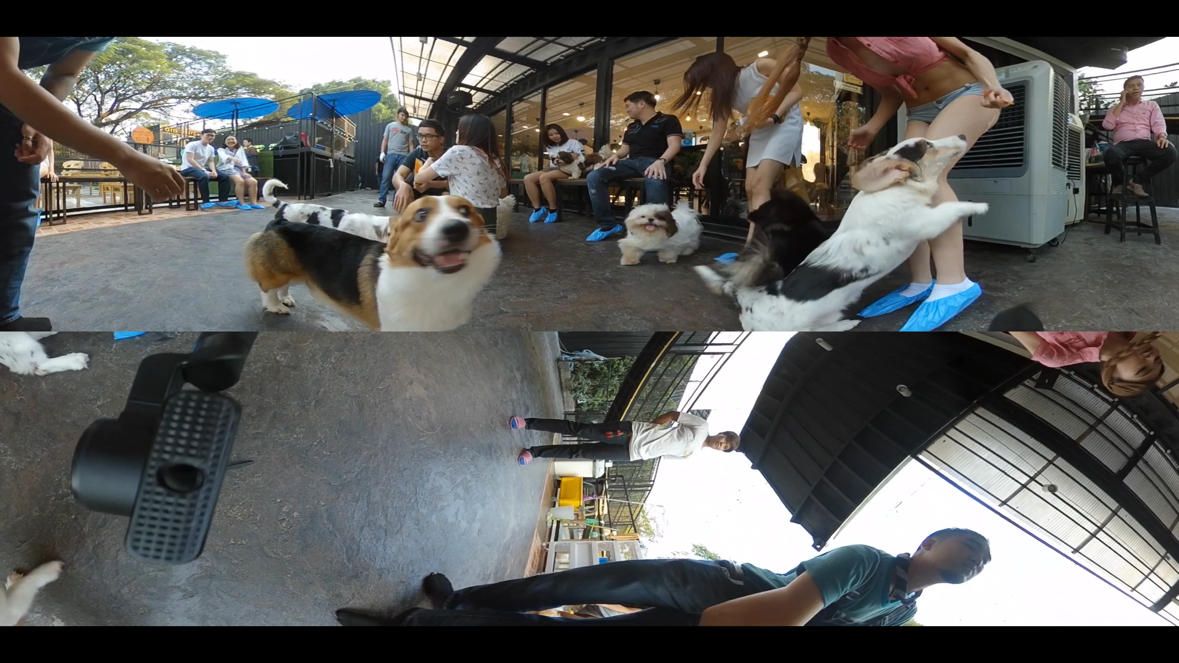

I have a few 360 degree videos I would like to convert to normal format. I believe they are 360 degree cubemap videos with six cubes, but I am not totally certain. I have included two screenshots from one of the videos at the bottom of this post. I have tried to find information about how to do this, and keep finding information about 360 degree formats that don't quite seem to match the videos I have. Do any of you recognize the type of 360 degree video shown, and know how to convert it to a normal flat format? I would be comfortable using tools on either Windows or Linux. (Linux is preferred, but I'll take what I can get)

Thank you for the reply, but that will only tell me the file format for the video and audio streams, which I know. I was more looking for the specific name of the 360 degree layout for these videos. I know they are monoscopic and equirectangular, possibly cubemap. But again, I am pretty new to 360 degree video, so I'm not really sure what the exact wording would be for these videos.
I did not make these videos, rather, they were downloaded from YouTube. However, I know some of them were originally made with a MADV Madventure 360 Camera while others were made with a Xiaomi Mi Sphere Camera. I will try searching for more info about these cameras to see if I can figure out the specific 360 degree format/layout they use.

What did you mean by "normal flat" format ? A 360 video only has limited FOV that you can use for a rectilinear or "normal flat" view . At any one time, you can only view a small part or reproject a small part of it.
This looks like a cubic 3x2 , but it's not the standard orientation
This looks like left, front, right, down, back, up , but the d,b,u faces look rotated
Various programs have algorithms for Facebook 3:2 (r,l,u,d,f,b) , Pano2VR 3:2 (l,f,r,b,u,d), Blender 3:2 (l,b,r,d,u,f) , but this is not a common orientation
If you crop the black borders, it's 3840x1920 2:1 AR , which is 6 * 1280x960 tiles
You could extract the faces, correct the orientation , then input them into some stitcher to get various standard projections.
This is what I needed to extract and rotate the faces correctly
cube faces
Once you have the cube faces, you can reproject into a standard equirectangular projection . I used a commercial tool here, but there are open source alternatives like hugin / panotoolsCode:c=ImageSource("Screenshot_2019-01-10_04-11-39.png").crop(0,120,0,-120,true) left = c.crop(0,0,-2560,-960,true) front = c.crop(1280,0,-1280,-960,true) right = c.crop(2560,0,0,-960,true) down = c.crop(0,960,-2560,0,true).turnright().spline36resize(1280,960) back = c.crop(1280,960,-1280,0,true).turnleft().spline36resize(1280,960) up = c.crop(2560,960,0,0,true).turnright().spline36resize(1280,960)
