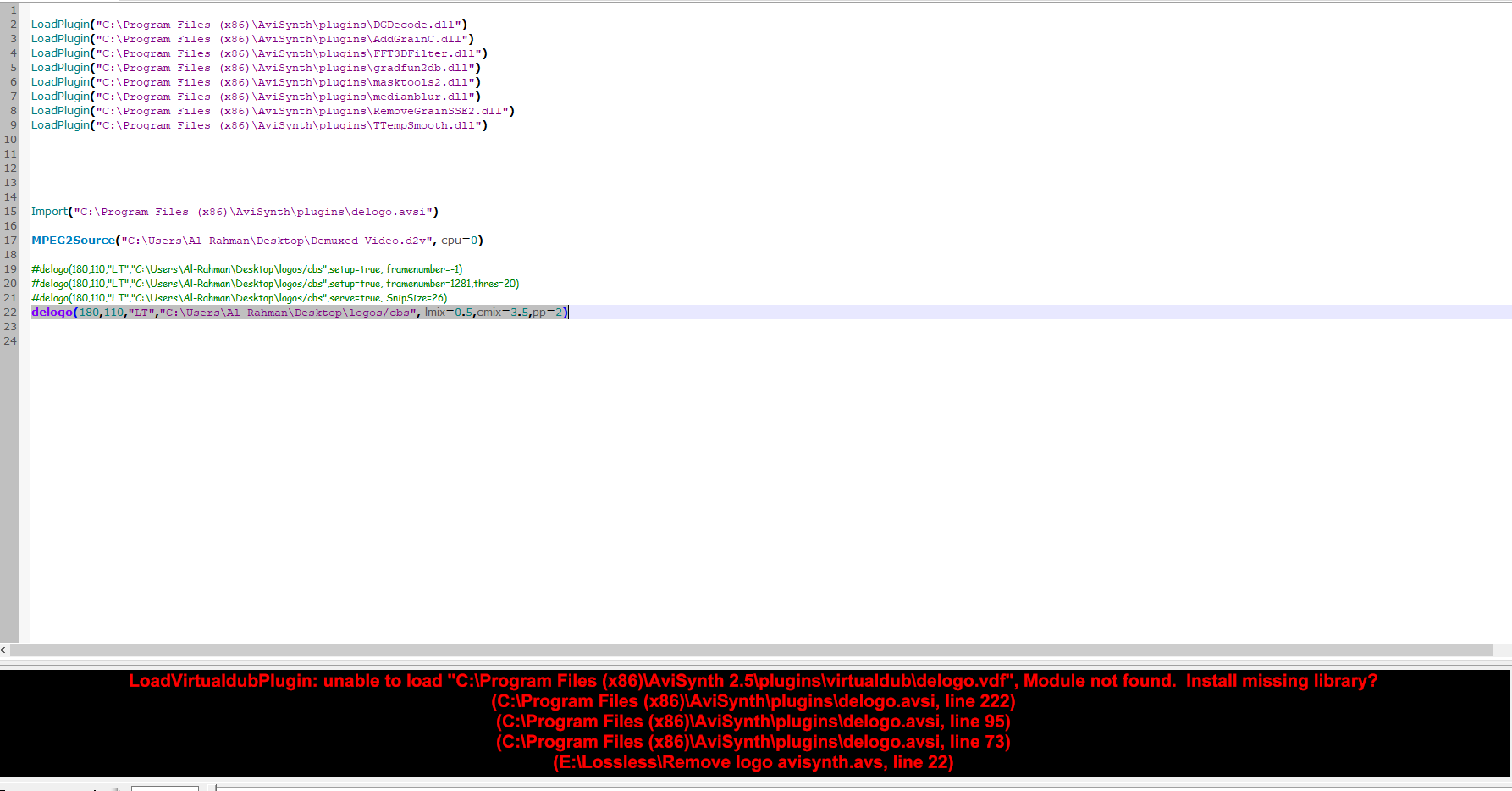

    Hello!
    I'm trying to remove a transparent logo using virtualdub plugin "delogo.vdf" and avisynth delogo avs script but it giving me error in the final script:
    HTML Code:
    delogo(180,110,"LT","C:\Users\Al-Rahman\Desktop\logos/cbs", lmix=0.5,cmix=3.5,pp=2)
    HTML Code:
    LoadPlugin("C:\Program Files (x86)\AviSynth\plugins\[url=https://www.videohelp.com/software/DGMPGDec]DGDecode[/url].dll")
    LoadPlugin("C:\Program Files (x86)\AviSynth\plugins\AddGrainC.dll")
    LoadPlugin("C:\Program Files (x86)\AviSynth\plugins\FFT3DFilter.dll")
    LoadPlugin("C:\Program Files (x86)\AviSynth\plugins\gradfun2db.dll")
    LoadPlugin("C:\Program Files (x86)\AviSynth\plugins\masktools2.dll")
    LoadPlugin("C:\Program Files (x86)\AviSynth\plugins\medianblur.dll")
    LoadPlugin("C:\Program Files (x86)\AviSynth\plugins\RemoveGrainSSE2.dll")
    LoadPlugin("C:\Program Files (x86)\AviSynth\plugins\TTempSmooth.dll")
    Import("C:\Program Files (x86)\AviSynth\plugins\delogo.avsi")
    MPEG2Source("C:\Users\Al-Rahman\Desktop\Demuxed Video.d2v", cpu=0)
    #delogo(180,110,"LT","C:\Users\Al-Rahman\Desktop\logos/cbs",setup=true, framenumber=-1)
    #delogo(180,110,"LT","C:\Users\Al-Rahman\Desktop\logos/cbs",setup=true, framenumber=1281,thres=20)
    #delogo(180,110,"LT","C:\Users\Al-Rahman\Desktop\logos/cbs",serve=true, SnipSize=26)
    Thanks in advance!
Name:	Error Screen.PNG

  5. You have the delogo plugin in:
    C:\Program files (x86)\AviSynth\plugins\virtualdub\delogo.vdf
    But the AviSynth is looking for it in:
    C:\Program files (x86)\AviSynth 2.5\plugins\virtualdub\delogo.vdf
    I suspect delogo.avsi is where the problem is. Edit that file and change the path.
    I did so, unfortunately the same error
