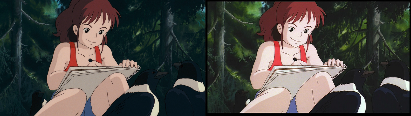

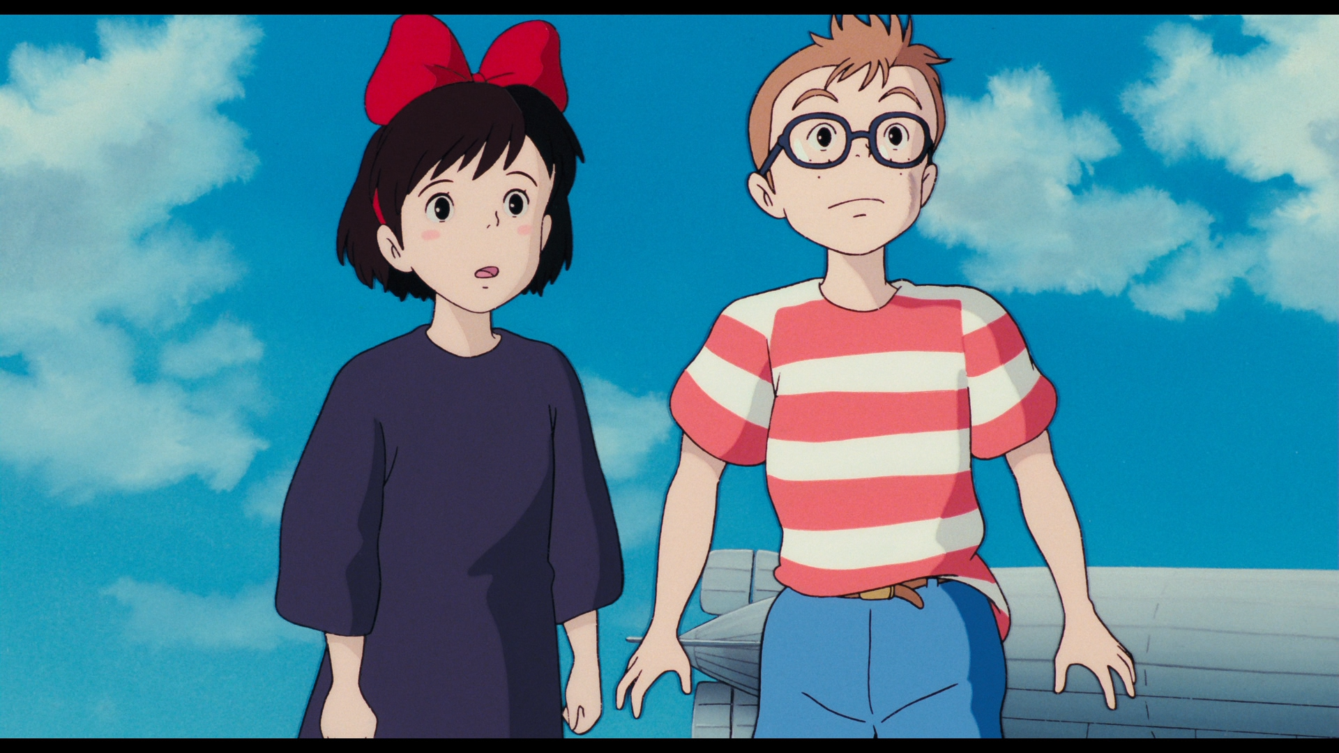

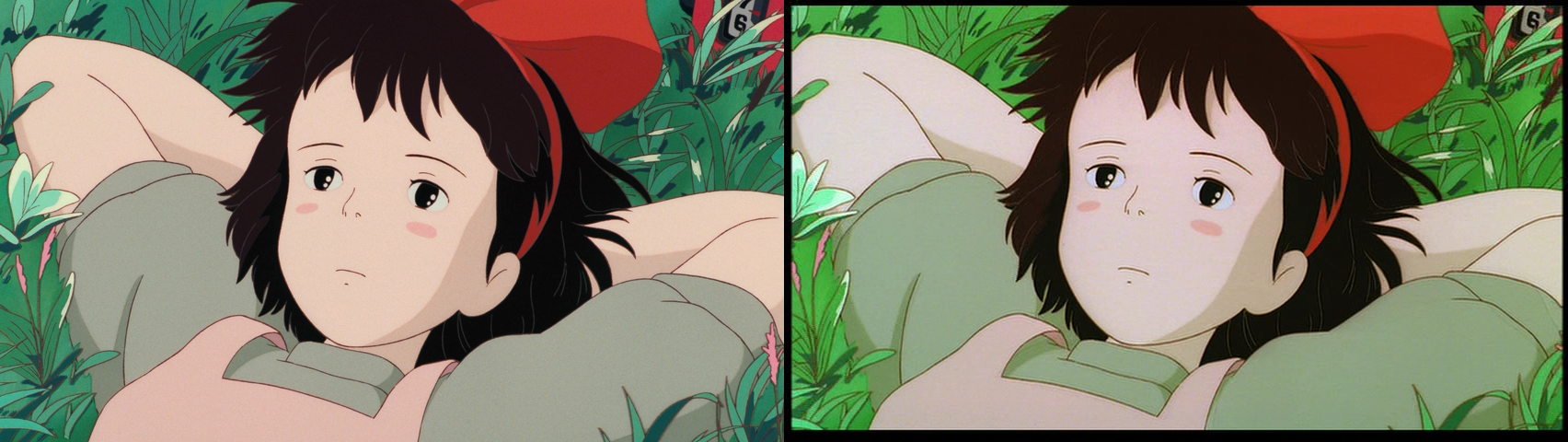

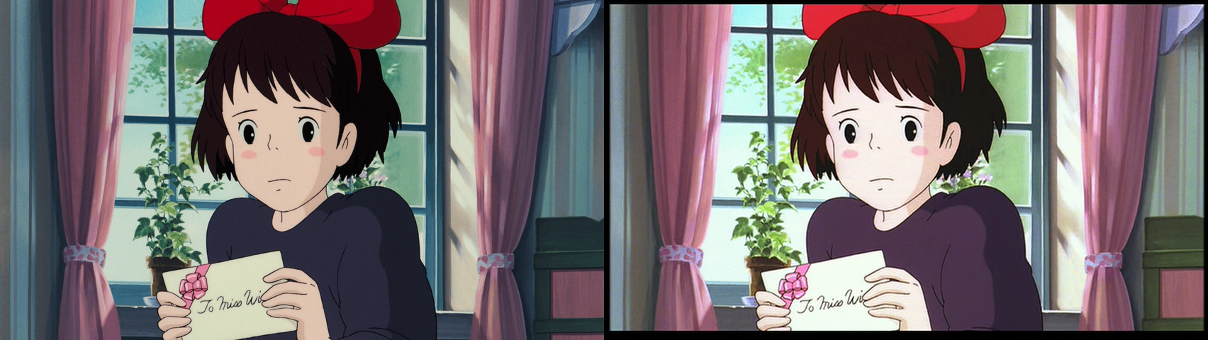

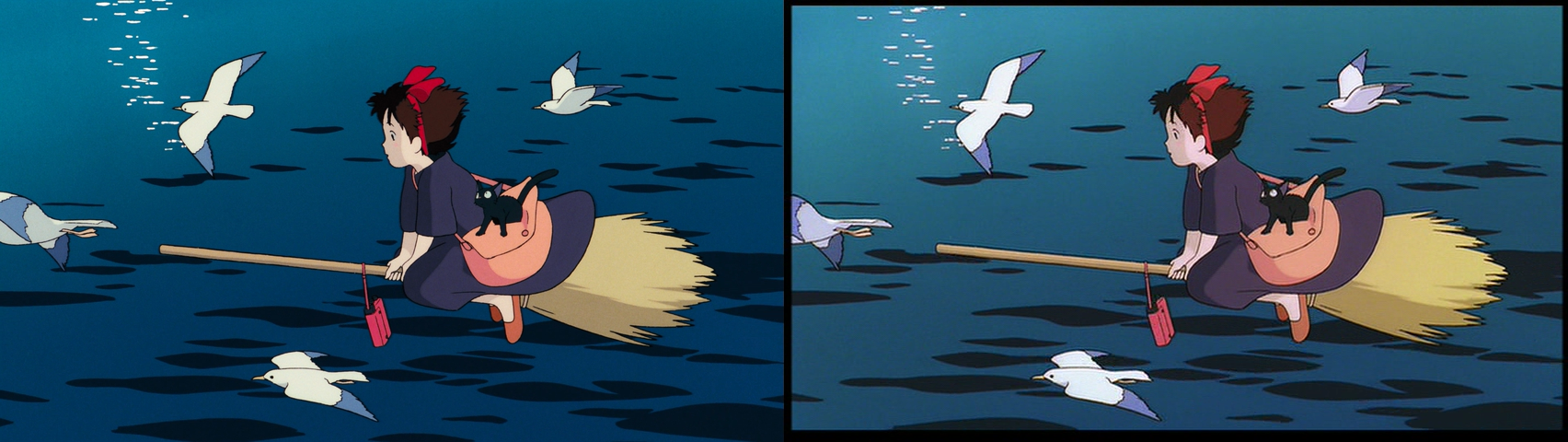

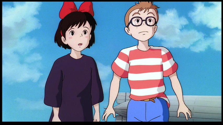

The remastering of this Blu-Ray seems to have changed it's look pretty drastically to me when compared to the DVD version. One thing in particular being all the solid bright white appears gone and or turned more yellow or grayish. Most visible to me in eye color.
Can I get the whites to look brighter white again or has it been altered too much for the new source?
DVD
Blu-Ray
Blu-Ray (1920x1080)

White balance and gain, something like:
Code:darks = ColorYUV(off_u=-2, off_v=1) brights = ColorYUV(gain_y=25, off_u=7, off_v=1) bmask = ColorYUV(gain_y=90, off_y=-35) Overlay(darks, brights, mask=bmask)
[Attachment 47764 - Click to enlarge] -
Wow that actually looks pretty decent for that one image.
Does the overall video of the Blu-Ray look too dark to you? I think it kind of looks too dark. -
By dark, what do you mean? Do you mean the blacks are crushed or highlights are dark? I don't think it looks too dark. Have you tried viewing the images on another monitor/tv/phone? It could be your monitor not outputting it 1:1. A good test would be on Lagom and seeing if your contrast and gamma are correct. Are you able to see two different colors on the girl's hair in the first and second screenshot?
The color does look a bit tinted yellow and the highlights are not as bright as they could be. autolevels should work I think on scene changes. You could also try to get Gray_Balance to work and if all of the shots are tinted the same it would fix the color. I get an error though when running the script saying "SmoothCustom does not have a named argument "smooth"" which could need an older version. -
Certainly, the BD's peak brightness is lower on the sample images. And its whites are slightly yellowed. But maybe that's closer to the film source?
My $0.02, maybe it's just my eyes getting older, but the brighter image hurts my eyes and looks unrealistic (ironic for an anime) to me. Especially in the images with the bookshelves and the trees in the background which takes my focus away from the main character.
Also as jagabo stated, the darker image may be the creator's intent. I have both my primary and secondary TV tweaked for a pitch black room and when I'm fiddling with something in the room with the lights on, the picture looks dull and washed out, but when I turn off the lights, I can see it as it's meant to be seen. -
