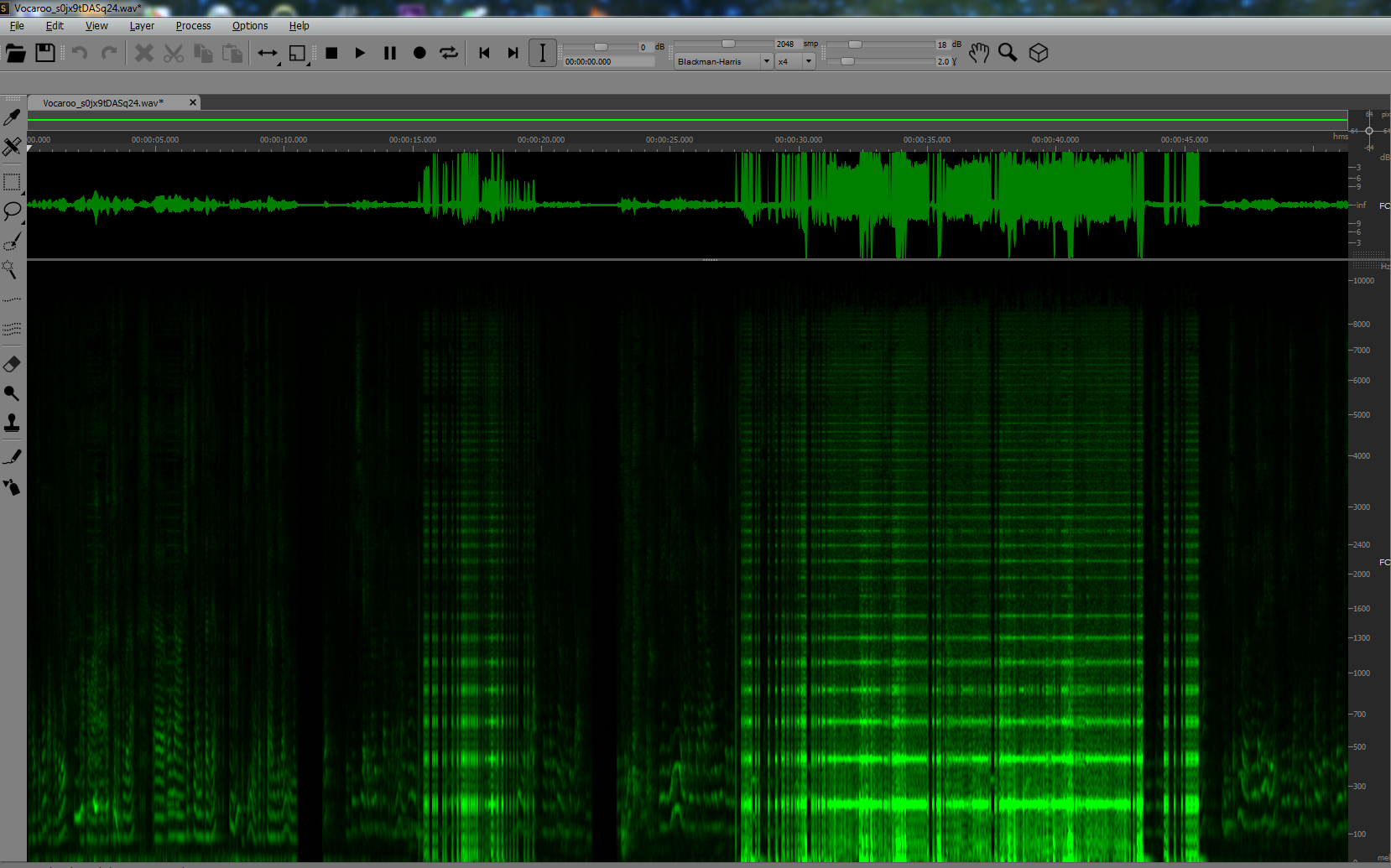

    it's in the audible spectrum. maybe a fax machine neary?
    [Attachment 47735 - Click to enlarge]

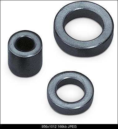

  8. Take a large ferrite ring (those designed for common mode) Click image for larger version

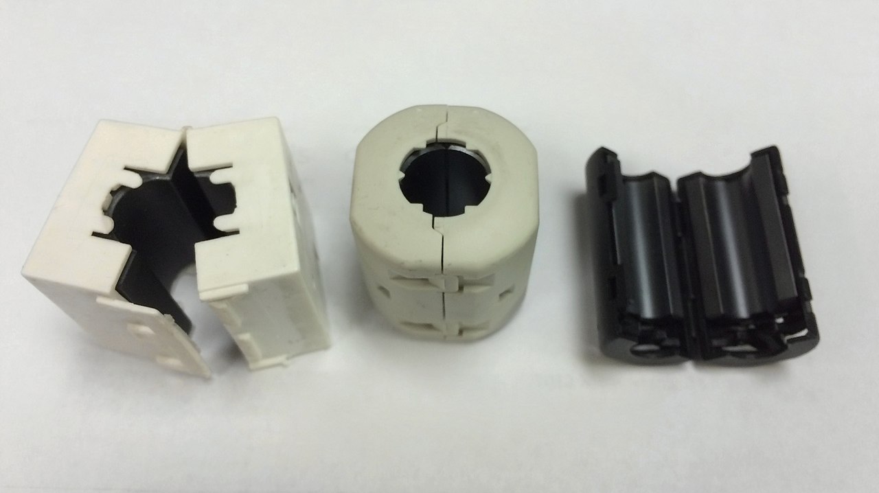

ID:	47740 and pass trough it mic wire few times (wound simple coil), you can also try to use few ferrite beads like this
ID:	47739, ferrite beads or ferrite ring core should be located close to input on your recording devices as possible.

    Using those snap-on ferrite beads will not hurt anything and you will be impressed how "magically" such small thing may improve situation - you can search somewhere in your old cables - perhaps there is somewhere such ferrite.
