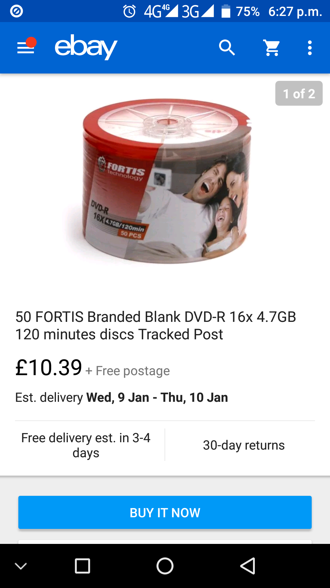

    Sep 2008
    [Attachment 47736 - Click to enlarge]
    Are these discs any good, please see attached.

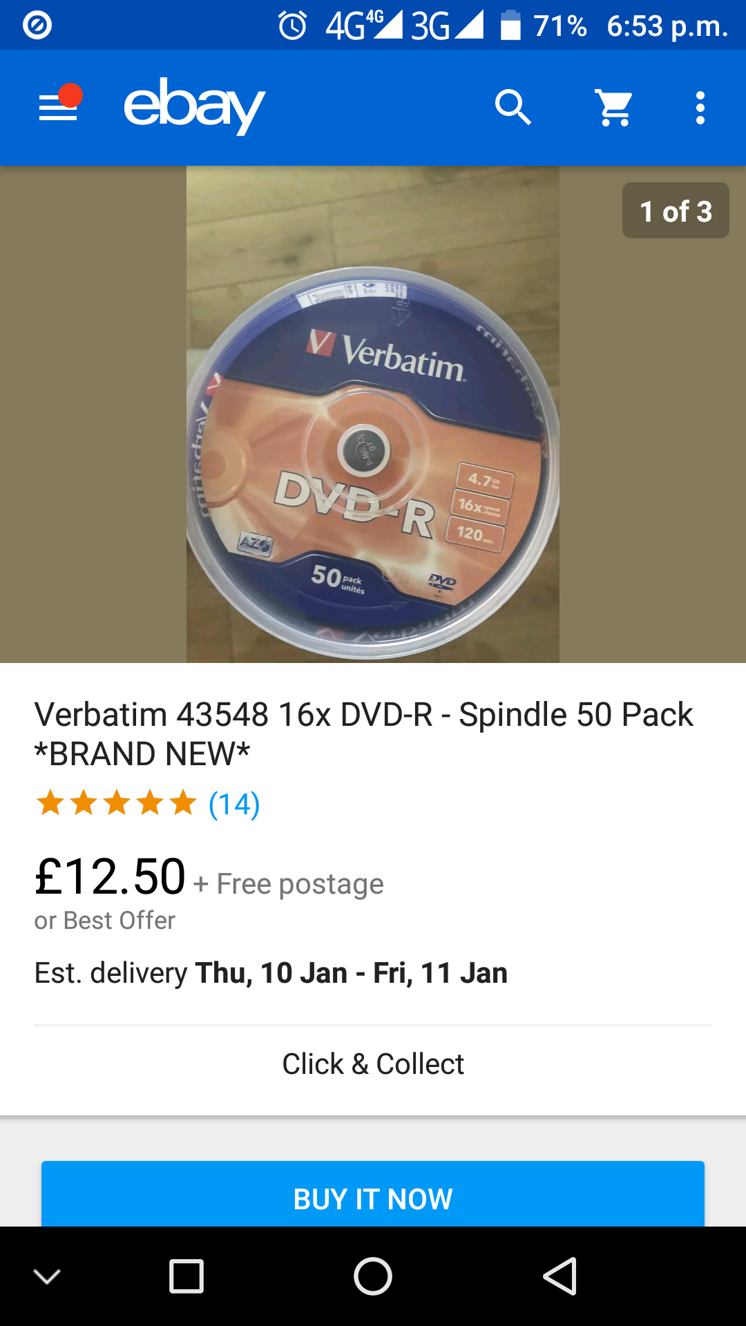

  15. Member DB83's Avatar
    Jul 2007
    IMHO = In My Honest Opinion
    And IMHO these are unknown, probably rebranded, rubbish.
    Look for Verbatim AZO
    https://www.ebay.co.uk/sch/i.html?_from=R40&_trksid=p2380057.m570.l1313.TR7.TRC1.A0.H0...dvd-r&_sacat=0
    Jul 2007
    +1
    The only proven quality DVD blanks are Verbatim AZO and Taiyo Yuden, both available from Amazon. Read here to be sure you're getting real AZO Verbatims. https://forum.videohelp.com/threads/391271-Best-CD-and-DVD-media
    Also, explain exactly what you're trying to accomplish.
    If you're trying to convert and burn .mp3 to a CD compatible disc (i.e. not just .mp3 as data on a disc), you're limited by time ~70 minutes max on CD as the files must be converted from .mp3 to .wav as Hech54 stated.
    Same with converting an .avi to a Video DVD format. You're limited to ~2 hours max.
    Also, have you tried using Imgburn as suggested? Nero is not recommended by any regulars here because of numerous issues reported.

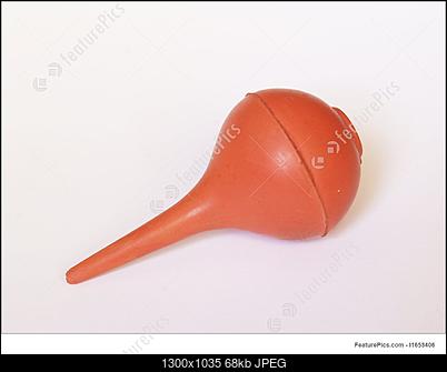

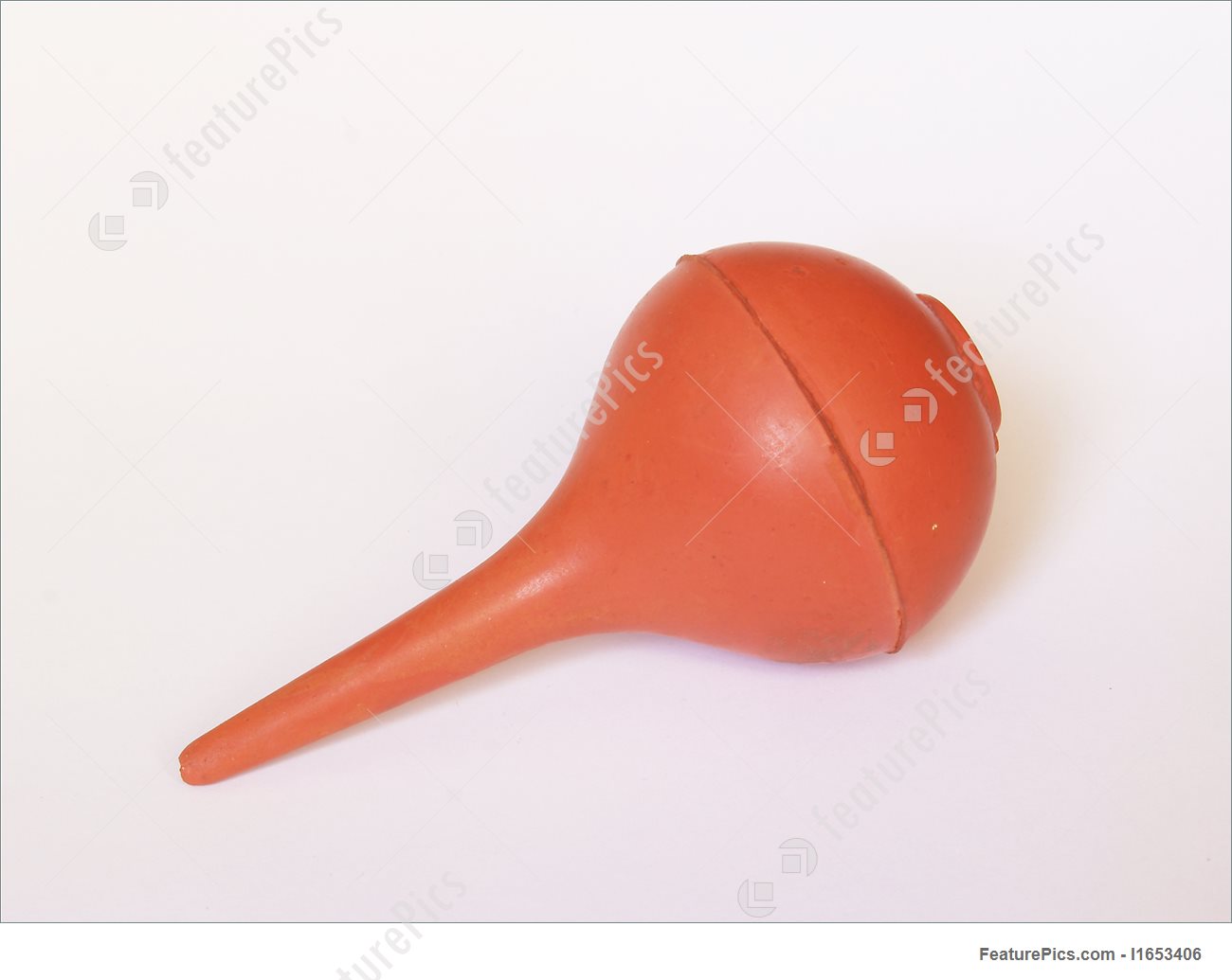

  23. Originally Posted by alih786 View Post
    No. It is cheaper to buy cheaper disc and an expensive writer. However for best results its best to get the best of both.
    Cheaper discs are usually worse quality and audio CD have almost no ECC (Error Correction Code) that's why years ago all discs was tested for C2/C1 and other errors. Idea is to not only write but also read without excessive number of errors after some time.
    I would perform gentle writer cleaning, remove dust, you can try blow away dust from lens with help of Click image for larger version
ID:	47741 - fine dust is enemy of optic - especially smoking persons suffer from such issues with optics. Don't use compressed air canister especially direct stream on lens area - it may rupture coils holding lens.

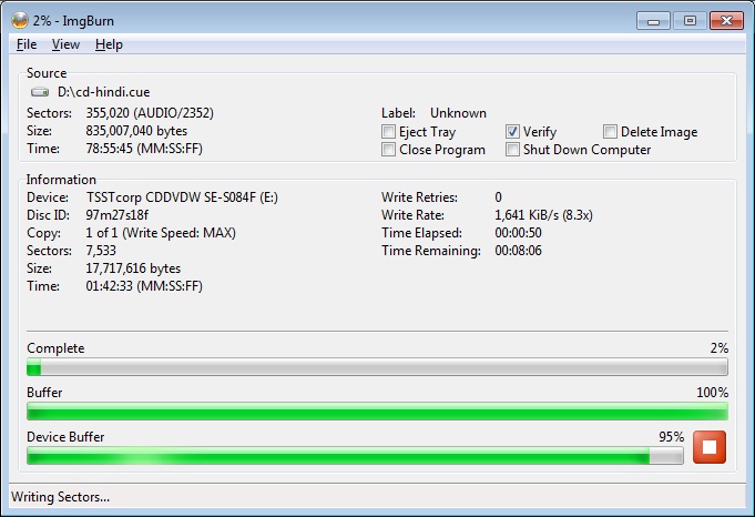

    Well now this is a surprise. I used imgburn software. It took awhile to burn though.

  26. Member DB83's Avatar
    Jul 2007
    Is this a CD ?
    Imgburn shows it writing at 8x. Most CDs these days will be at least 24x or even faster. 8x is for dvd. No wonder the burn is slow. Check the imgburn settings but if it does not recognise this media it may default to a slow speed.
  27. Member
    Jul 2007
    It looks like the CDs are 800MB [Edit: Should be 900MB / 99 minutes* which are known to be bad because they're well of out of the 700MB / 80 minutes specs of regular CDs. This is likely your problem. AFAIK, Nero won't allow Overburn, with a max 700MB / 80 minutes per disc, but Imgburn will. Many CD players won't recognize or play anything larger than 700MB or 80 minutes.
    Try burning a max of 700MB / 74 minutes and see if that works. However, even if it does, use the remaining discs only for things you don't care about, as I've said, 800MB [Edit: Should be 900MB] / 99 minute discs are known to be bad quality as they're manufactured well outside of regular CD specs.
    * I couldn't figure out how the report showed 835,007,040 bytes and 78:55:44 time which is impossible to burn (or at least highly unlikely) for a regular 700MB / 74 minute disc. Then I noticed the Disc ID: 97m27s18f which indicates a 99 minute disc.
    Edit: This is probably why Imgburn defaulted to 8X, since these are out of spec discs.
  28. Member
    Sep 2008
    Originally Posted by lingyi View Post
    It looks like the CDs are 800MB / 99 minutes* which are known to be bad because they're well of out of the 700MB / 80 minutes specs of regular CDs. This is likely your problem. AFAIK, Nero won't allow Overburn, with a max 700MB / 80 minutes per disc, but Imgburn will. Many CD players won't recognize or play anything larger than 700MB or 80 minutes.
    Try burning a max of 700MB / 74 minutes and see if that works. However, even if it does, use the remaining discs only for things you don't care about, as I've said, 800MB / 99 minute discs are known to be bad quality as they're manufactured well outside of regular CD specs.
    Friend you are mistaken. These are 80min discs. Ive never seen a CD below 80mins/700MB. My total time is within the 80mins, 78mins it is. Look on screenshot.
  29. Member
    Jul 2007
    Also, while Imgburn allows overburning (i.e. a minute or two over the max 80 minutes), don't do it. Just as with DVDs should never be burned to their full capacity or beyond. The reason is, optical discs are burned from the inside out with the overburned data on the outer edge of the disc which may not be as evenly coated or damaged, especially on CDs. Some reader mechanisms, especially on CD readers have a mechanical limit on how close to the edge they can move/read. This is especially true with cheap CD players which are built to the original CD specs, 650MB / 74 minutes.
    Bottom line, never burn to more than 650 MB / 74 minutes on a CD, 4 GB on a DVD, video or data.
    Note that unlike a Video DVD, where the video data type Mpeg-1 or Mpeg-2 and size can vary, CD audio is limited to 44.1 KHZ 16 bit stereo. If you use each channel separately as mono, you can double to the playing time as Techmoan demonstrates here: https://www.youtube.com/watch?v=5fG1crhGqI0
  30. Member
    Jul 2007
    650MB / 60 minute CDRs are the original Redbook standard and are still available. It's just that the 80 min/700MB discs are more common. There are also 74 min/700MB discs which came out before the larger size.
    As I stated above, you're probably too close to the max capacity of the disc. Reduce your time to less than 74 minutes and try again.
    Also, the ID seems to indicate it's a 99min blank. I don't have any blank or burned CDs to test, but I don't believe it makes sense if it's a 80 min blank. Run CDR Identifier and post the results.
