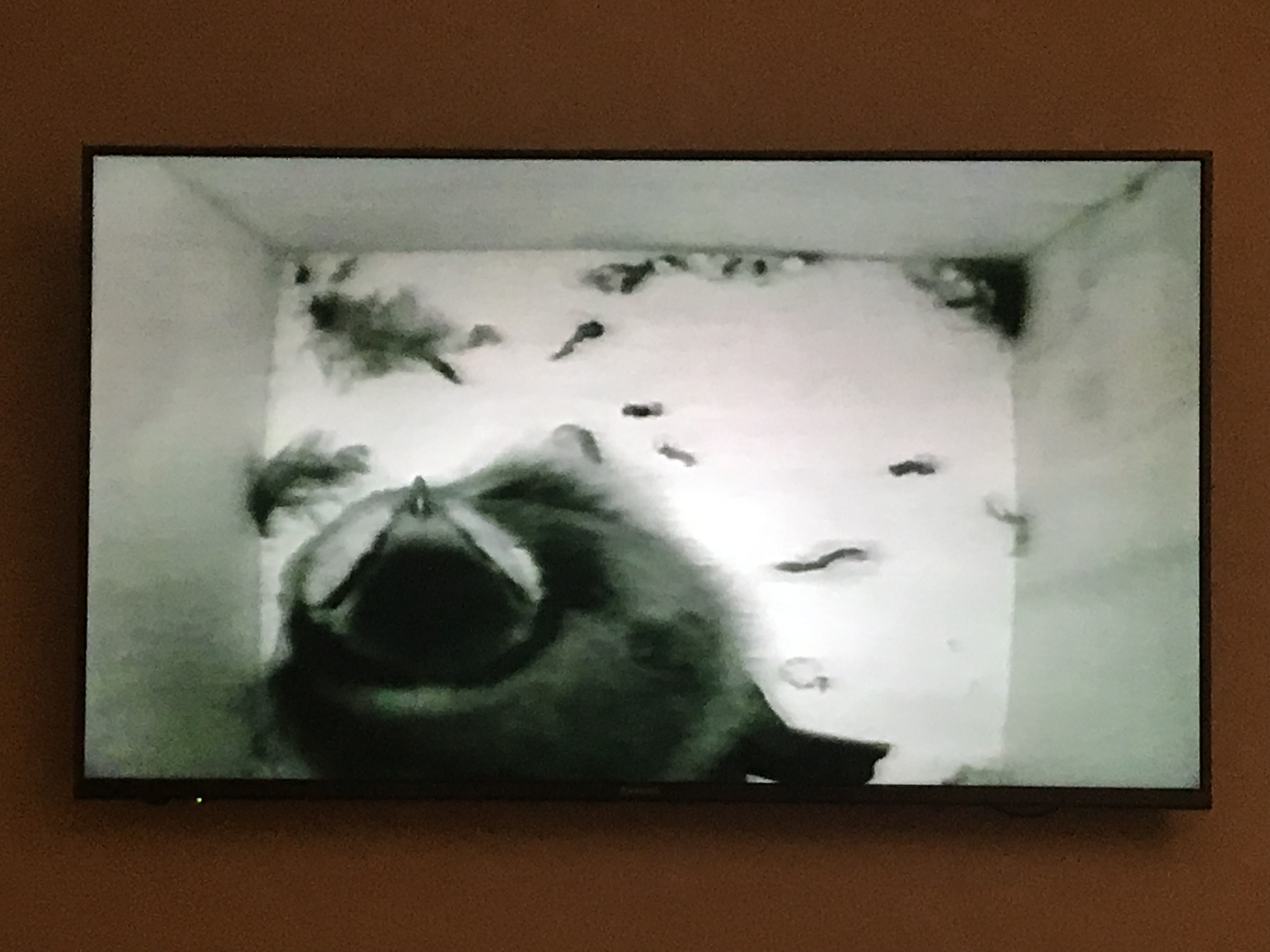

    Raspberry PI, never heard of this. Images are in 720 definition. Your idea sounds more cost effective. You’re sure it will be up to it?
    I suspected this - judging from provided picture this is Standard Definition upscaled trough HDMI converter (SCART to HDMI) to 720p resolution.
