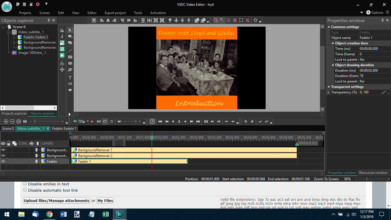

    Thanks guys. I'm going to try creating an animated text-only video and add that to the scene after resizing. Hold good thoughts for me

    What I did was highlight the text layer and tried the page turn transition. It seemed to work when I ran the text layer only. But when I went back to run the entire scene, it page turned the entire background with the text.
    I confirmed that the page-turn connected to the text in the Object explorer, not the background image.
    So I went back, deleted the text layer. Made a video, loaded it as a subtitle, edited for transparency and moved it to the bottom of the scene. I then added a fade in and it works. But this seems really the hard way to do it. Here's a screen shot of the editorImage
    [Attachment 47711 - Click to enlarge]
