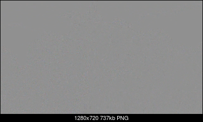

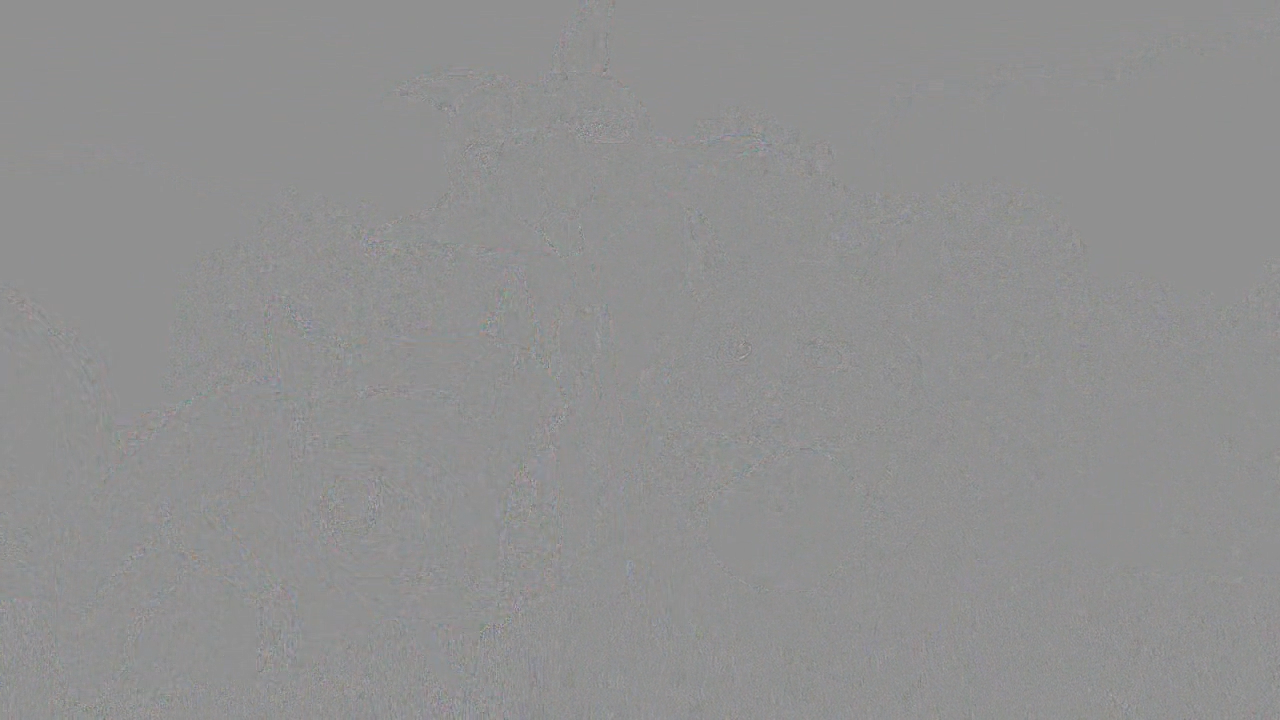

  11. btw. using:
    t1 = LWLibavVideoSource("C:\Users\Selur\Desktop\S02-E01 - The North Remembers T1.mkv",cache=false,stacked=true,format="YUV420P8",repeat=true)
    t32 = LWLibavVideoSource("C:\Users\Selur\Desktop\S02-E01 - The North Remembers T32.mkv",cache=false,stacked=true,format="YUV420P8",repeat=true)
    #i = StackHorizontal(t1,t32)
    Subtract(t1,t32).Levels(127, 1, 129, 0, 255)
    I see tons of differences,... this much should be noticeable in PSNR.
    Looking at:
    File: S02-E01 - The North Remembers T1.mkv
    File: S02-E01 - The North Remembers T32.mkv
    btw. the source has 2875 and T1 has 2874 and T32 has 2874 frames,....
    In case you sure you just changed the thread value and nothing more and this is worrisome.

    v1 = FFVideoSource("J:\My Videos - Originals - TV\S02-E01 - The North Remembers T1.mkv", cache=false).trim(frameadjust, 0)
    v2 = FFVideoSource("J:\My Videos - Originals - TV\S02-E01 - The North Remembers T32.mkv", cache=false)
    sub = v1.subtract(v2)
    substrong = sub.levels(112, 1.000, 144, 0, 255)
    StackVertical(StackHorizontal(v1.subtitle(name1), v2.subtitle(name2)), StackHorizontal(sub.subtitle("Difference"), substrong.subtitle("Difference amplified 8x")))
    I agree that there are some differences between the clips, but then again, you're looking at 1 thread vs. 32 threads. 1 thread took 1:22:51 (h:mm:ss) to transcode while the 32 thread transcode took only 0:04:56 (h:mm:ss).

    Tested out turning ASM on and off, and it turns out they are not bit identical. I used the 3 minute, mp4, 30MB, 1280x720 source and encoded it twice with x264. Once with ASM enabled (using MMX2 SSE2Fast SSSE3 SSE4.2 AVX XOP FMA3 BMI1) and another with ASM completely disabled. All other settings were the same (x264 very slow). Then I took these two encodings and converted them to Uncompressed YUV 420, and compared the CRC32 hashes of them. They had different hashes. There was also a 100 byte difference between the two x264 encodings, which I originally thought could just be metadata differences but now I think it's actual video data differences.
    When actually doing Subtract in avisynth, the differences are more than minor. With massive differences in certain situations, mostly motion. I can only imagine the ASM disable has better quality but I have not gone that far. So it's obviously more than a few random differences but noticeably different, visually. Example of the subtraction.
Name:	SampleVideo-ASM Subtract.png
    LoadPlugin("C:\...\avss.dll")
    A=dss2("C:\....\SampleVideo-ASM.mkv", fps=25.000).AssumeFPS(25,1)
    B=dss2("C:\....\SampleVideo-NO-ASM.mkv", fps=25.000).AssumeFPS(25,1)
    Subtract(A,B).tweak(cont=1.4,bright=-30)

    btw. using:

  28. Originally Posted by ziggy1971 View Post
    @poisondeathray
    Did you have a chance to look at the clips I uploaded that were encoded using a different number of threads? Selur said he saw "I see tons of differences...", but didn't elaborate on his findings or follow up with some reviews on clips using less threads.
    The reason is because the frames were not aligned (different framecount, not comparing the same frames) , and the method he was using - there will be large differences. Same with metrics like PSNR, SSIM, etc... if you are n+/-1 , they will say massive differences. Even if you shift the pixels , say 1 to the right, it will say massive differences, when the picture is identical otherwise.
    If you aligned them up , you would expect only very minor differences at that bitrate with those samples when changing --threads (this is even with metrics, or difference testing) . Whereas if you picked section with more action , you'd expect slightly more differences at that bitrate range.
